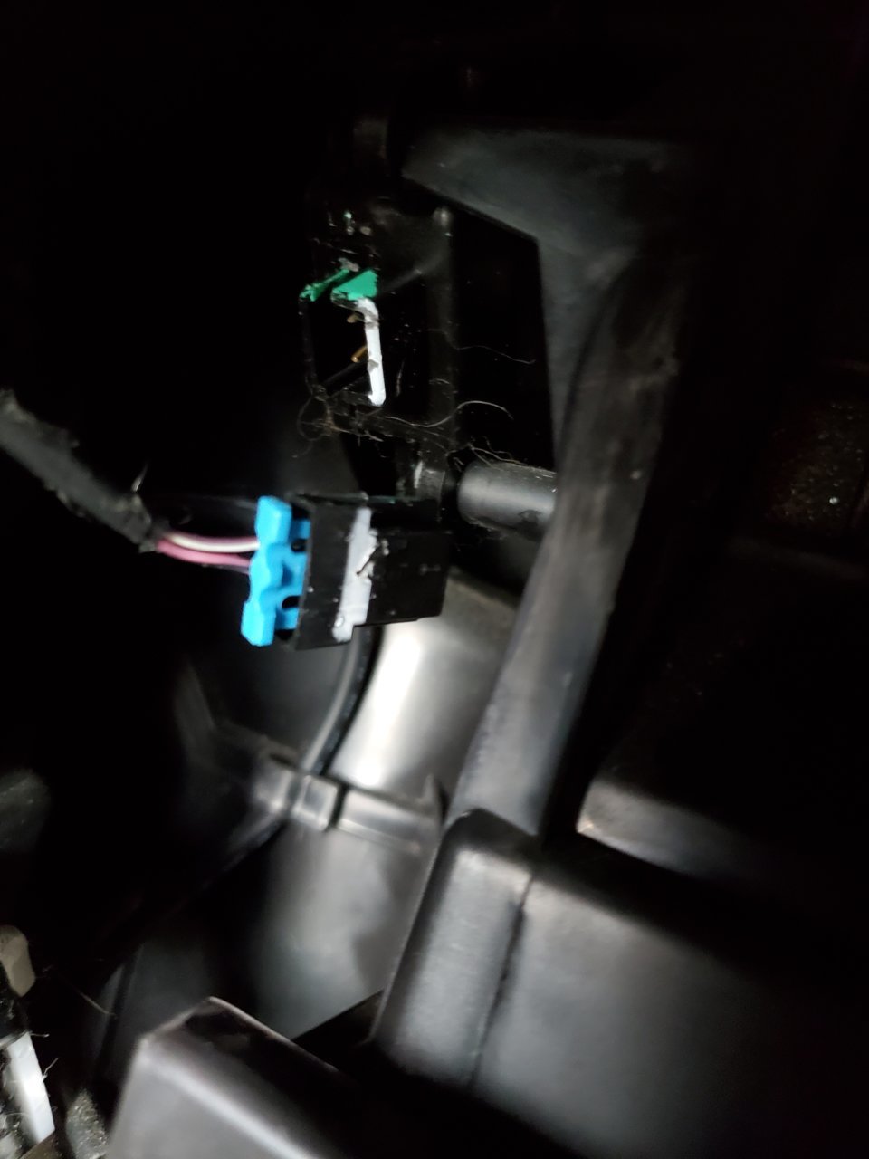

    I unplugged this connector, which is above the left corner of the cabin filter box, and the commotion stopped. This requires a small straight screwdriver to work under the retaining clip on the far side of the connector.

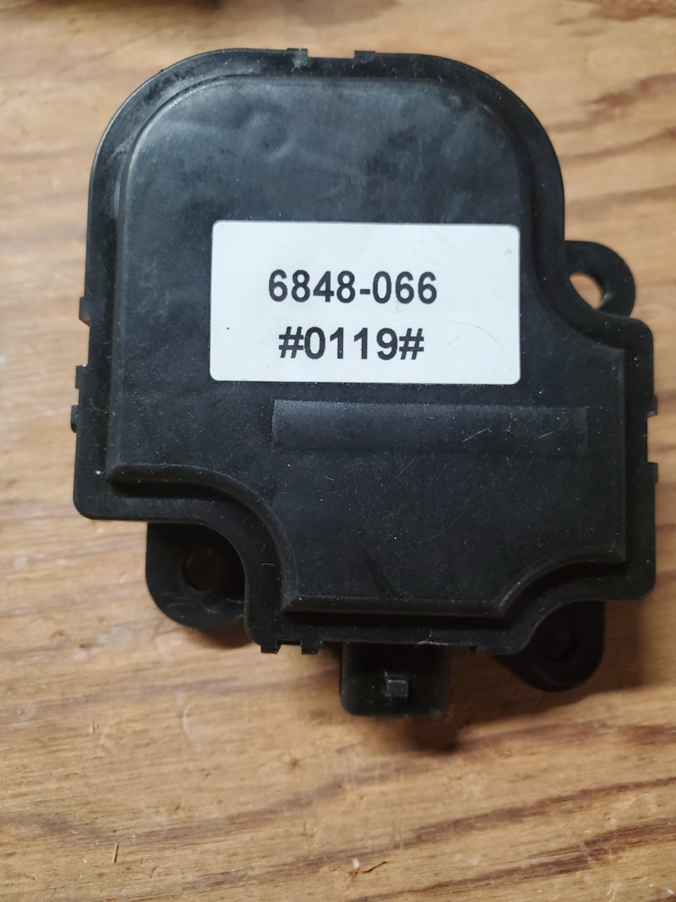

    The 2 screws were removed using a 7/32 socket (for 1/4" ratchet) on a short extension. I was able to remove using 2 fingers turning the extension. Then pull up off the plastic retainer post.
    The plug is 2-pin, while other Toyota models use a 5-pin connector.
    The Autozone part description and part number:
    2011 Toyota Tacoma A/C Heater Blend Door Actuator
    Santech A/C Heater Blend Door Actuator
    PN: MT18634

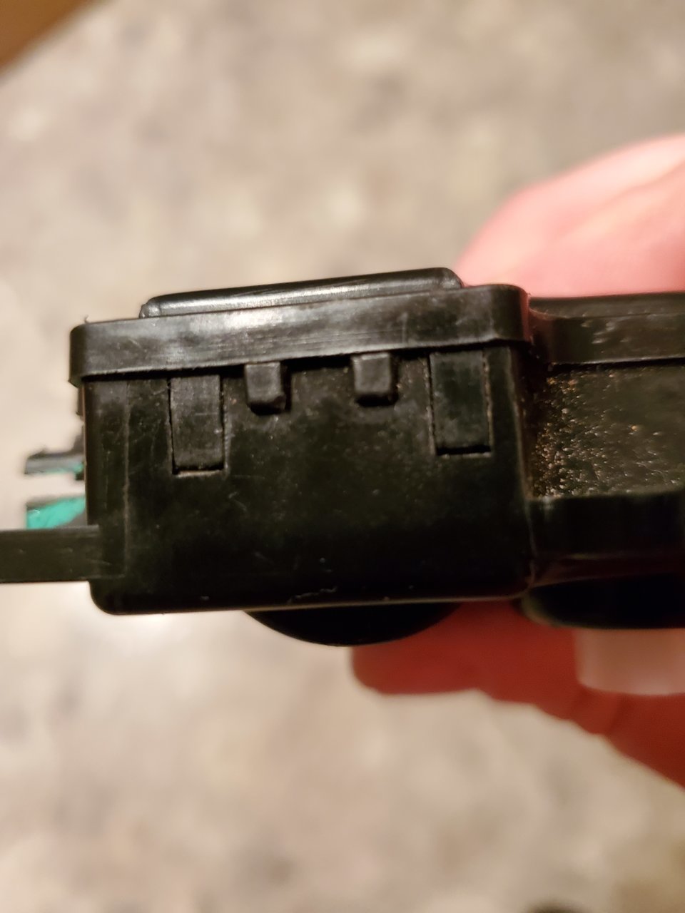

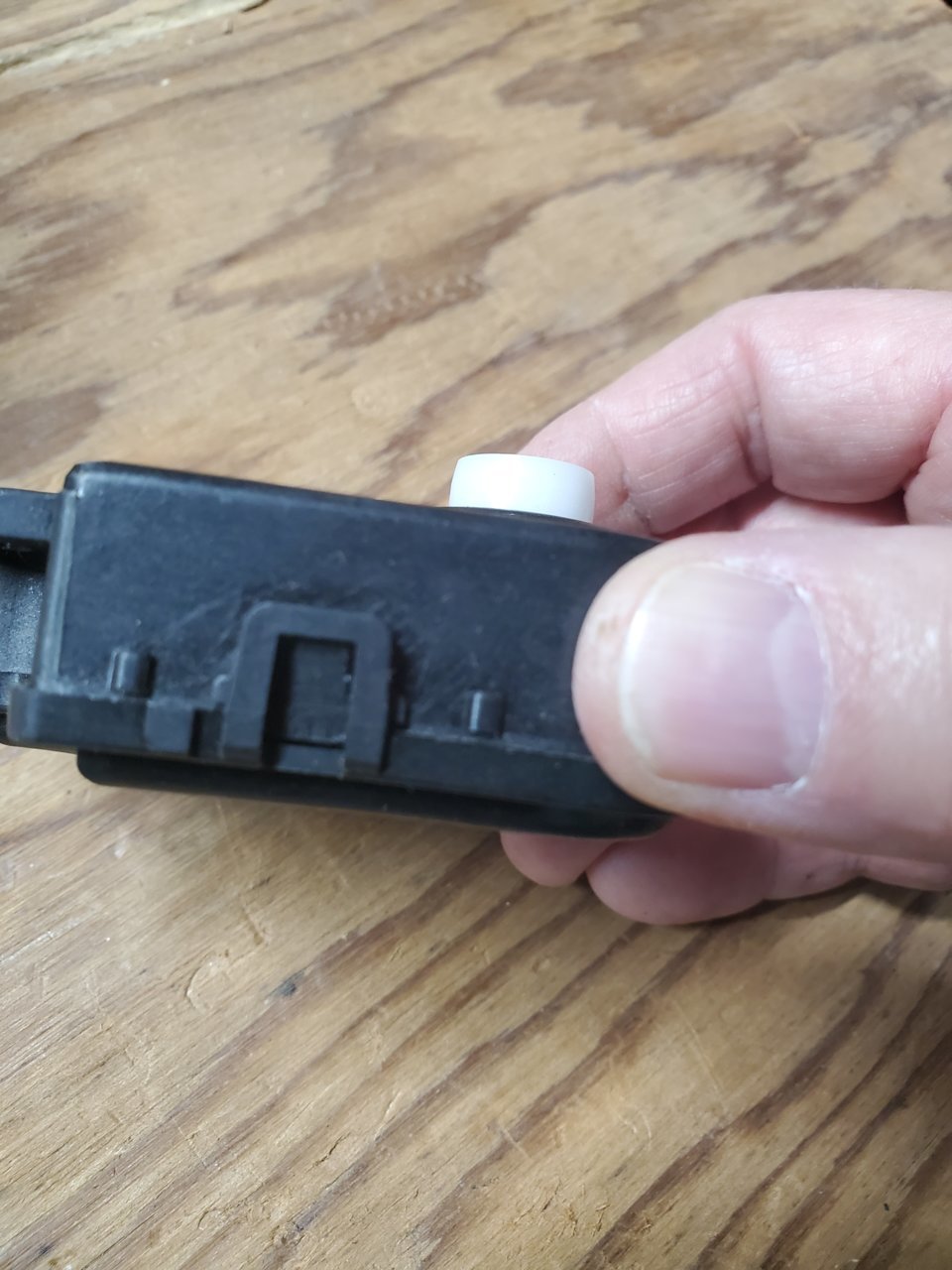

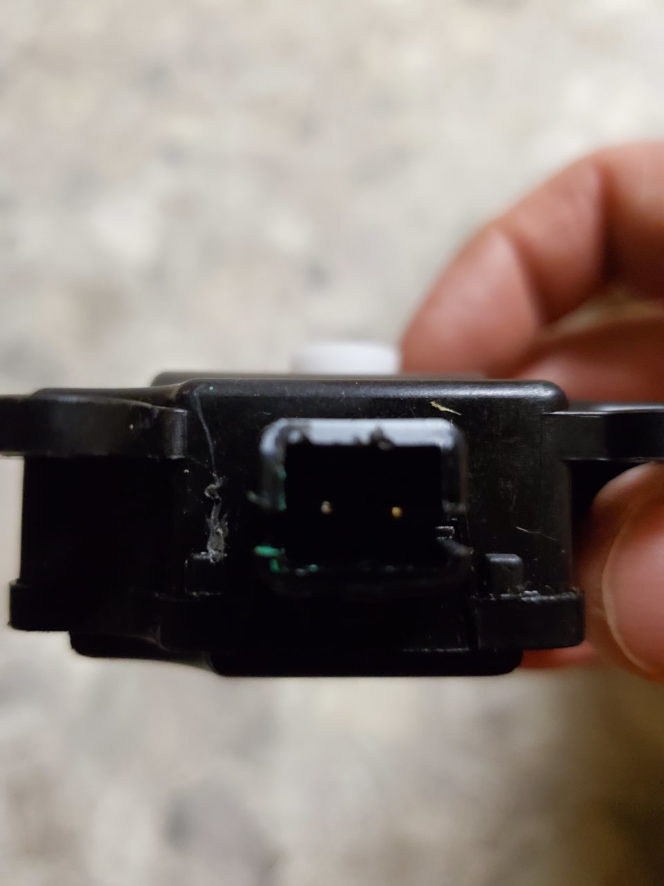

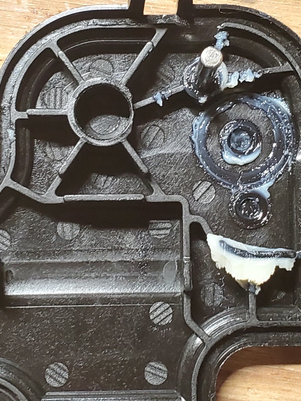

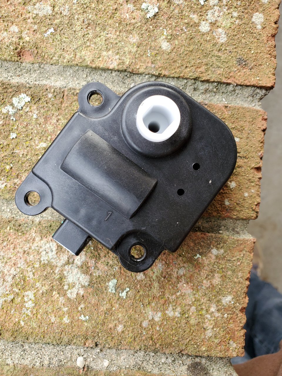

    Here is the 2nd new actuator, along wuth pics of the inners of the Santech. I rotated 2 of those gears 180°, in case the Dorman
    goes south.
    Install and cleanup took me 30 minutes.
    There are 3 tabs this size. The 4th tab is smaller, on the side with the wiring connector.

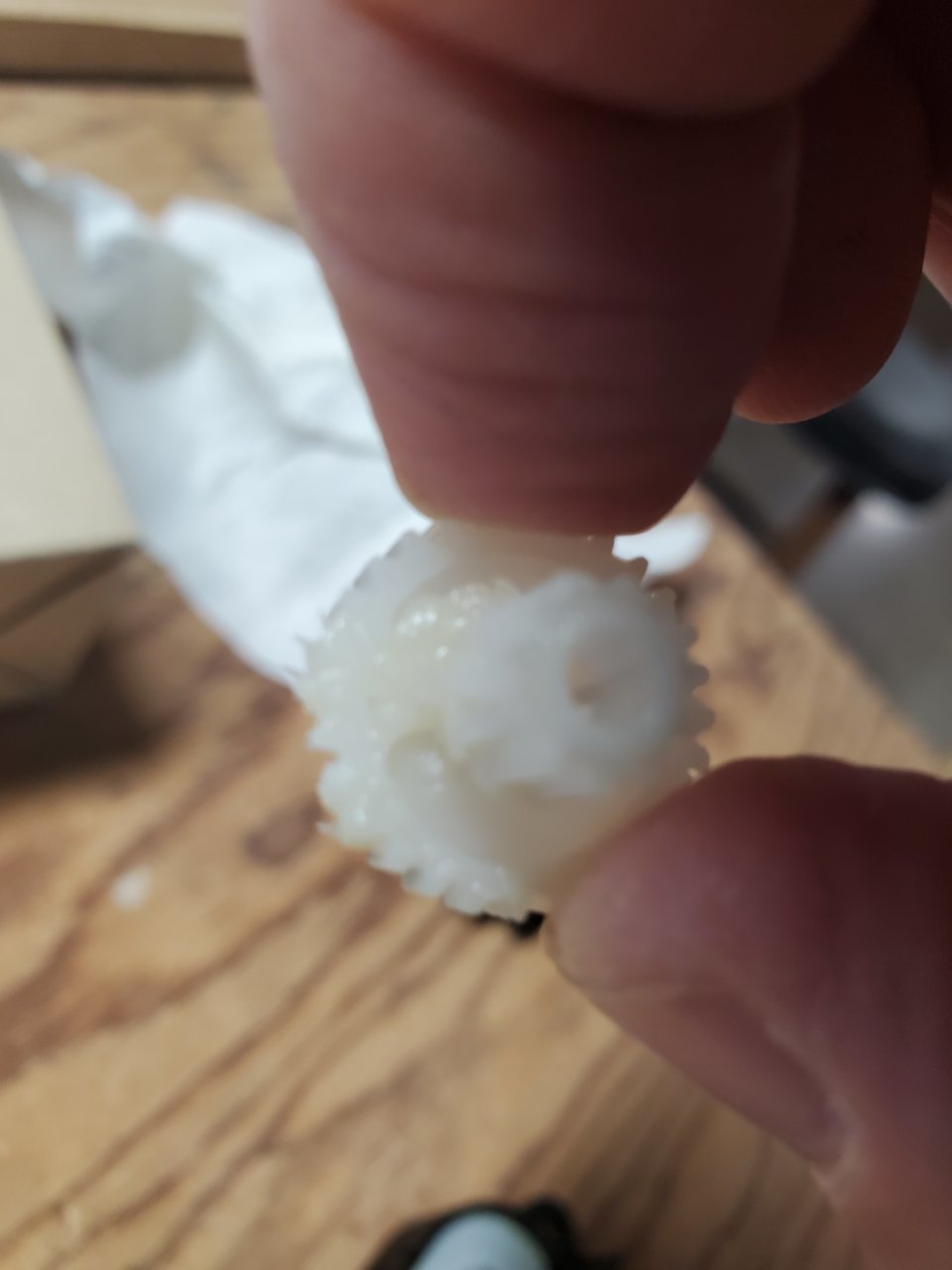

    Thie metal rod goes through the center of the gear that turns the largest gear (moves the arm that shuts off outside air).
    You can see the missing teeth on the large gear that moves the arm which shuts off outside air.
    In the last image, you may be able to see the missing teeth on the left side of the gear shaft.
