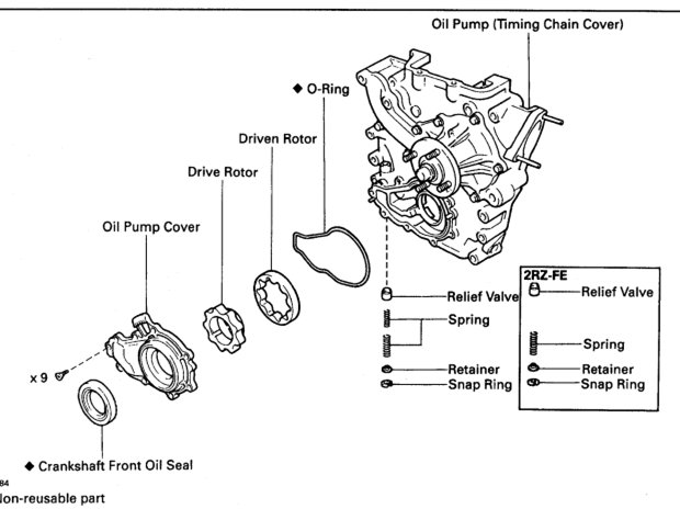

    I have been having a ticking noise at low rpms and is really prominent when starting off up hill. I assume it is a lifter if you think otherwise, say so. I started researching and saw additives and cleaners but i also ran across people saying replace the oil pump. Has anyone had this problem and fixed it? My oil light comes on for about 1.5 seconds or so when the truck is started but I think thats normal, if not then ill be replacing the pump.

    The oil pump on the 2.7 is not too difficult. I replaced it when I replaced the timing chain on my Dad's 95 2.7. It's on the front of the engine.
    The worst part was the phillips head screws refused to come out. Even using a manual impact driver, I still managed to strip 3 of them and had to drill the heads.
