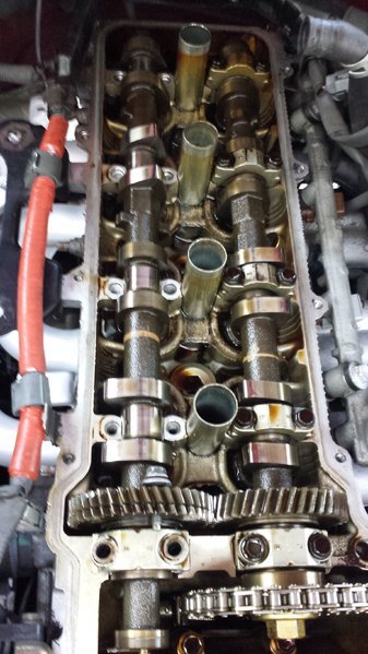

    He’s truck is a 2.7 though yes? Then it has buckets and shims.

    Yes bucket and shims ... I just got done with a full fresh rebuild, I'm more familiar with this engine than I should be lol

    @96towcoma I rebuilt the engine at 226k cause the previous owner screwed up the head gasket job (idiot used permatex and plugged a couple of cooling passages) and the head cracked. I bought an aftermarket head from APRauto (based outta CO) and they preshimmed the valves. When I checked them all the exhaust valves were at 12 thousandths and the intakes were at 9
    Toyota spec calls for .007 to .009 on the intake and .010 to .013 on the exhaust
    I've had one other 3rz that I did a shim job on and it's tedious a crap. They call for a special tool to compress the valve buckets to add or remove shims but I ended up taking a flat bladed screwdriver and torching a 90 degree bend in it, worked much better for me

    @96towcoma it's worth noting that the 3rz valve clearance will tighten up over time not loosen so if you're on the low end of the specs when you check, it's better to add shims in to open her up now than have issues with burnt valves later
