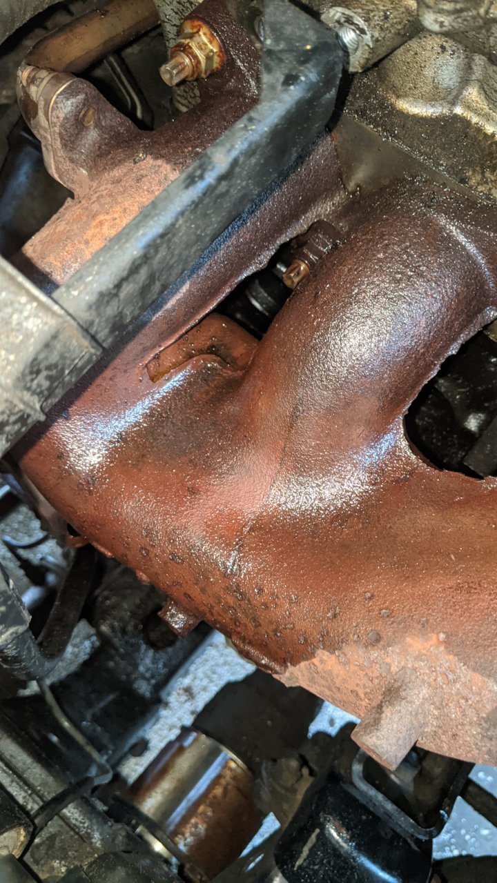

    Had a similar tick that matched the rpms. After looking with a flashlight at the exhaust manifold it was clear where it was coming from. New manifold and gasket and now it's super quiet and I can actually hear the radio.
    JudoJohn and Kristi with a K[OP] like this.

    yes. I’ll check again in a bit where it’s the loudest. Having a day with leaky washers….

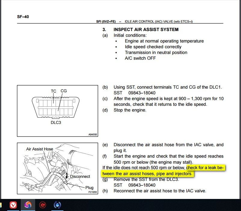

    Kinda all over the place, so back to this. My cel went on. P0505. IAC. It passed resistance & open/close tests. However, when I pinch the air assist hose closed, the engine calms down. Nice idle. The loping seems to be “in tune” with the exhaust, which also gets way better when I pinch the air assist hose.
    Does this mean there is a leak? I read it’s hose to pipe, then pipe to injectors. The hose is new. Seems to be ok, so does this mean I need to open up the intake again? One of the injectors, although it sounds normal (ticking), also has an odd sound. If I could catch it on vid I would, but it’s pretty faint. Only way I can describe it is it reminds me of the minions bee-doo, bee-doo, only more like ree-yoo.

    If you pinch a hose and your idle calms down, that tells me your IAC is stuck open. That wouldn't show up from a resistance test

    I couldn't do this test because of the tool needed, however this is what made the connection to the pipe & injectors....

    Soap and/or plug between points with your finger. Not sure, never had this issue
