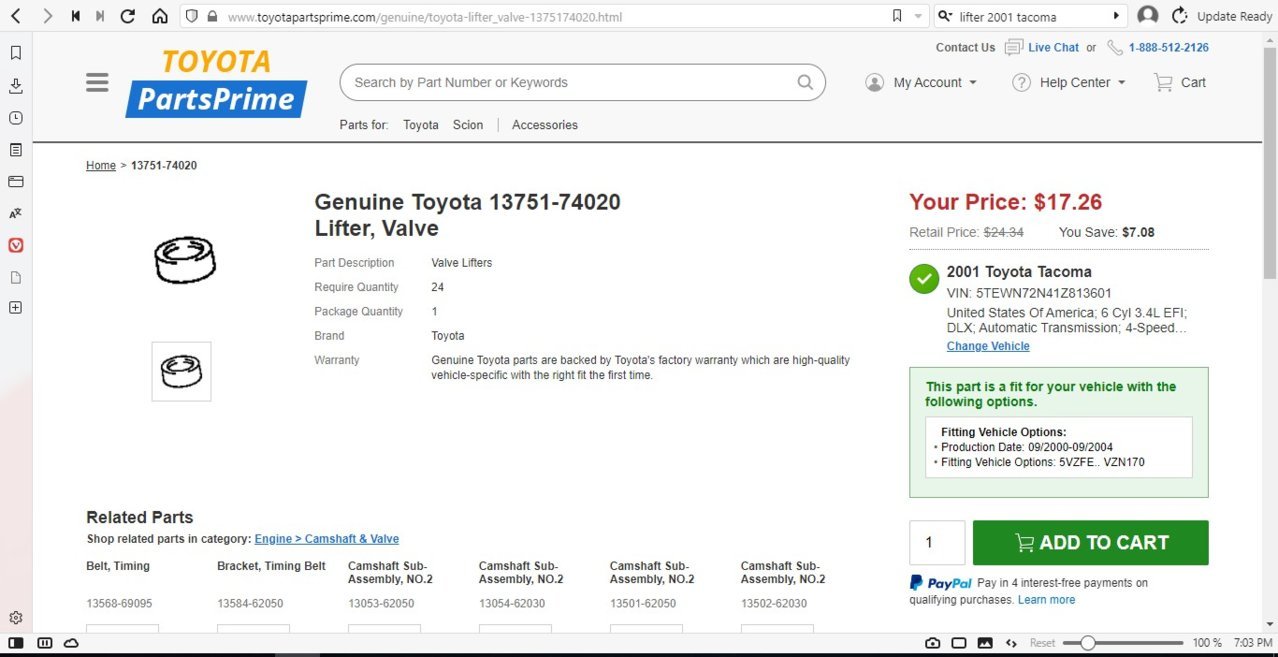

    I looked these up when @crazytacoman posted it
    These are not hydraulic?

    a bit of a misnomer as it is a bucket that holds a shim for precise adjustment of valve lift.
    Ours tend to tighten with age and get quieter. Ours are noisy at idle but it's a good thing.

    Those are the buckets.
    Technically your Taco doesn't have lifters it's direct drive overhead cam with buckets and shims for valve clearance.
    No push rods or rocker arms either.

    No, they are called “buckets”.
    Look up “shim over bucket”
