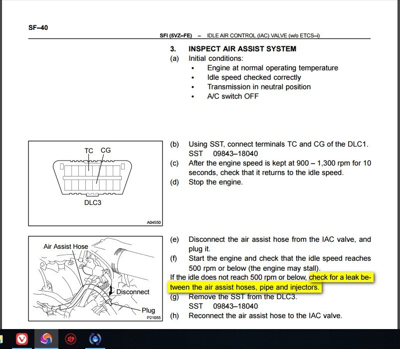

    I looked up the dlc3 connectors in the FSM instructions. I figured since the test is supposed to make the idle drop, maybe there was something to work with. TC as far as I can tell is turbocharge. So that must be just in case you have it, it takes it out of the pic? But what is cg? I didn't see it in the list....

    Reading through that FSM page
    3a Specifies that the idle speed is normal (not the case for you)

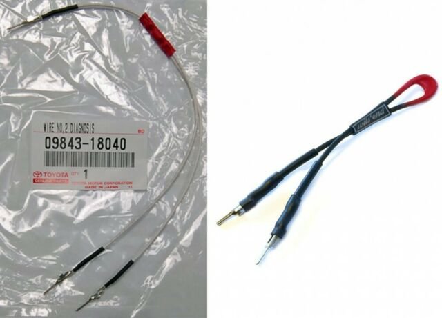

    3b-d TC and CG are wires that a SST or Special Service Tool (which looks like a jumper wire with possibly a resistor or something wired in line with it) which is supposed to bridge or connect to one another that will raise the idle. I do not know what the acronyms stand for besides simply callouts for the wires and can definitely say TC is not turbo charge because there’s never been a street legal turbo charged Tacoma from the factory.
    3e-h It looks like with TC and CG bridged the idle should go below 500 with the air hose blocked. I don't know if there's a resistor or not in that bridging tool and since you're not bridging the wires afaik, at this point I'm not sure if you're experiencing normal behavior with the idle dropping to "normal speeds" when clamping that hose. While my engine's out at the moment, my wife has a 97 with the same setup that I can try to check what you've been doing with. I'm not sure that you're carrying out these procedures accurately.
