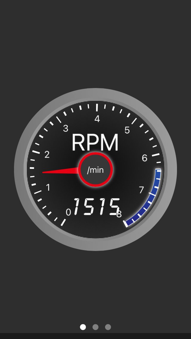

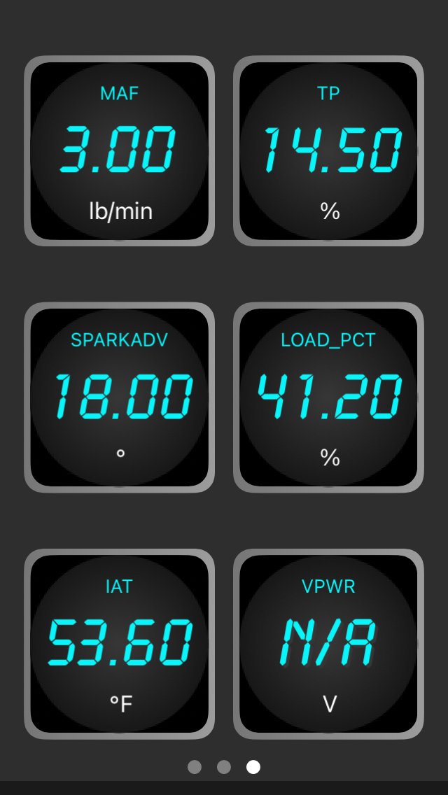

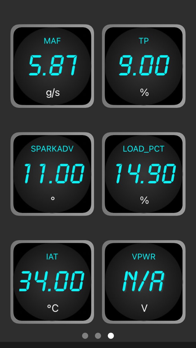

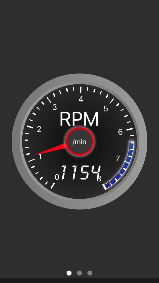

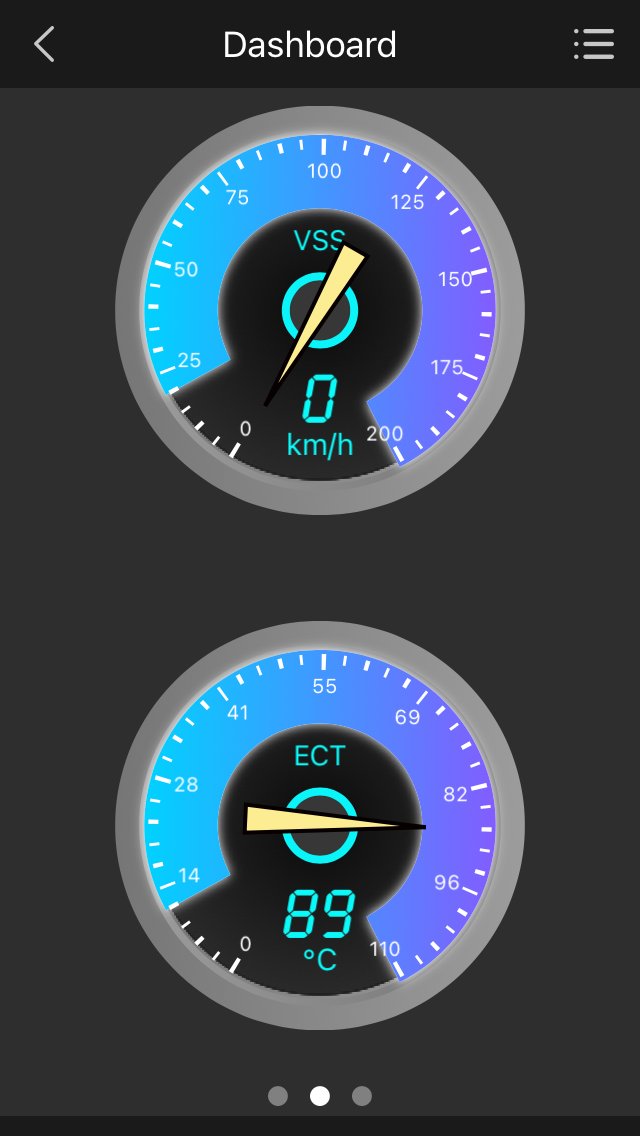

    So finally got it hooked up. There’s not much in the way of instructions, although not so uncommon these days what with the WWW.
    it’s a beautiful day here in MA, rain on the way tomorrow, so not feeling like spending it researching right now.
    However, figure I’d post these & see what I get for feedback. These are in park after a short trip around town.
    The idle went jumping from anywhere between 1130-1159
    04930521-5A38-4A45-BAC8-6000C4842EEB.jpg C0DE581F-0E6F-4FDD-984D-829C9F05EEA2.jpg 22760784-46E7-44DC-96CD-A8A5E1355DFB.jpg

    That looks about right
    The MAF should be close to the engine displacement at a warm idle. But you idle is high so it’s pretty close.
    The IAT seems a bit high at 94 degrees. But that could be due to the engine heat soaking the air in the engine bay. See what it say going down the highway at 50 mph or so.
    Not sure why your idle is high.
    I say, take a break and enjoy the rest of the day. And figure out how to get the readings to U.S measurements. :rofl:
    This ol’ country boy don’t know his metric system too well. Other than bolt and wrench sizes. ;)

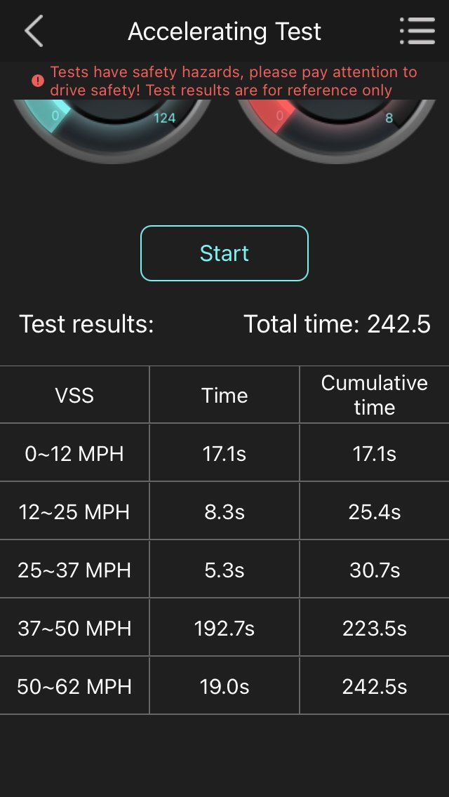

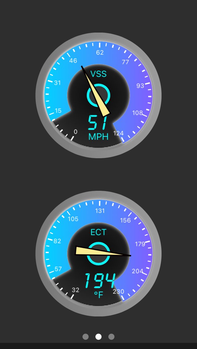

    Snapshots at @50. & an acceleration test?

    Looks pretty good to me.
