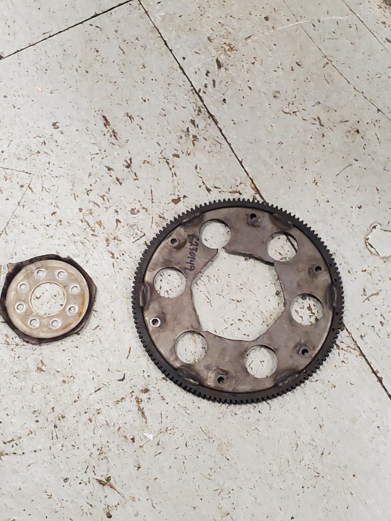

    I've been really busy with work lately but I finally got around to updating this.
  19. Jan 26, 2025 at 12:53 PM
    #19
    tac0797
    tac0797 [OP] Member
    Sep 27, 2024
    #457825
    9
    Forrest
    2007 Tacoma
    Also I opted to unbolt trans/cross member/ drive lines etc and move the transmission back a few inches to swap the flex plate out. Unless you have a lift and plan on pulling the transmission completely I would not recommend this method. It would have been far easier to pull the engine (I have done both on this vehicle now). Also if you by chance have big fingers like me and drop one of the bolts that connects the flex plate to the torque converter behind the flex plate don't try to take it out the bottom. It doesn't have enough room to get it up through one of the flex plate holes. just send a magnet down on a piece of wire from where your starter bolts on, much easier that way. It took me 3 hours with a bore scope and a magnet to figure that out. haha
