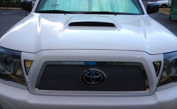

    The goal of my build is to get my TRD OffRoad to have the looks of the Sport i.e. hood scoop, color matched parts, with solid off road capability. I'm not looking to rock crawl or Baja, just want to go exploring/overland and not get stuck that often.

    • TRD Sport Hood w/ scoop,
    • E&G Classics Custom Stainless Grill,
    • Color matched grill and door handles

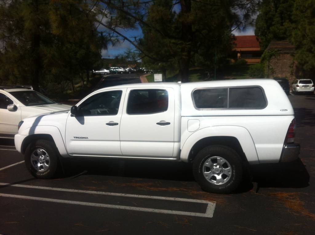

    Made the sale of my PreRunner Sport contingent on him switching hoods with me. So switched hoods, installed an E&G Classic custom grill and bought a Super white grill off Craigslist for $60 (Sold my chrome one for $80).

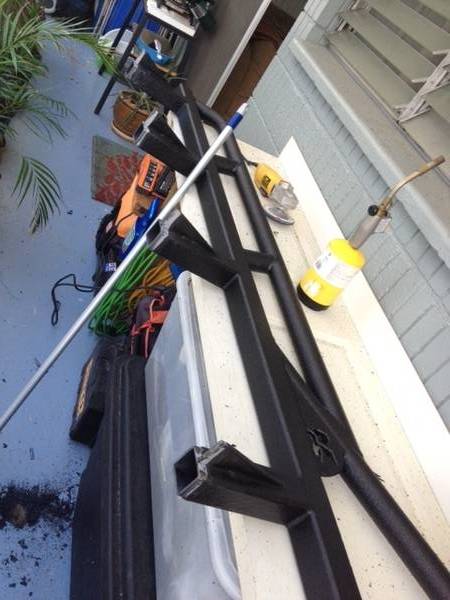

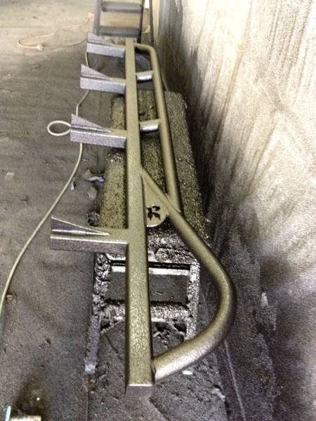

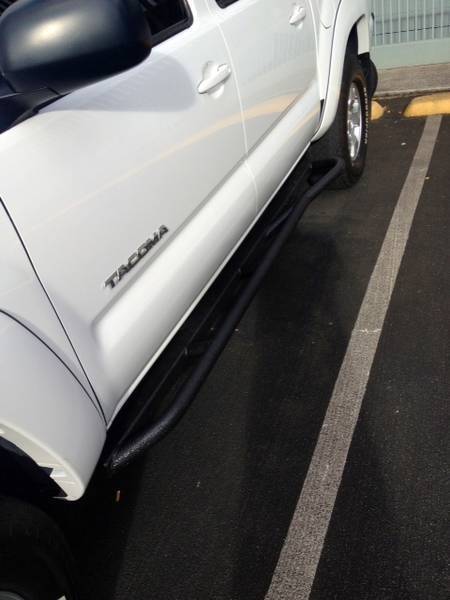

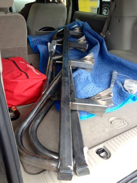

    Picked up my sliders from the Relentless Fabrication Hawaii Slider Group buy.
    Got my Relentless Fab Hybrid weld on 2 piece with kickout sliders LineX’d.

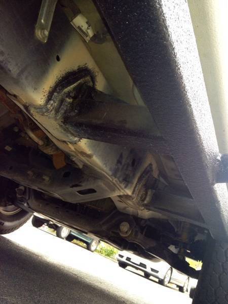

    Except he coated the ends, and I had to have those welded, so after 2 hours of work I had the ends stripped (if you have to do this use a hot knife let cool and then peel off whole)
    Took them to a local fabricator/welder, Plan B Fabrication out of Kaneohe to weld on my sliders
    All welded on
    Sticks out a little far but haven’t put on my lift or tires yet, no more door ding worries though!

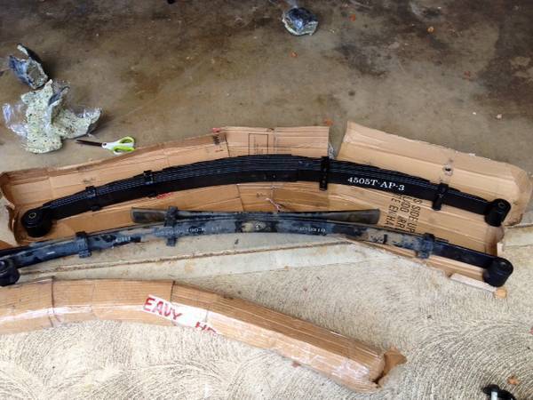

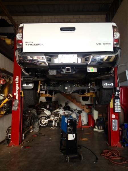

    And finally the lift install begins, had been waiting on “The Parts Whore” (A part dealer on TW), who took 3 months and 2 weeks to fill my suspension order one part at a time (Not Happy, but different story).
    Here is my spare room for the last 3 months (unhappy fiance)...

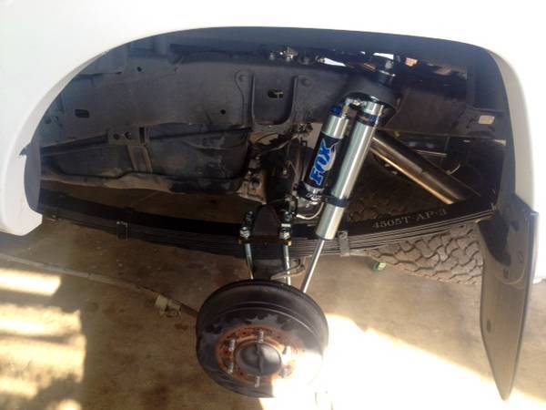

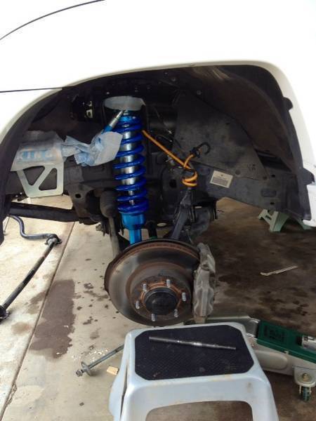

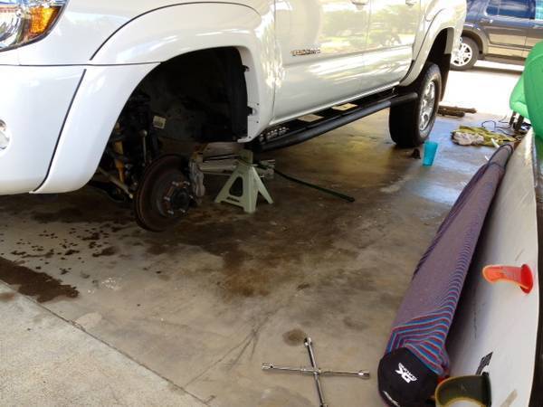

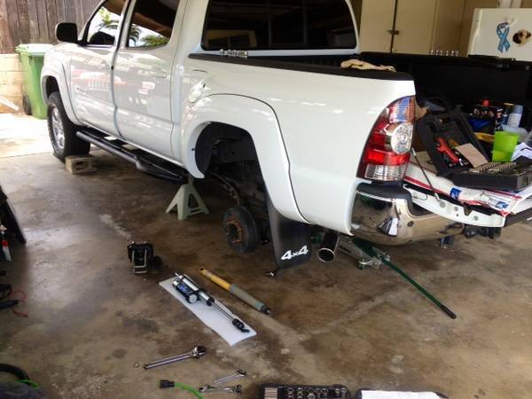

    Using my sisters garage, all by myself for a weekend I installed a 3” All-Pro Leaf Pack, All-Pro U-bolt flip kit, 2.0 Fox Piggy back rear shocks, 2.5 King Coil over w/ remote reservoir and Total Chaos UCA’s.
    Old and new (huge difference)
    Finished rear
    Started the front

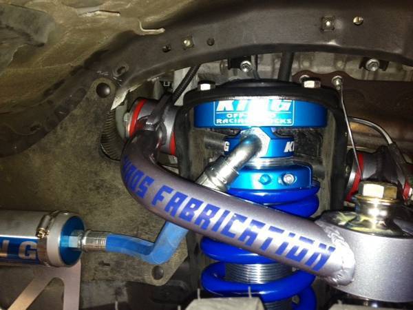

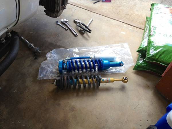

    Stock vs King
    Installed everything but the UCA's which were supposed to have gotten in 8 days prior

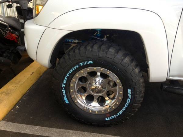

    After getting the suspension completed I went to get my new wheels and tires I ordered a few months back. Mickey Thompson Classic Locks Polished 17" w/ 4.5" backspace and BF Goodrich KM2's 285/70/17's
    stuffed in there

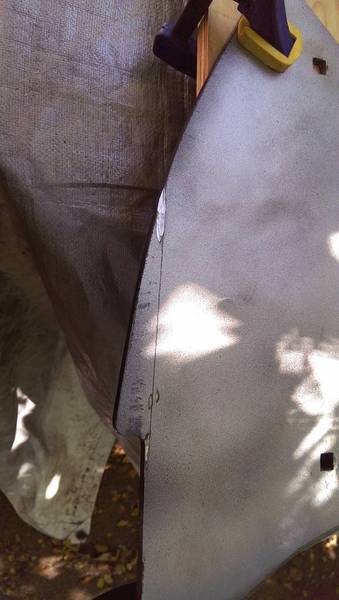

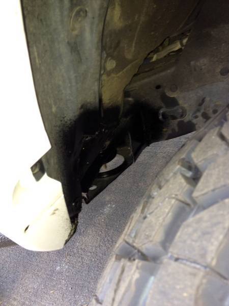

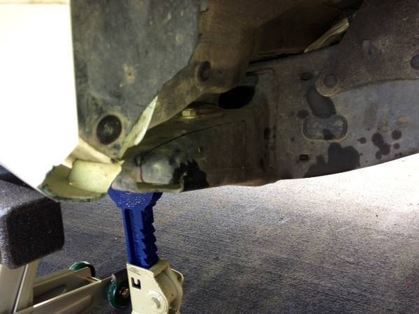

    Had a lot of rubbing, so I needed to do the Cab/Body mount chop and some trimming, you can see where it was already rubbing just from my drive home.
    finished but still got quite a bit of trimming left

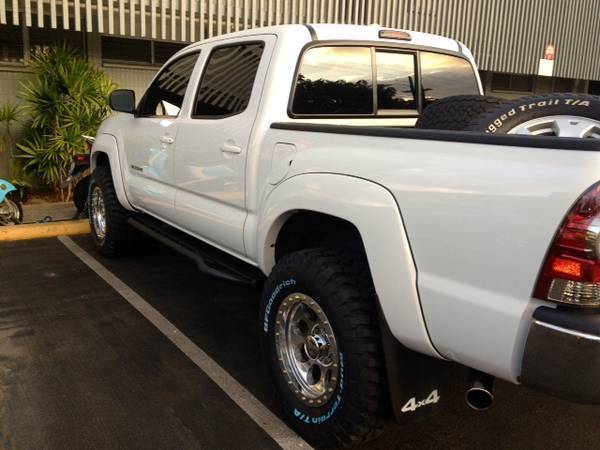

    Next on my list is cranking up my Coilovers another inch and a little more trimming for when I'm full wheel lock in reverse and using my caliper paint kit plus finish painting then installing my BAMF LCA skids. These things are stuffed in there...

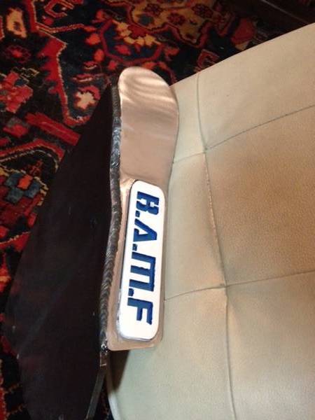

    Just polished and painted my BAMF LCA Skids. Clear coated the polished part and the blue BAMF is a metallic that matches my King Coilovers almost perfectly.
    I know these are armor but I only really go in the sand, and I'm big on the looks of my truck.

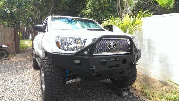

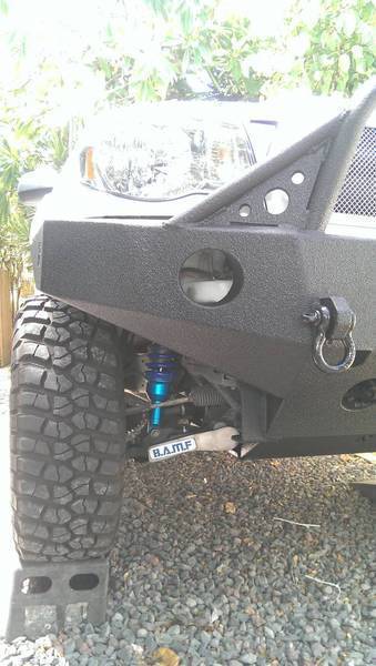

    Just got my Relentless Fabrication Armor and had it spray lined at Pamalu Liner in Honolulu.
    Installing my Relentless Fabrication Aluminum Front Bumper and Relentless steel IFS Skid was definitely a 2 man job and not a 1 hour ordeal.
    Finished product.

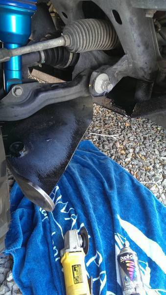

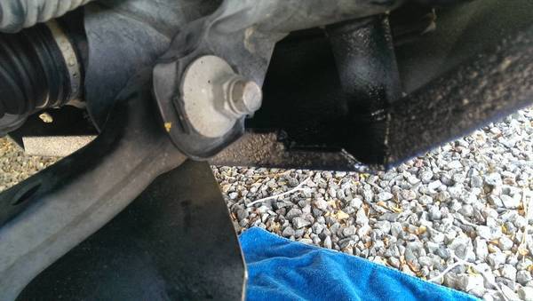

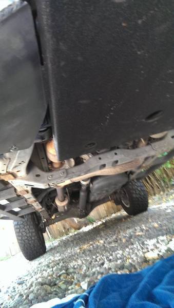

    This holiday weekend I stalled my BAMF LCA Skids. Thought it was gonna be easier than expected, that has become standard operating procedure.
    Had to trim my LCA Skids then A tiny bit of trimming on my IFS Skid.
    This is where I cut into the IFS Skid for clearance on the upper circular part of the LCA Skid
    This shows the over lap issue before I trimmed the LCA Skid
    This is what I had to trim.
    Finished!
