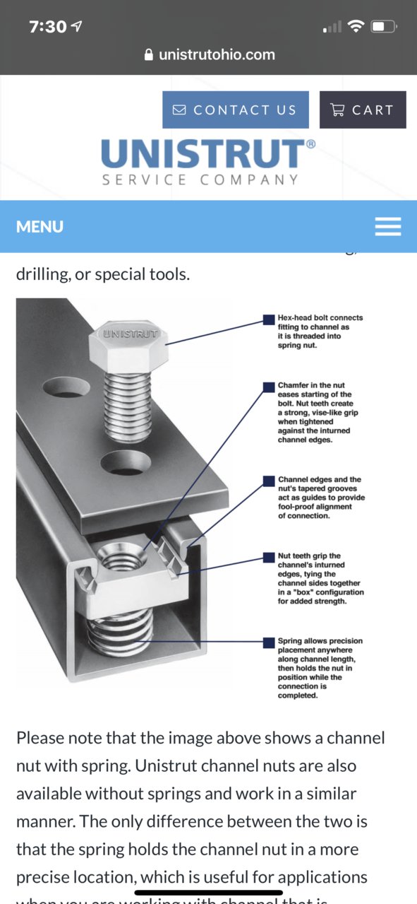

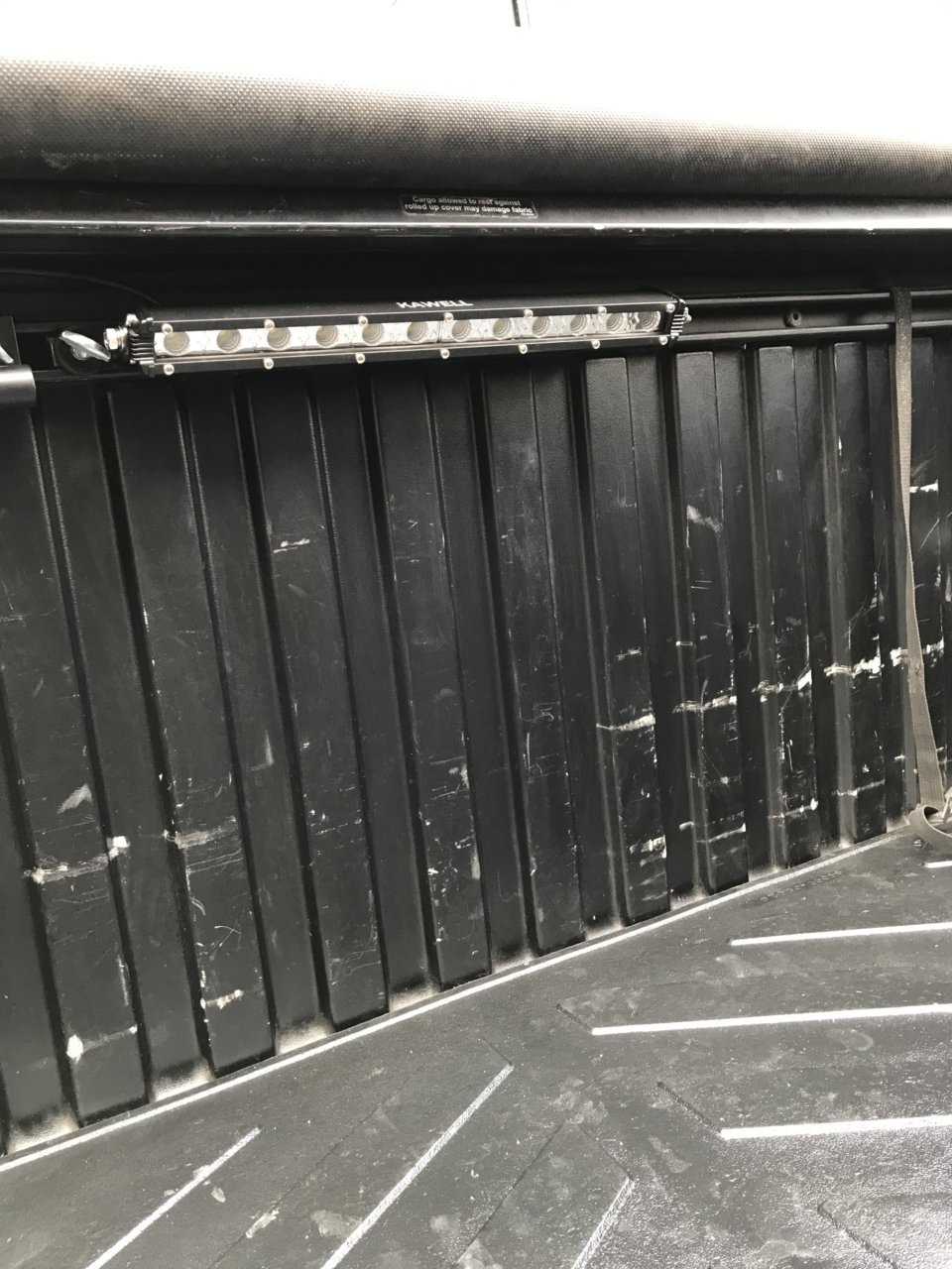

    You can always go to Home Depot and buy spring nuts and put an eye bolt into them and make your own secure points. they fit in the rails. What ever you can think to attach to them. Ive seen people secure shovels and extra lights. That how I attached my bed light 1FED0C76-BC23-4252-962C-BCB57CDB4B80.jpg
