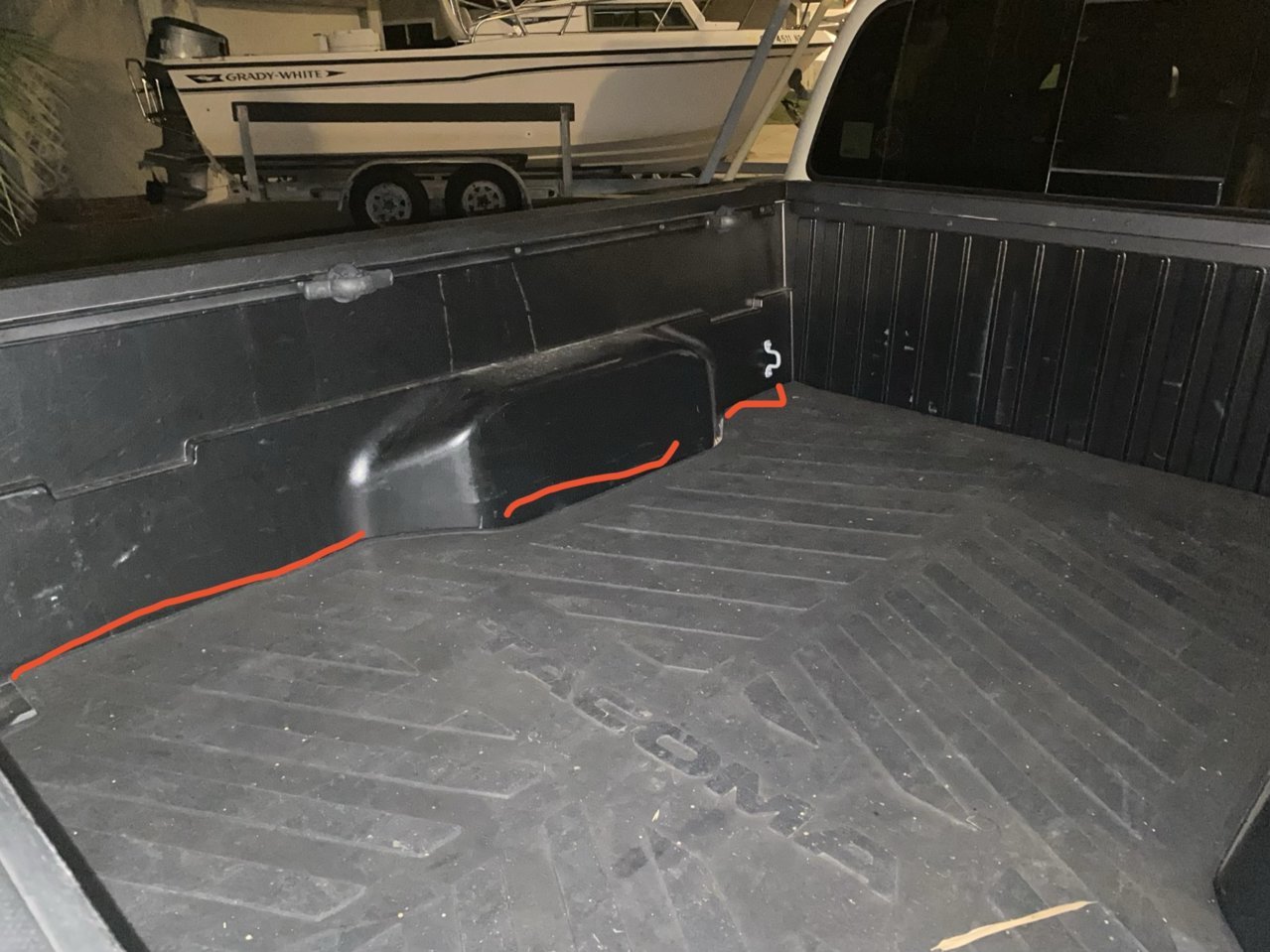

    So I want to add some tiedowns to my bed. Keyword here is down. The stock rails don’t hold stuff down well unless the item is tall. So I was looking at the VersaTie system. I figured I would add strips along the sides of the bed where the bed wall meets the bed floor and where the wheel well meets the bed floor. But while looking at those options I thought I should also replace the stock bed rails also, so the same hardware works everywhere. And probably even use them on my Prinsu rack.
    The pieces seem reasonable priced and are rated stronger than the stock ones.
    Is this a bad idea?

    Mounting to the bed floor will interfere with the mat which is why I thought the base of the wall would be a better choice.
