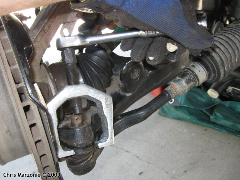

    One of these should make quick work of separating the outer tie rod end.
    This one is from Harbor Freight. The auto parts stores should have something similar in one of their loaner tool kits.
