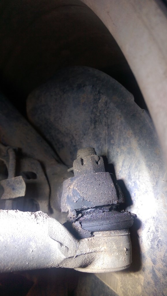

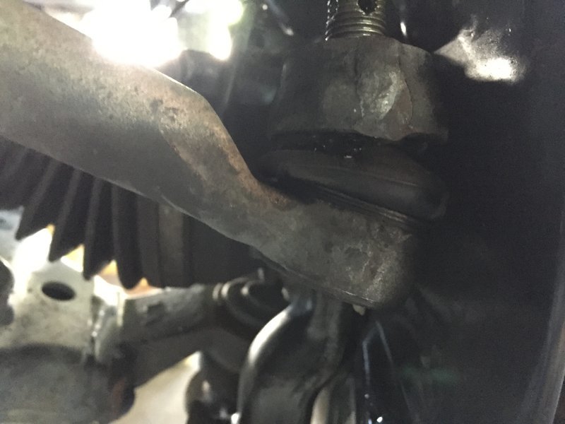

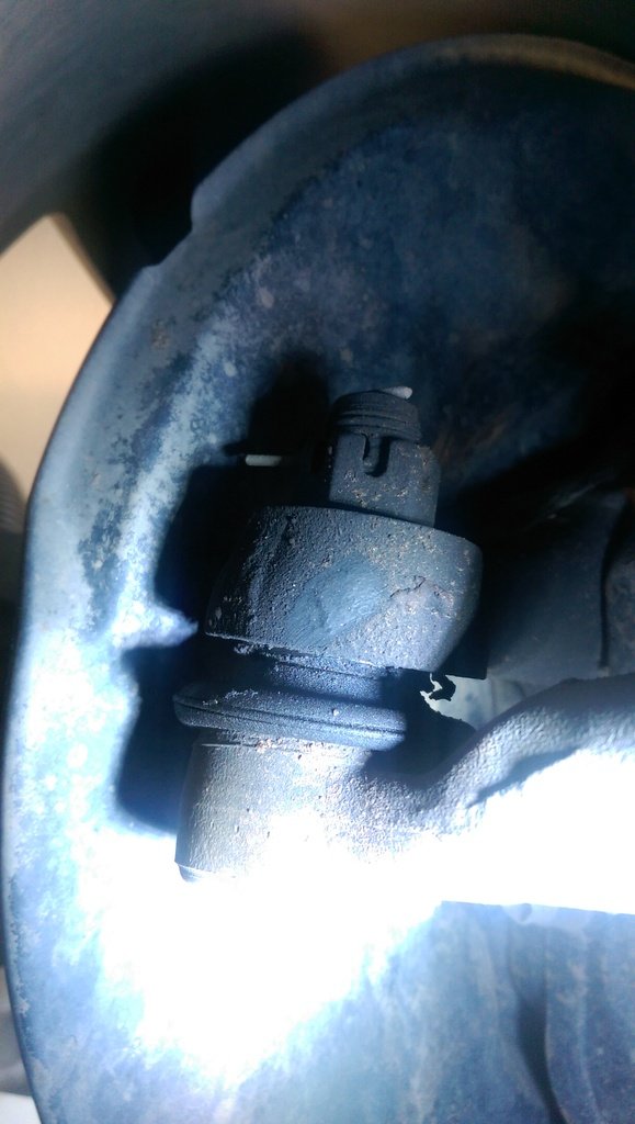

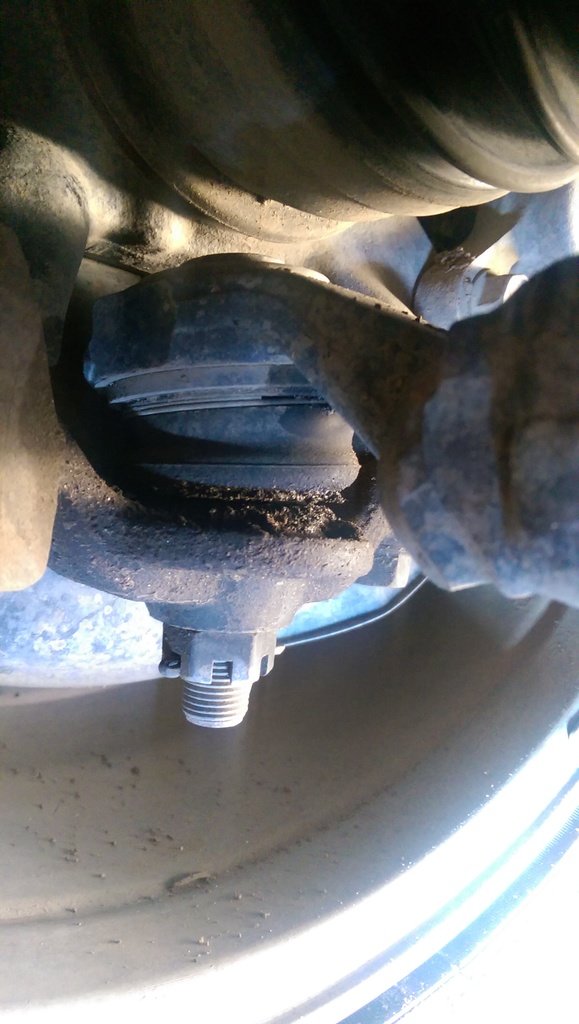

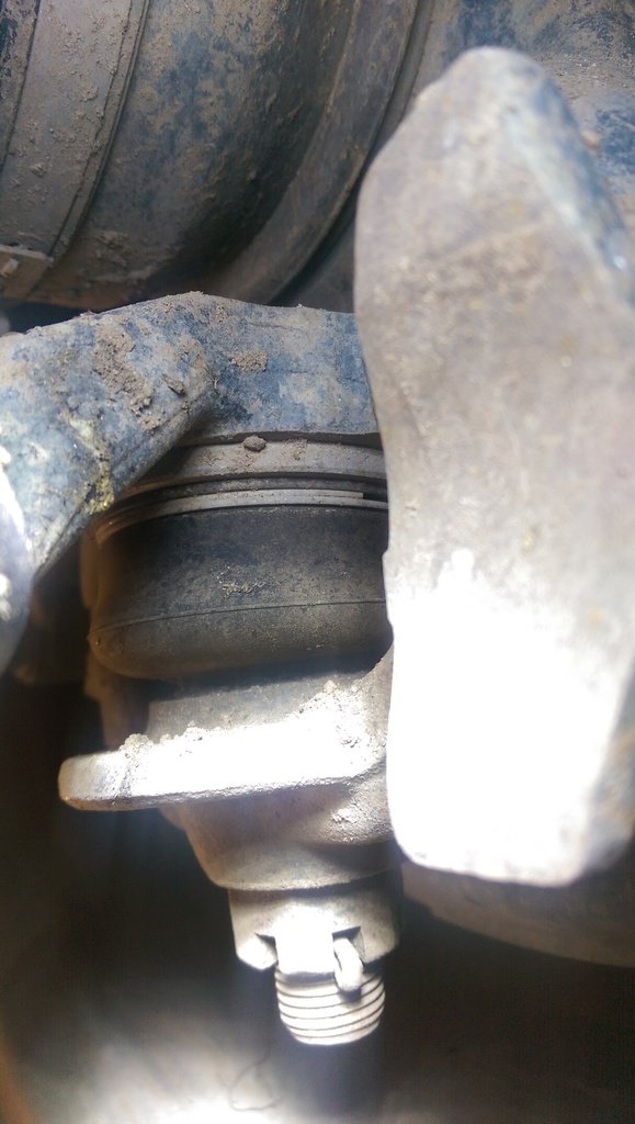

    I was recently under my 2009 Tacoma to replace my sway bar that I'd taken off for a trip to the mountains and noticed some rubber boots on a few parts that looked like they needed to be serviced. Pictures below of the parts I'm talking about; looking to get opinions on if they are blown or not. Truck is a 2009 Sport with 108k miles on it.
    Below are pictures of the parts I'm talking about. As you can see, there appears to be some grease escaping the boots on some of them so I assume they are torn and need to be replaced. I saw this DIY HERE but I think I'm going to have to buy a fair amount of tools to make that happen. If I decide to take it to the dealer, arm and a leg or nah? I see some people just replaced the control arm all together. Is that the way to go and if so, any aftermarket control arms that would be an "upgrade"?
    Left (drivers side) Lower ball joint looks fine.
    Left tie rod end looks to be toast.
    Jury is out on the right tie rod end.
    Right side lower ball joint appears to be toast.

    As long as the boot has no tears and there is no play, I think you are OK. From my experience, grease will ooze out but that doesn't mean dirt is getting in. The issue is the ball joint drying out. You will want to re-grease the ball joint but if your BJ's have no zerk fittings, your only other choice, other than replacement, is to re-grease them using a needle nozzles. You can Youtube how to use them. The hole can be patched with silicon or electrical tape. If the boot is supple and thick enough, the hole will reseal itself.

    Yeah I don't see any obvious physical damage to the boot itself (in any of the above instances) but there's some grease certainly oozing out. If it's as easy as slipping a needle in and re-greasing I'd be able to do that no problem. Any way to tell if that's the proper solution? I guess a thorough cleaning of the area first (for inspection) is likely needed. Any tips would be greatly appreciated.
