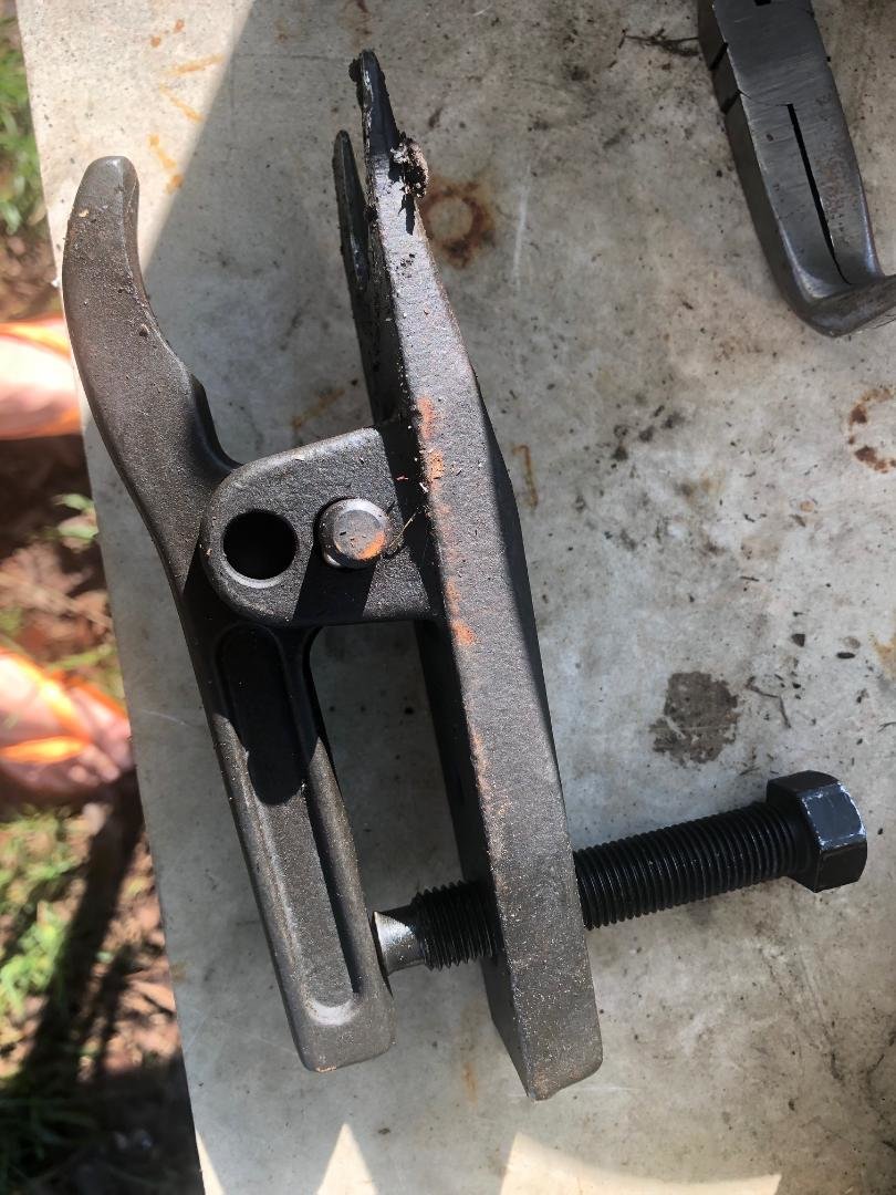

    I am trying to put some new tie rod ends on my 04. I have a tool to separate them. (See pic). But is there a tool to press it on? I tried to put pressure from below with my jack. I am afraid if I try to pull it tight by cranking on the castle nut that it will strip, or just as bad, the threaded bolt will start to turn, and there is no way to hold it from turning , should that happen. I had to replace some inners, the piece the outer screws into, One outer looks to be serviceable. Can outer tie rod ends be reused once they are removed? What is a good tool, and a good source?

    I had to use the tool in the picture to get them off. I don't know how many foot lbs. I pulled (actually pushed, it is the passenger side) way more then 50lbs. Enough were I will need a pipe extension or my 18" bar. I wish I had heat to put to it. The new one looks the same as the old one. I think the old one would need to be pressed on as well. I looked at this tool I can rent. https://www.oreillyauto.com/detail/...056/automotive-truck-2004-toyota-tacoma?pos=1 Not sure that would work.

    You sure you're wrenching on the correct part? That tool pictured can be used with ball joints - not tie rods. At least not that I'm aware of. Reference any of the below videos, might clear up any issues you're running into - note, videos assume your truck is a 6 lug and not a 5 lug tacoma. Attached PDF has torque specs for a 6 lug.

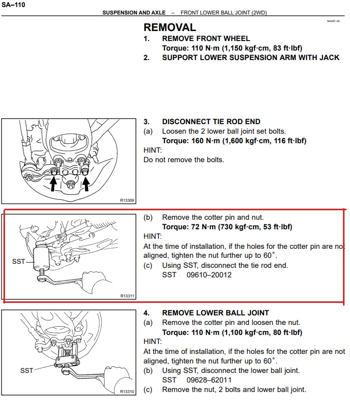

    For whatever it's worth- here are the FSM pages:
    While they don't offer much help- they also don't suggest that force is required to install them.
    As for the videos above, it's worth noting OP is 5-lug with a different rack and tie rods than the 6 lug videos.
    But that doesn't change the the installation procedure much.

    For what it's worth, I have a balljoint separator like that one, and it works fine for tie rods too.

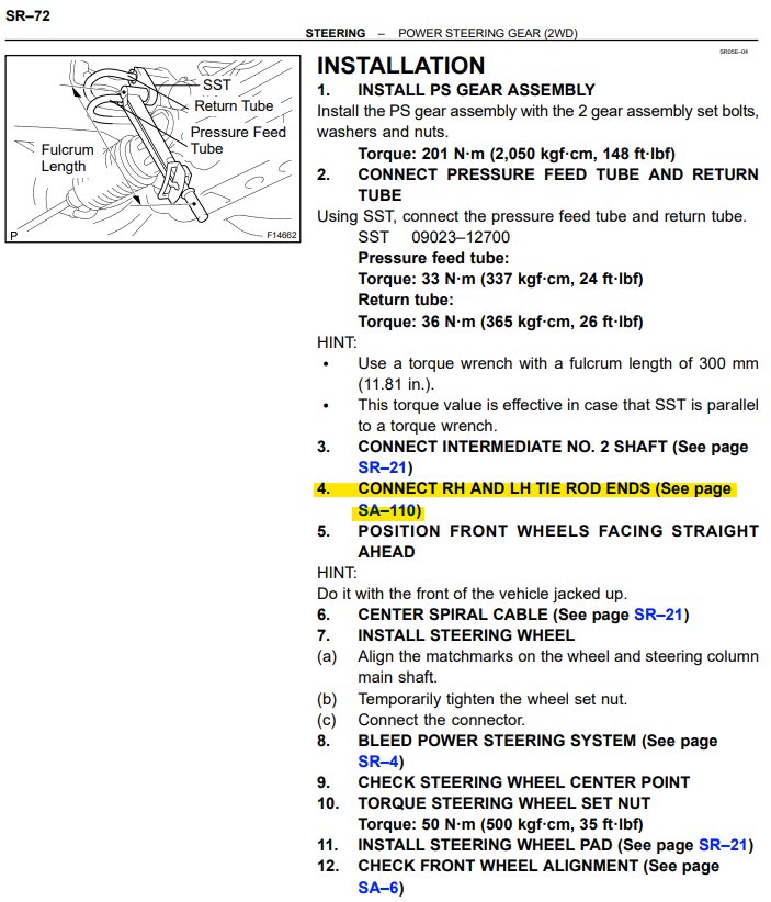

    Nice!
    My FSM doesn't have that. Thank you for the info!

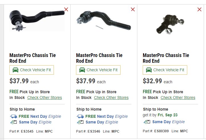

    I'd suggest (again) confirming Oreilly's sold you the right part. Their option menu doesn't let you pick 5 lug or 6 lug, so the guy behind the counter gets these results:
    I assume because they are male threaded on the 6 lug, and female threaded on the 5 lug parts, that you would notice.
  20. Sep 20, 2022 at 12:49 PM
