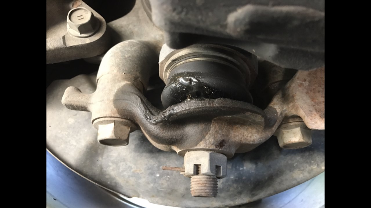

    Does this one need to be replaced?
    2012 with 83K miles.

    that ball joint may last you years even with a boot tear

    That's what I figured. All my vehicles have either been new so they were good or old so I just replaced them. These seem fine but leaking the grease. Is there a way to check for bind w/out removing them? I usually destroy them when I remove them.

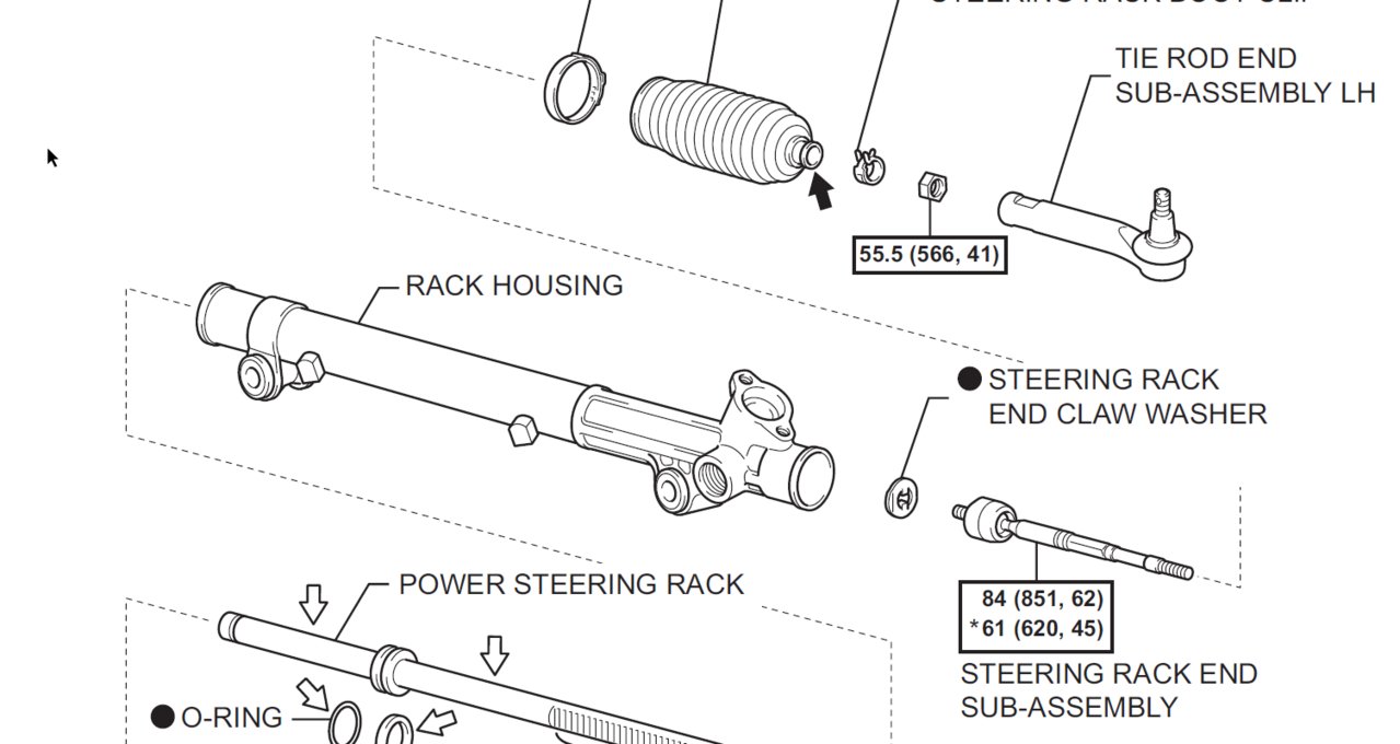

    Not trying to argue, but that isn't a tie rod end.
    That is a steering rack end. I've never seen a bad one.

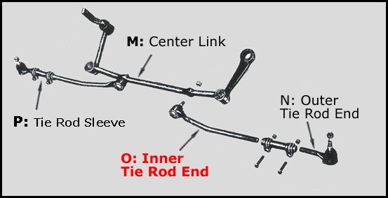

    That's an inner tie rod end all day long.. toyota doesn't list them because they want to sell you the whole rack
    They do get loose, mostly on American crap

  19. May 21, 2018 at 9:23 PM
    #19
    Jimmyh
    Jimmyh Well-Known Member
    May 16, 2012
    #78991
    14,276
    SC
    2012 Prerunner SR5
    Sorry Bro, See the image I posted from the Toyota Service Manual above...
    The below image has true Inner and Outer Tie Rod ends with a Center Link, Pitman Arm and Idler Arm.
    It is more symantics than anything else and people trying to define between the two systems.
    When they went to rack and pinion steering it is a different animal.
    Wishbone,
    Thanks for the offer, but I have seen more than my share of both tie rod ends and steering rack ends. You can call them Hoopity Doos if you want, but it doesn't make it correct.
    I have seen them called both online and in auto prints. I concede the point.
    MolonLabeTaco and b_r_o[QUOTED] like this.
