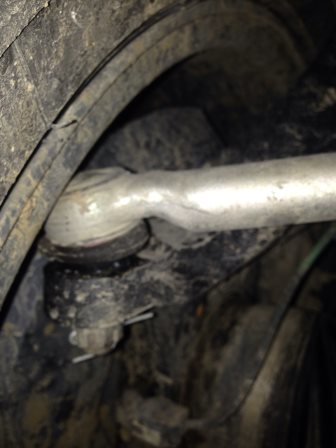

    upadate
    (just incase anyone was curious on what i ended up doing)
    i ended up grinding down my tie-rod ends a little to increase the gap between them and the wheel :crapstorm:

    Not a good idea.
    The tie rod end strength is now compromised and what is going to happen when / if the ball socket decides to come loose going 75 MPH down the highway?
    I wish you luck.
    Please post a picture, I would love to see it.

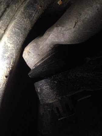

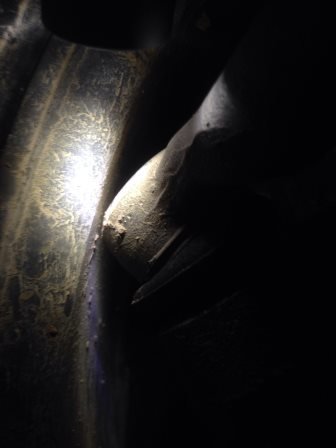

    i wanted 17s, not 18s....and i got em. took less than a minute with a grinder in my hand ;)
    this is before i ground them down

    i was told by the guy at the shop (which is very reputable where i live) that i would be ok with 17s instead of 18s. they installed the lift and when i got home and started looking under the truck i noticed this issue. i wanted to keep my 17s being that the tire selection is very limited for 18" wheels. so i ground down the tie-rods

    Go on Rock Auto and see if there's an aftermarket tie rod end from Deeza, Beck Arneley, Moog, etc. with a lower-profile cup. Some mfrs use a one-piece machined cup instead of the two-piece OEM design.
