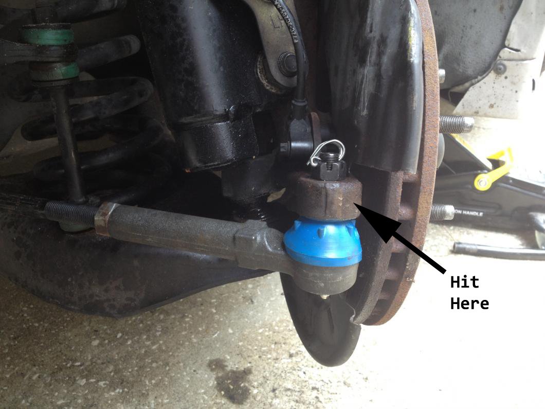

    Smack the outside of the spindle that the threads go through with a BFH. Works every time.

    I know this isn't a Tacoma, but same idea...

    Make sure the jaws of the puller aren't on the boot. Took one turn of a ratchet on the bolt to pop 'em loose. Good luck!

    Same. Start with a hammer and hit the spindle as pictured above to shock it loose. It that doesn't work I use a pickle fork if the TRE is being replaced since it'll most likely kill the boot or a 2 arm puller if I plan to reuse the TRE.
