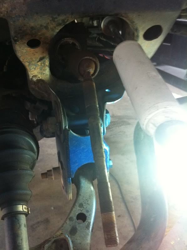

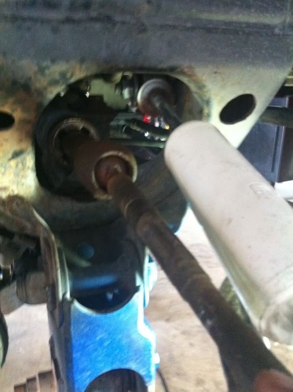

    HAHA....took the passenger tie rod off and well, was pretty sure it was beyond warn down. Got it replaced and took off the drivers side and it seemed fine but i replaced it anyway. My steering is crazy better and I feel safe driving once again. Also got my 5100's installed all the way around. Can't tell if the ride is better yet but in a few weeks I should be able to.

    Wow that one is crazy loose!! Scary!

    After I got it back from the collision center I felt so unsafe in it, I almost refused to drive it..I thought they were lying to me about it being warn....guess they weren't trying to f me over after all...
    But now its all working great again :) Im so happy :D:D:D:D

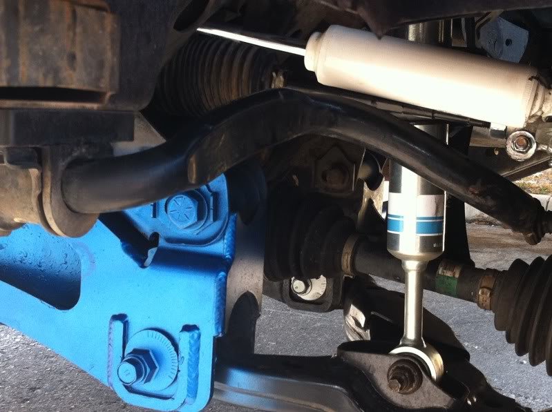

    Looks like U installed the sway bar upside down

    IIRC I think that 6" kit requires the sway bar to be installed upside down, not 100% sure

    I did? Ill take another picture so you can see the whole thing. If i did then that would solve my problem of the sway bar hitting the stabilzers.

    when upside down looks like U may not B able to put a front skid plate on
