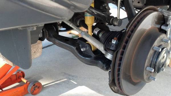

    It's really not that difficult at all. Here's a shot of my lift 2 weekends ago with most of the IFS broken down so I could remove the coil assembly. As someone said earlier, once you get it pulled apart, you see how it really works and it's not difficult at all to reassemble. The old 'flip the nut and a few good smacks with the hammer' worked fine for me, just don't smack too hard.
