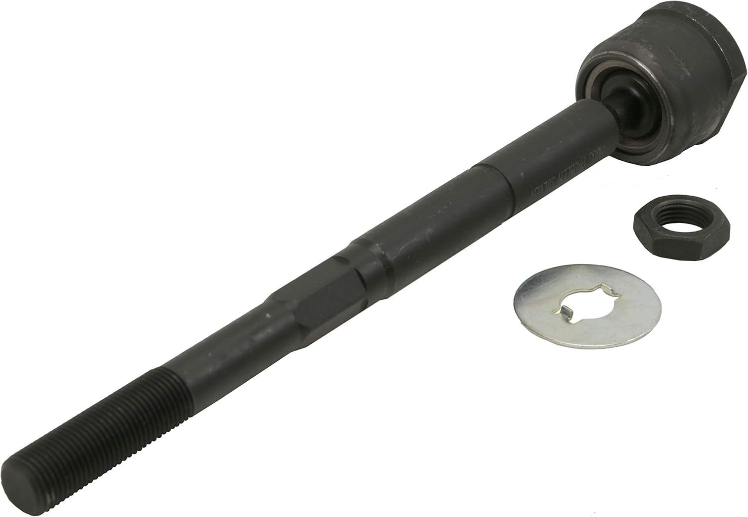

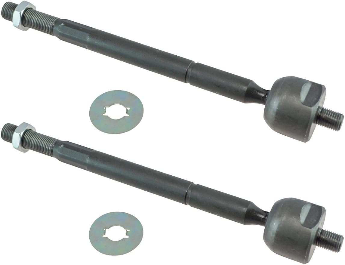

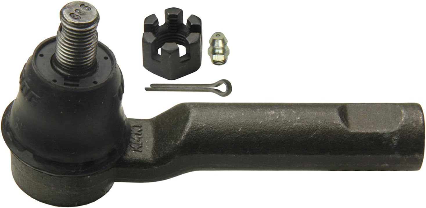

    checked the Moog catalog
    inner EV800529
    outer ES80895
    was like $40 for all of it
    Amazon says it doesn't fit
    but Moog's site does. I trust them more than Amazon.

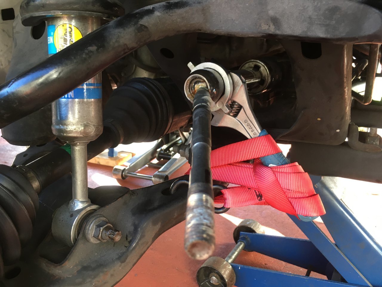

    To avoid putting too much stress on the steering rack I rigged this adjustable wrench with a ratcheting strap when loosening and tightening/torqueing the inner tie rod. And yes if you can borrow the tool it is very well worth it.
    And yes stupid me for buying the tool but I've used the tool four times already so it paid for it's self in my book. Best of luck!
