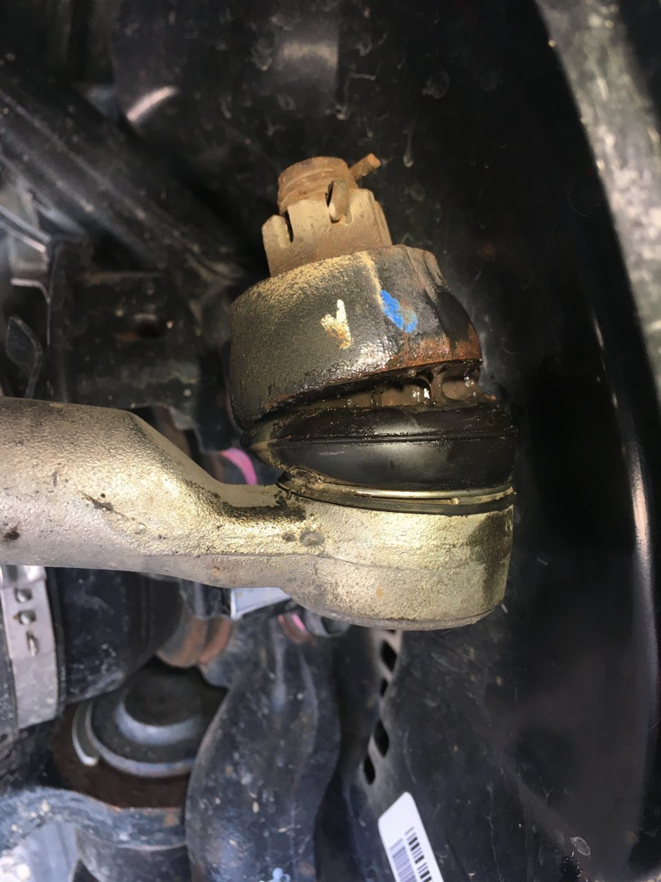

    Finally, as I'm trying to have another go at the tie rods, I notice there's quite a bit of grease around the drivers side boot and sure enough she looks torn. I had it in for an alignment about 2 months ago, 25k service and new rim install at the dealership a few weeks ago, and nothing was mentioned to me. Likewise when I was installing the suspension last week, I didn't notice anything torn either. I don't want to blame anything on the shop just because I noticed it now, but what does it even take to rip the boot like that? I haven't done any wheeling lately, had no impacts otherwise either. The boot is severed quite evenly all the way around making what just looks like rubber bowl of grease. The only way I can imagine having done that is when I was moving the wheel hub around during the suspension install, but there's no way it resulted in enough flex on the boot to rip it...or did it?
    Passenger side for comparison:
    So all in all, is it the shop or is it just a coincidence? I hate relying on other people to get things done right, so I'd much rather get that piece of pipe to adjust the tie rods, flip the alignment cam, and replace the boot on my own, but I'd love to know what you guys think.
