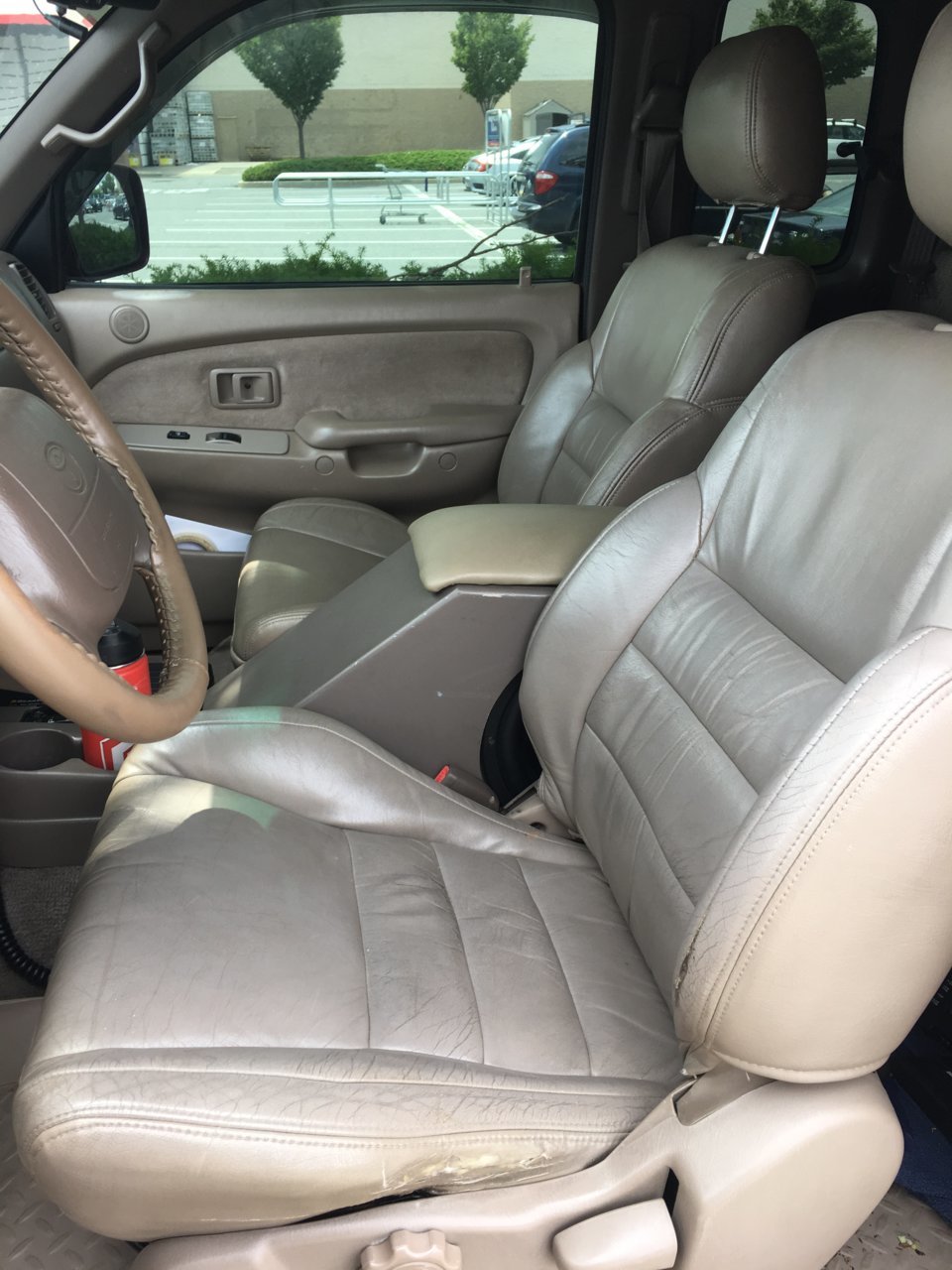

    Finally found some non-power 4Runner Tan Leather seats on craigslist and installed them today. The only bad part is on the driver seat side bolster. It is cracking from age. I might try to repair it, but we'll see.
    Like most people before me, they discovered that 3 of the 4 bolt holes line up. The outside rear holes are almost exactly 1.5" diagonally forward at 45 degrees. I plan to make some brackets at work tomorrow so I don't have to drill new holes in the floor.
    The outside front mount is at a 45 degree angle, but I just beat it with a mini-sledge to get it where it needed to be.
    All of the photos of 4Runner seats that I have seen online have the center stitching running vertically, not horizontally like these. I am wondering if these were recovered at some point.

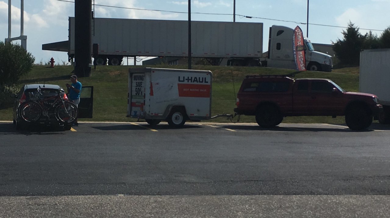

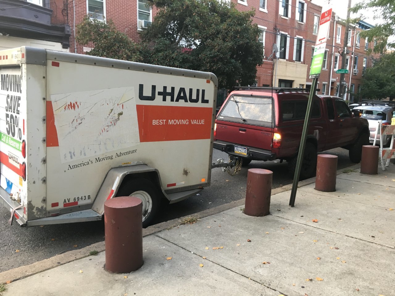

    Just completed a 1750 mile move from Philadelphia to San Marcos, TX. I towed a completely loaded 5x8 U-Haul cargo trailer. We did Philly to Nashville, Nashville to Dallas, and Dallas to San Marcos. It was a long drive, but the truck did fine other than blowing out an EGR gasket in the middle of the trip. I kept my eye on my transmission temp and made sure to leave plenty of room for stopping.
