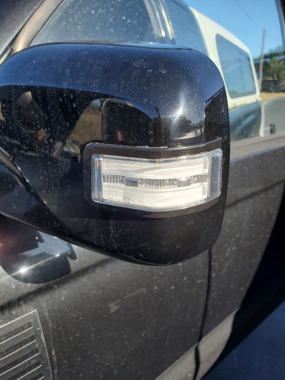

    Ok, yeah not going to be that easy for my 03, surprisingly no one has done a write up on this

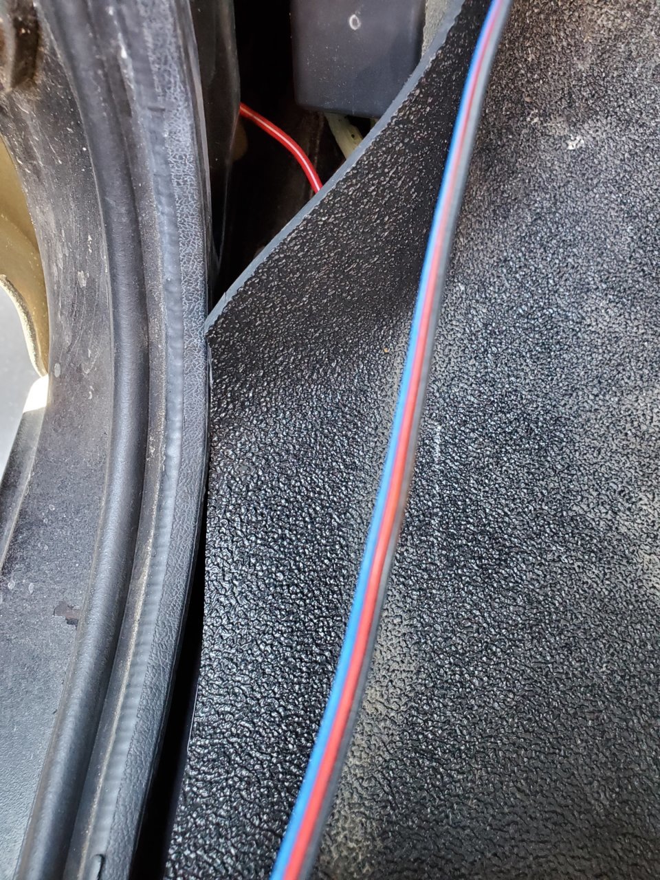

    The courtesy lights are just wired into the dome circuit. Keep in mind the dome circuit is constant hot 12V with a switched ground, therefore you need to have a separate ground wire just for the puddle lights that ties into that dome ground.

    Where did the blue wire tap into

    Was that for the running light (white light in the turn signal lamp)? I didn’t wire it up, but you could tap into the tail lamp illumination wire. That would also been below the door sill and run to the connector under the driver seat.

    Got the light working, blue was for the white light

    Posting this for future reference:
    Male clock connector part number (clock side): 90980–11012
    Female clock connector part number (truck side): 90980–11013

    I haven't had time to work on a kit, but I did make a thread about it: https://www.tacomaworld.com/threads/feeler-power-vent-windows.448620/
    I originally got the mirror shells from global rakuten, but that seems like it's not a thing anymore. They are for a hilux surf (Japanese 4Runner) and made by Revier.
