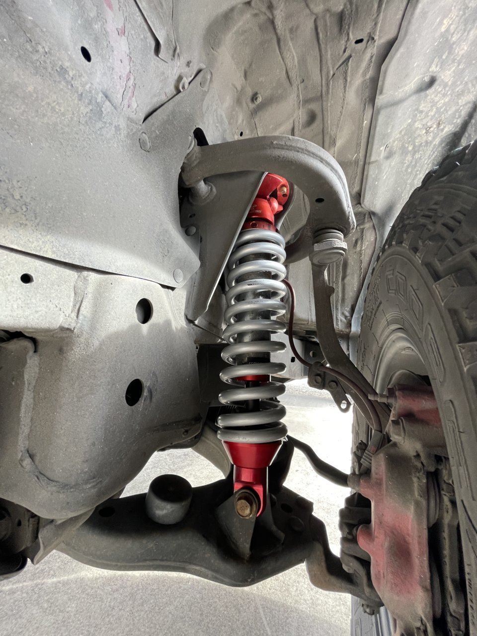

    8C30BC8F-C76C-4AC3-949F-D1388575DD73.jpg 5673410C-0A17-4F69-882C-E3910035AE22.jpg Had my 2.0 Sway-a-Way coilovers rebuilt by Brandin @Mynameisbrandin in New Braunfels. He changed the compression valving to make it softer for on-road driving. I also had him swap in 550# springs to replace the 650# ones that came on the SAWs.
    The results are amazing. For my truck with the 4cyl and no extra weight up front, 550# springs feel perfect. I didn’t lose any ride height with the preload set at the same spot. I did a lot of research and learned that stock Tacoma coils are somewhere in the 550-575# range. Ideally I would get 575, but no one seems to make that spring rate.

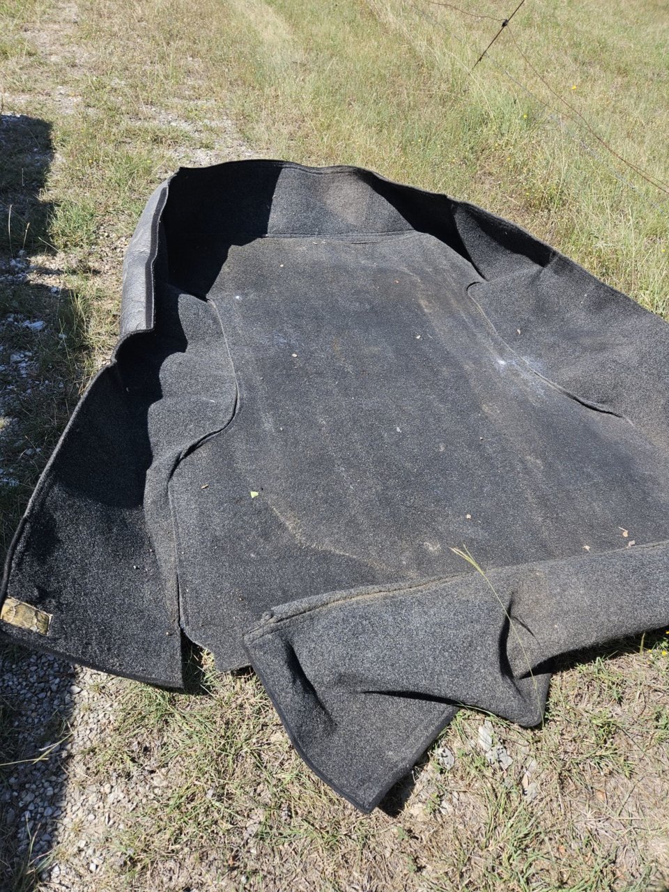

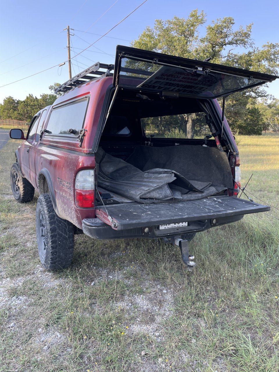

    Randomly scored a bedrug on Craigslist. I’ve been looking for one for years since they are discontinued. It’s dirty, but seemed to be in good condition. I’ll have to clean it up this weekend.

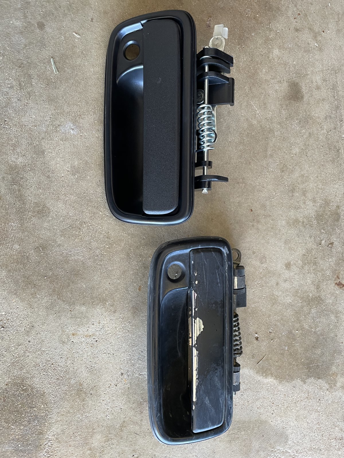

    Swapped out my aging and paint flaking OEM chrome door handles for T1A metal ones. The swap is pretty easy, just remove the door panel and (2) 10mm head bolts. There are 2 rod clips, one comes off easy like the inner door handle, the other one is nearly impossible to remove without breaking. The nice thing is the T1A new handles come with the plastic clip, so just destroy the original one.

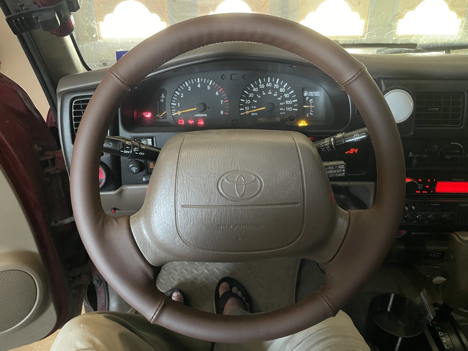

    My leather wheel skins steering wheel cover finally started falling apart. I decided to go with redlinegoods since they make a cover that goes over the spokes. I ordered their color samples and it seemed like saddle brown was the closest match. All the other tan colors were too light. I feel like it’s a closer match than the wheel skins. Also it’s less noticeable in person.

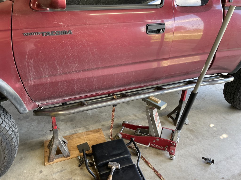

    I installed some 4XInnovations sliders a while ago. I don't ever plan on using them as sliders since I don't really go on trails. BUT, they work great as steps to get to the roof as well as preventing door dings from inconsiderate people in parking lots. I welded these with a Primweld TIG, which was definitely a challenge on the frame.
