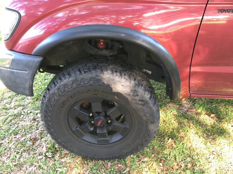

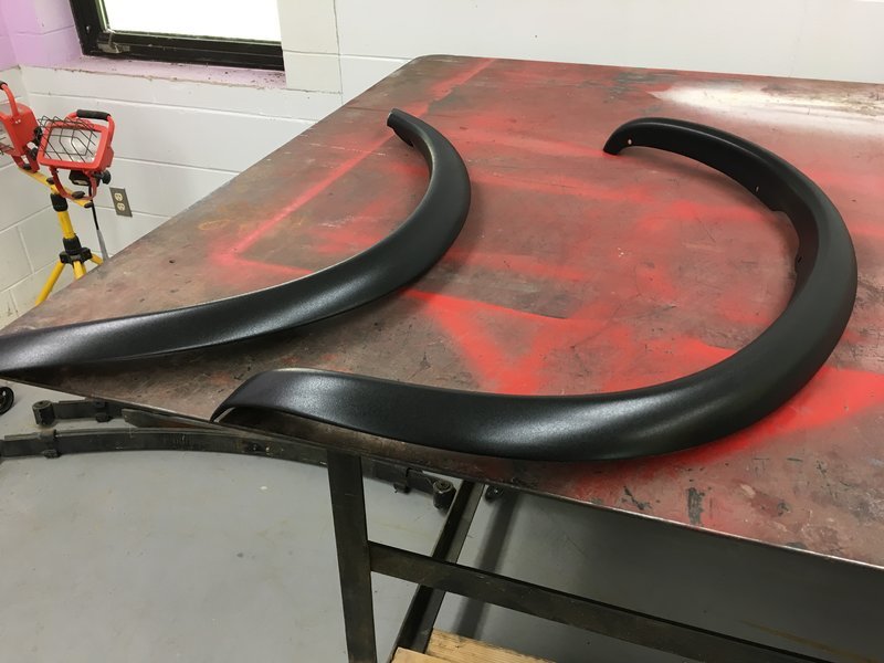

    Pulled the flares off today to spray them with some Rustoleum Truck Bed
    What I didn't take pictures of was the hours of sanding and scraping the old gaskets off to install new ones.

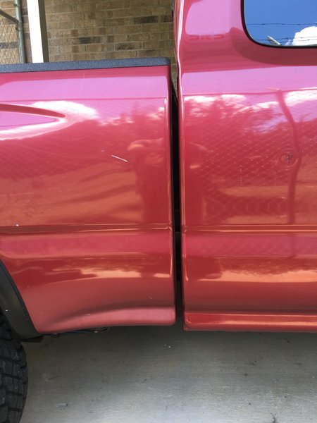

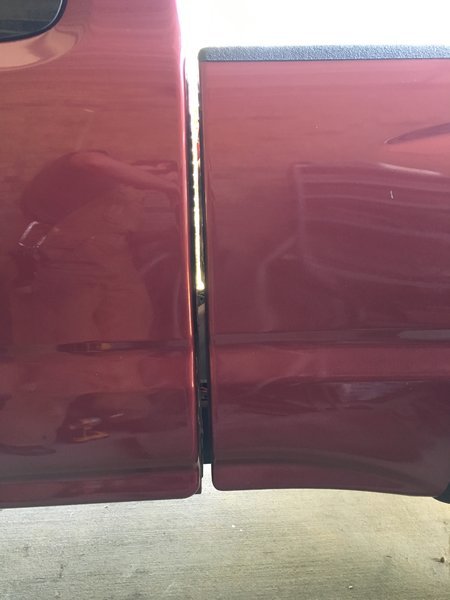

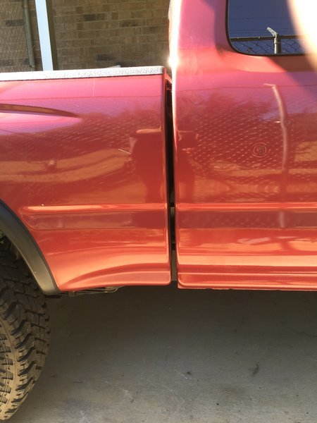

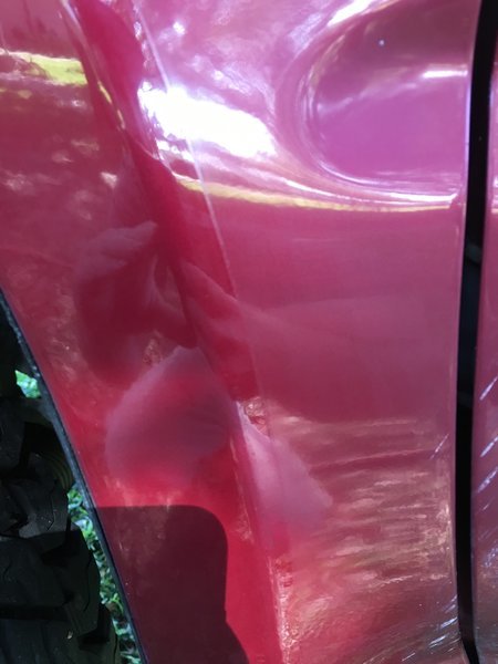

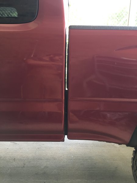

    Installed new Cab Mount Bushings today since my cab has been slowly sinking over the years. It was pretty straightforward. Make sure you read the directions that come with the Energy Suspension Kit. They are not exactly the same as the OEM ones in the way they go together.
    I got them from here: And followed this writeup: https://www.tacomaworld.com/threads/body-frame-mount-bushings-diy.407123/
    Driver side before and after
    Passenger side before and after
    And an overall shot
    opteron and Deathbysnusnu like this.
