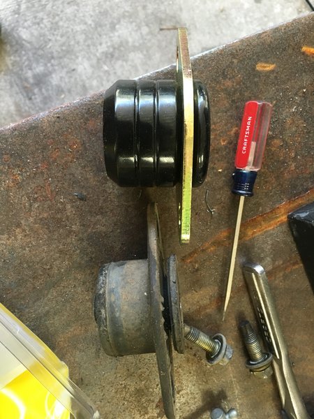

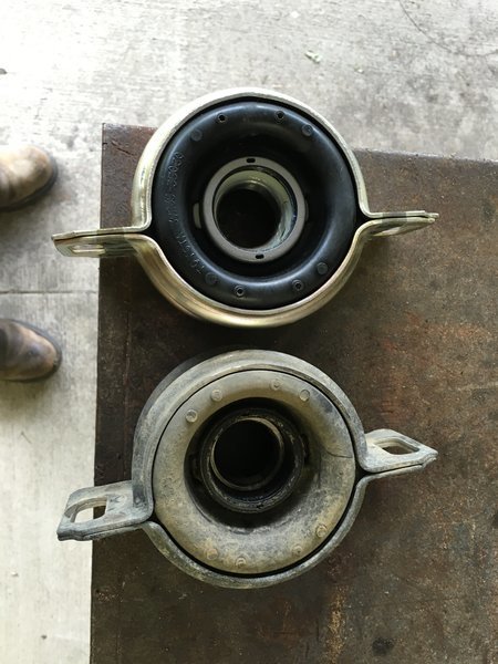

    Here is a comparison of new and old bushings. You can see there is nothing left on the top of the old one. I'm not sure what they are supposed to look like from the factory, but I'm guessing there is supposed to be more meat there.

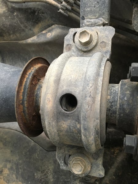

    Just replaced my drive shaft carrier bearing, also known as the center bearing.
    It was a lot easier than I was expecting. I didn't even remove the driveshaft or need a jaw puller. The old bearing slid right off.

    replaced mine too. do you still get vibrations around 50-60 because of your lift? i saw someone on here put spacers on the nuts to lower it, i did that and it definitely helped. highway is smooth as butter

    I never had vibes from my lift. I was just replacing it because I have a driveline noise. The sound did change but I think the Ujoints need replacing too. My truck is 2wd so it has the double cardon joint behind the carrier bearing. This allows for higher driveline angles.

    yeah i have the cardon joint also. i replaced joints and CB at the same time. also my drivers side tie rod was a little loose so that probably contributed to the highway shake.

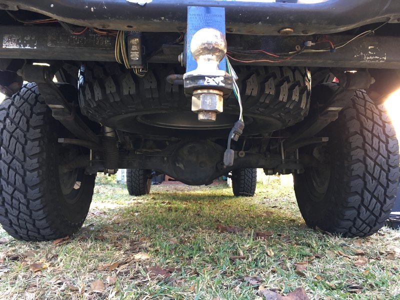

    After almost a year I finally found a cheap 255/85 to use as a spare. I got a Maxxis Bighorn on eBay for $75 shipped and an anthracite trd trail team fj wheel. Since it's going under the bed I don't really care that it's a different color.
    I had to modify the spare tire positioning brackets to get it to fit correctly. I ended up moving the passenger side bracket outward while leaving the driver side in place since the tire is originally offset to the driver side. This helped to position it directly in the center of the leaf springs. Earlier this year I dumped my exhaust before the axle so it wasn't an issue anymore. I also bend the driver side bracket in at the front and out at the rear. There really is not a lot of room between the axle, hitch, and leaf springs. I got the tire about 1/2" from the hitch and 1/2" from the axle. We will see if it hits under compression. It really doesn't hang that low either, maybe slightly below the stock hitch.

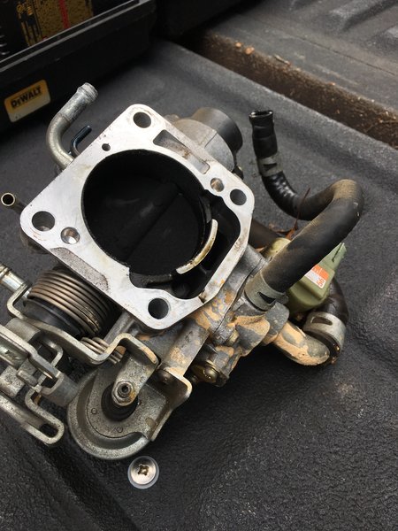

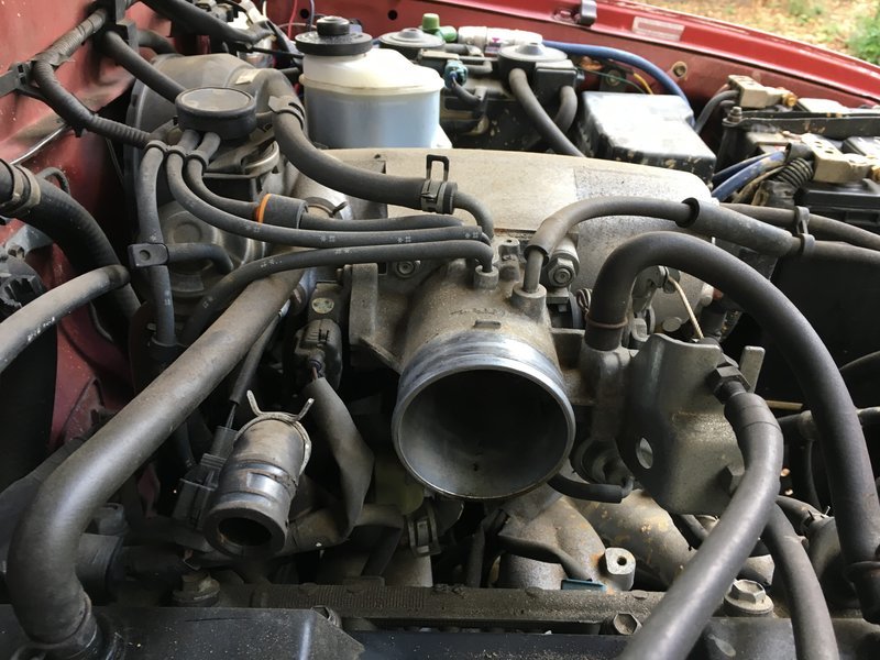

    I decided to clean my throttle body and idle air controller since my truck was idling low while in drive at a stop light. This would cause the truck to excessively vibrate.
    There was so much build up inside the intake that I could scrape off chunks with my finger nails.
    My truck now idles around 725 in drive with the brake on, and closer to 850 while in park.
