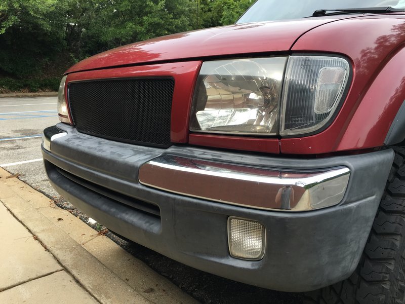

    I'm going to sell my old chrome one if you are interested. It definitely needs some work though.

    I was thinking 40 plus shipping, but let me get some close up photos of it first so you can see the condition. It would be a good candidate to sand and paint.

    Thanks. I would be planning to paint it black so that may work out well. Keep me posted

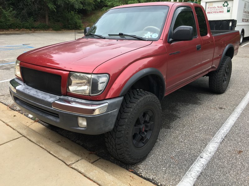

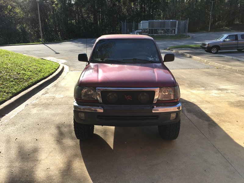

    Some more grille pics

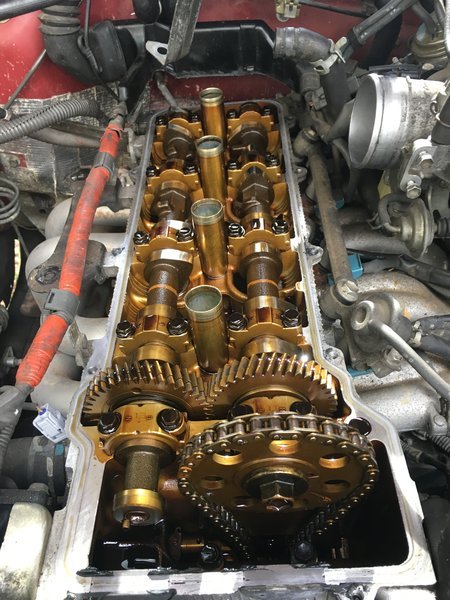

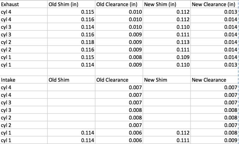

    Adjusted my valves today. Cylinder 4 at the back really kicked my ass. I basically had to do it blind and hope I got the little prop tool in the correct spot. It took me at least an hour just to get that last one.
    I used these tools
    Valve Tool: https://amzn.to/3S7ISrP
    Feeler Gauges: https://amzn.to/3IdyDgW
    Magnet: Pick set: Valve Tool: https://amzn.to/3KjnBJL
    Also I had a digital caliper so I could measure the old shims
    I replaced the valve cover bolts and "grommets" with new ones since I managed to snap 4 of the original ones the last time I had the cover off. Torque them to 53 in-lbs
    Bolt Flange 90080-10327 (10)
    Washer Seal 90210-07001 (10)

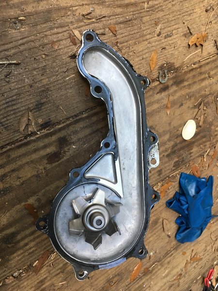

    Swapped out the water pump, thermostat, and flushed the coolant today. Toyota has the best designers...

    Looks like a shlong :rofl:
    Seriously though, how difficult was it to that job?

    It's not bad, just have to unbolt things. I think the hardest thing is getting the fan clutch off since you have to use a wrench (socket won't fit). I also degreased the whole front of the engine before I pulled the old one out so that I wouldn't get any nastiness in there. I followed this write up, even though its not a tacoma. http://www.toyotanation.com/forum/60-t-100-forum/381578-3rzfe-water-pump-replacement.html

    So after swapping the thermostat, water pump, and flushing the coolant, my truck operates around 185 degrees. Prior to this, it was running around 194. To me that is a big difference. I'm not sure if it was the coolant or thermostat that did it, but almost 10 degrees cooler sounds a lot better. The water pump I pulled out had no issues, I was just replacing it to fix a leaky gasket.
    To flush the coolant I drained the radiator, then the block, then removed the water pump. This got almost all of the old coolant out. Once everything was back together I filled it completely with distilled water and ran it up to temp with the heater on. I then drained the radiator and got about half the capacity of the system out (4qt). I then added Toyota Long Life (red stuff) and ran it up to temp again.

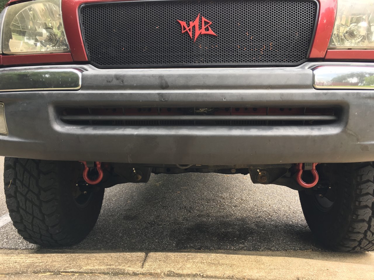

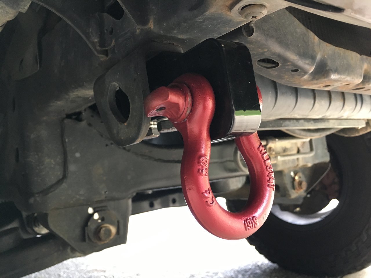

    Installed some 4crawler shackles!
