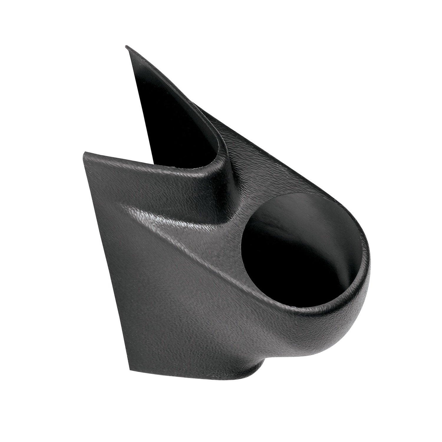

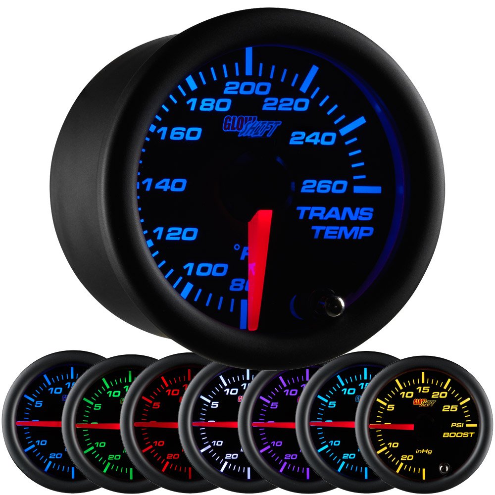

    I'm looking for some opinions on where to mount a transmission temperature gauge.
    I have already purchased this glow shift gauge: https://amzn.to/3YGnKLN
    I will set it to red to match the rest of my dash.
    I am trying to decide if I want to use a single gauge pillar pod:
    https://amzn.to/3IBrvwc
    Or cut a hole in my dash where the stock ECT switch (or clutch start cancel for manual) is located. I have measured this space and I should be able to cut a circle and conceal the square hole where the switch is. I would then move the ECT switch next to the locker switch. I edited this photo I found online to show the location I am talking about. I am not opposed to drilling into the dash at all, so don't let that deter your suggestions.
    I am honestly leaning towards putting it in the dash instead of the pod. I really don't like the look of the pod and it really makes it stick out.

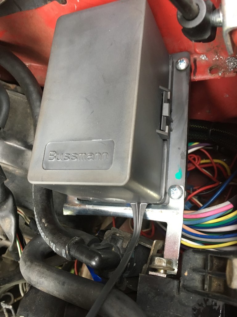

    Started making a mount for my new bussmann rtmr fuse block. I actually just cut and bent one of the mounts that comes with it. It bolts to the vsv on the evap canister. My vsv sensor mount is broken, but it should clear a new one. The back of the block mounts to the pinch weld on the firewall. It barely fits, but there is clearance for everything!

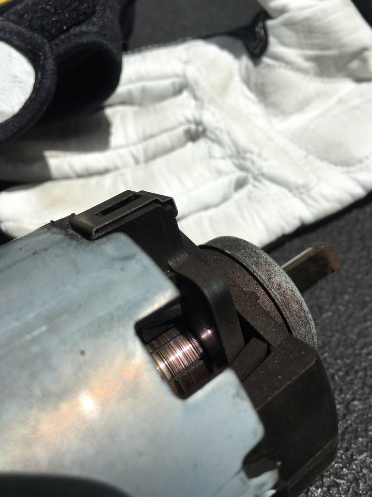

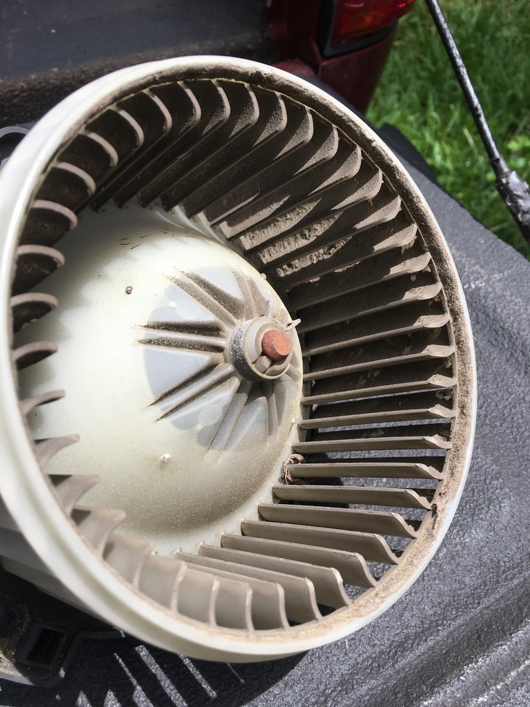

    Cleaned out my blower motor today. A piece of rubber that I had jammed between the windshield and dash had fallen into the motor and it sounded like it was farting. Also, you can see how filthy it was after 18 years.
    Also got a pic of the commutator on the motor. There are at least 1/16" deep grooves in it. I have never seen a motor commutator worn down like that. I'm surprised it still works perfectly.

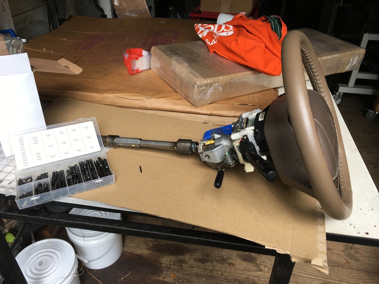

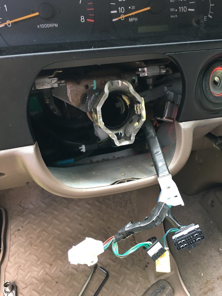

    Pulled my steering wheel and installed a roll pin to limit the play. Like everyone else says, I don't know why I didn't do this sooner. It's very easy and if I was going to do it again I could have the wheel out in 5 minutes.
    I took the truck for a drive and there is an immediate noticeable difference. I haven't had it on the hwy yet but I will see soon enough. I followed this post and I don't really have much to add to the process except BE CAREFUL DRILLING! I actually broke 2 drill bits in the shaft. I was able to drill from the other side and use a punch to push the broken bit out. I believe that the shaft was moving slightly when I was drilling which caused the bit to bind and break. I suggest a drillpress if you have one.
