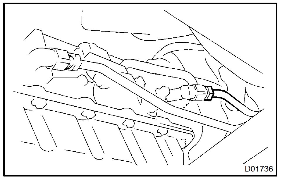

    So I've been looking into ways to install a transmission temperature sensor for an aftermarket gauge. The gauge I got uses an 1/8" NPT sensor, like most gauges.
    The A340E and A340F use a M14x1.5 fitting that is threaded into the side of the transmission for the output line.
    Part number 90407-16009
    The end that attaches to the hose uses an M14 inverted flare. Adapting to this would be quite difficult.
    https://www.aeroflowperformance.com/fittings/adapters/metric-extensions/af810-m14-02blk
    I actually ordered the stock 90 degree union and I am planning on drilling and tapping a hole directly into it. This will not affect the placement of any of the hoses. I am not sure if the wall of the stock fitting will be thick enough for this. If it is not I will try to braze an 1/8" NPT fitting onto it.
    EDIT: I was mistaken on the thread size for the transmission cooler lines. They are M14x1.5 and NOT M16. I confirmed this by measuring the 90 degree fitting I got from Toyota.

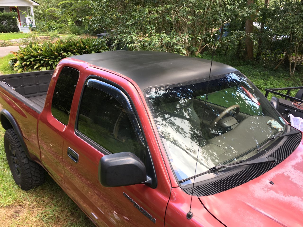

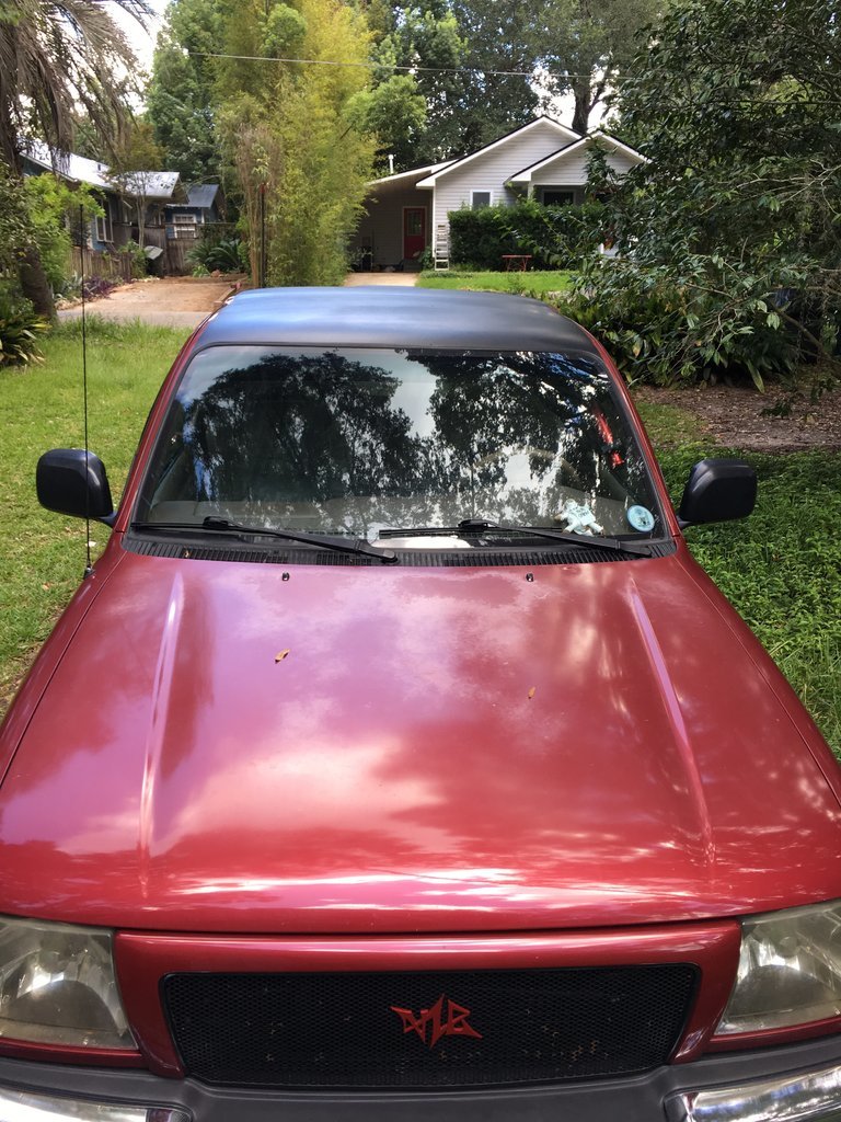

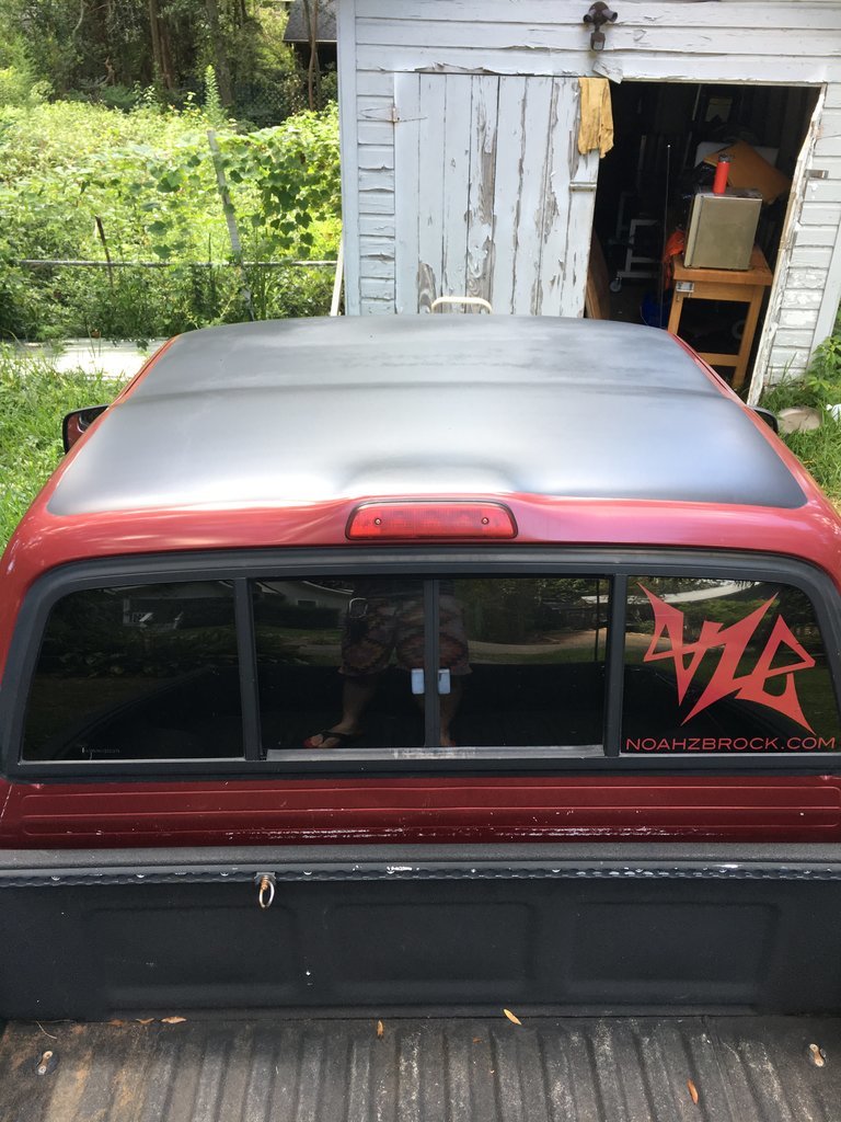

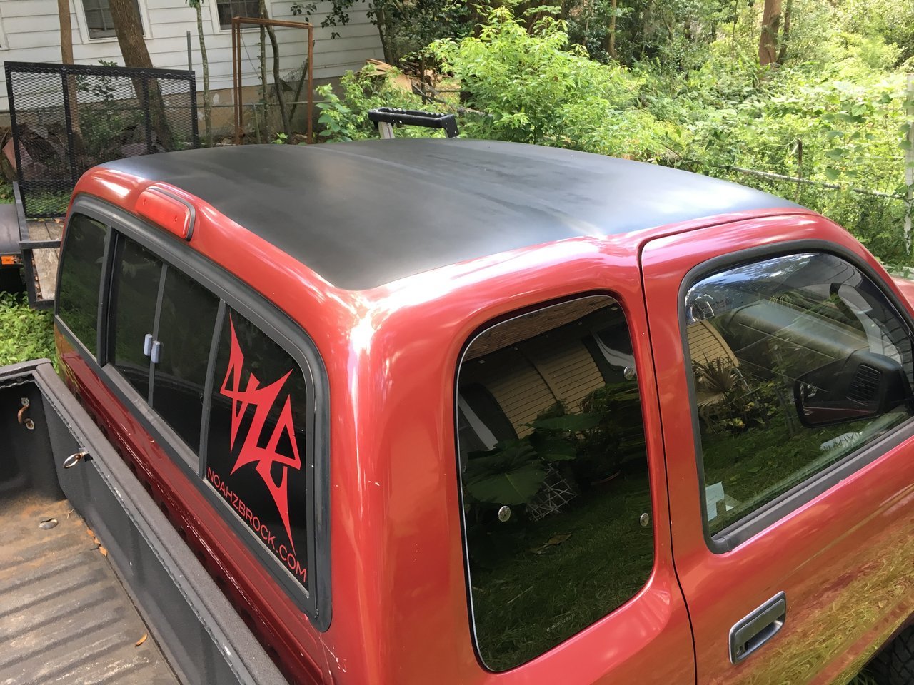

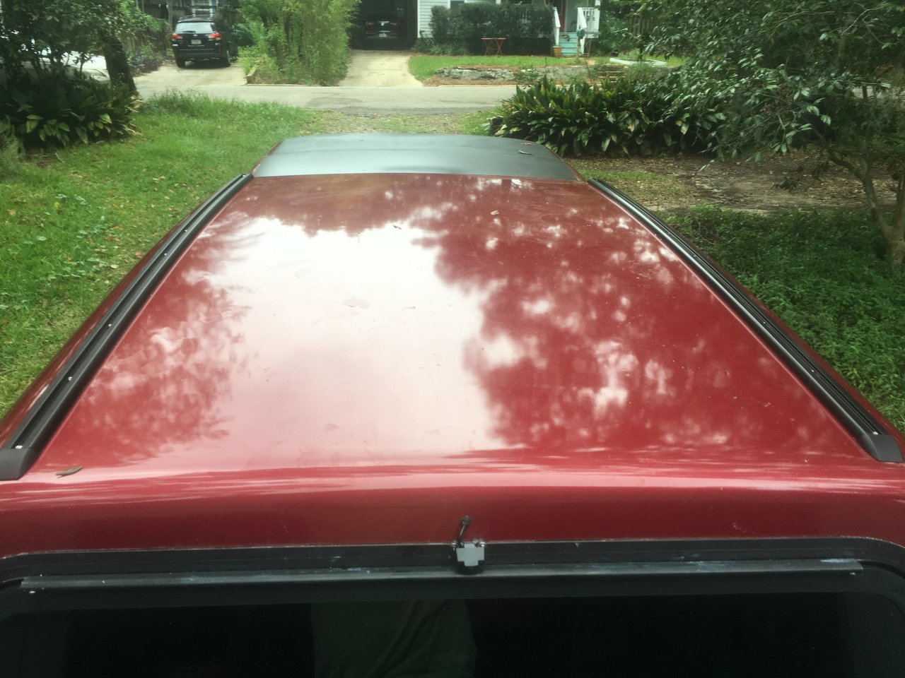

    Plasti-dipped my roof today. Well actually I used the duplicolor peel wrap of whatever it's called. I only did this because the clear coat has completely failed and I want to keep it from going any further. At some point I may get the roof repainted, but that is still undecided. It's not perfect, but I think it came out alright.
    5280 and Deathbysnusnu like this.

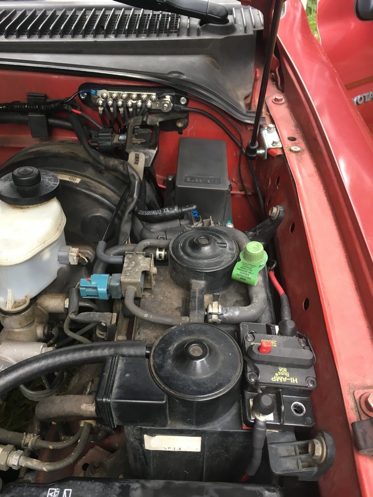

    Relocated my ECT switch next to the Diff lock switch. Also Installed a modified Land Cruiser Rear Heat Switch to use as an offload light switch. It will be trigger from the high beam but also be able to turn on whenever. To mount these in the dash I had to carefully cut the holes and then epoxy the mounts to the back that I got from the junkyard.

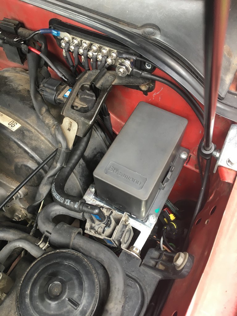

    Some shots my of Bussmann RTMR fuse/relay box.

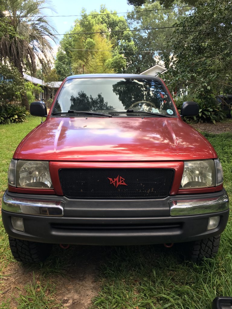

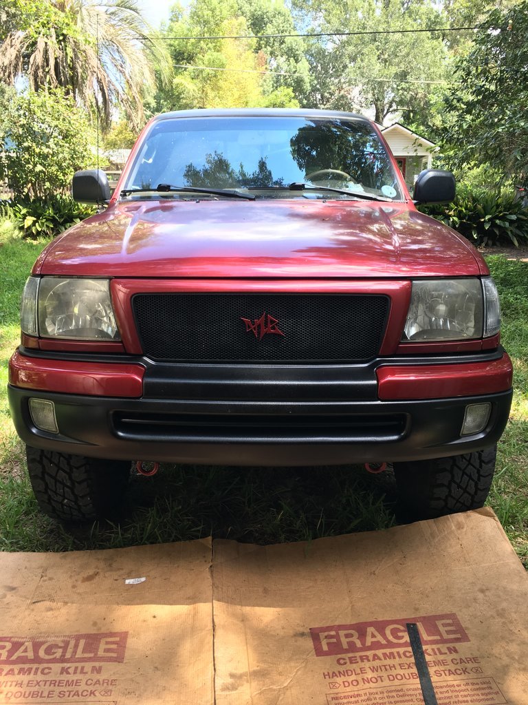

    Painted my front bumper chrome pieces to match the truck. I also coated the plastic part with rustoleum truck bed.
    I first sandblasted the chrome, then etching primer, then auto primer, then base color, then 2k spray max clear.
    For the plastic I scuffed with red scotch pad, adhesion promoter, auto primer, then truck bed.

    That bumper came out nice! I've debated painting the plastic section of mine with something as well now that it is so faded. I'll be curious to see how well that bed spray holds up. Nice WOrk

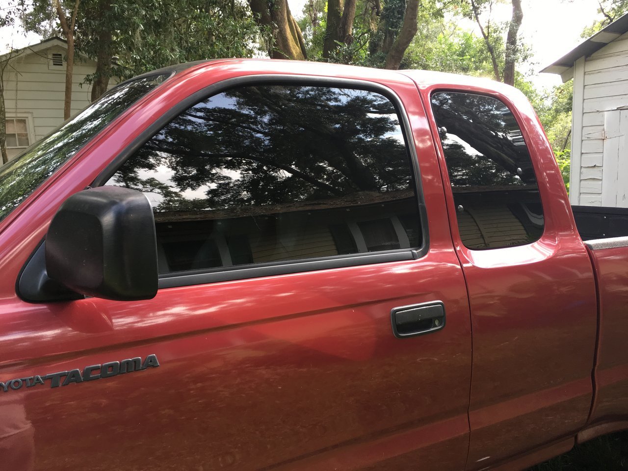

    Got my front two front windows re-tinted since the driver side delaminated on me.

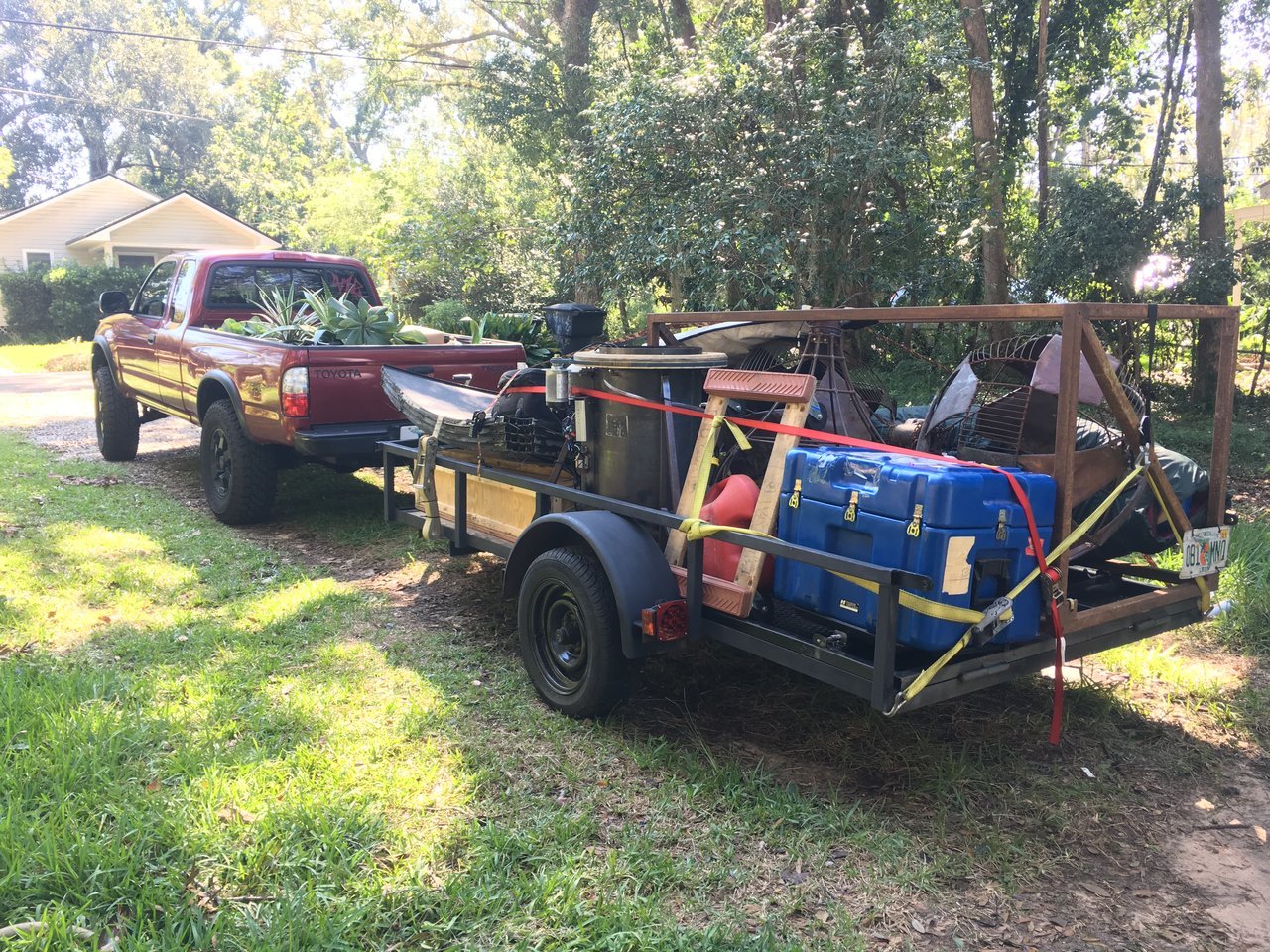

    Yesterday I towed my trailer from Tallahassee to Sarasota and got to test out the transmission cooler. I took US 19 most of the way since it is a little slower and less crazy. I was taking some of my sculptures and plants to my parents house since I will be moving to Philadelphia in November for a new job at University of the Arts.
    Once I was cruising around 65-70 in lockup, the temperature would level out around 182 degrees. This is pretty close to my coolant temperature, so that makes sense. The highest it ever got was 200 in stop and go traffic in the towns on the route. Keep in mind this temperature is at the outlet from the torque converter, so it should be the absolute hottest.
    The truck did great towing the load and didn't struggle even going up the skyway in St. Pete. And I even got 18 MPG which I couldn't believe. Normally I would get 21-22 on the highway.

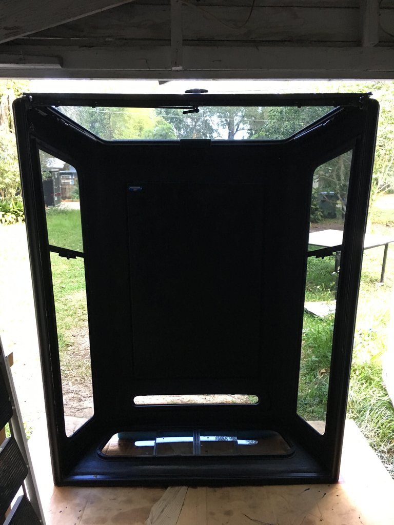

    Got this ARE MX Series truck cap/topper in North Port for pretty cheap. It's made for a regular cab so the curve doesn't match, but it doesn't really bother me that much. I just cleaned all the windows so I can see a little better out of the back. I may try to find another cheap cap with windoors to see if I could swap them out.
