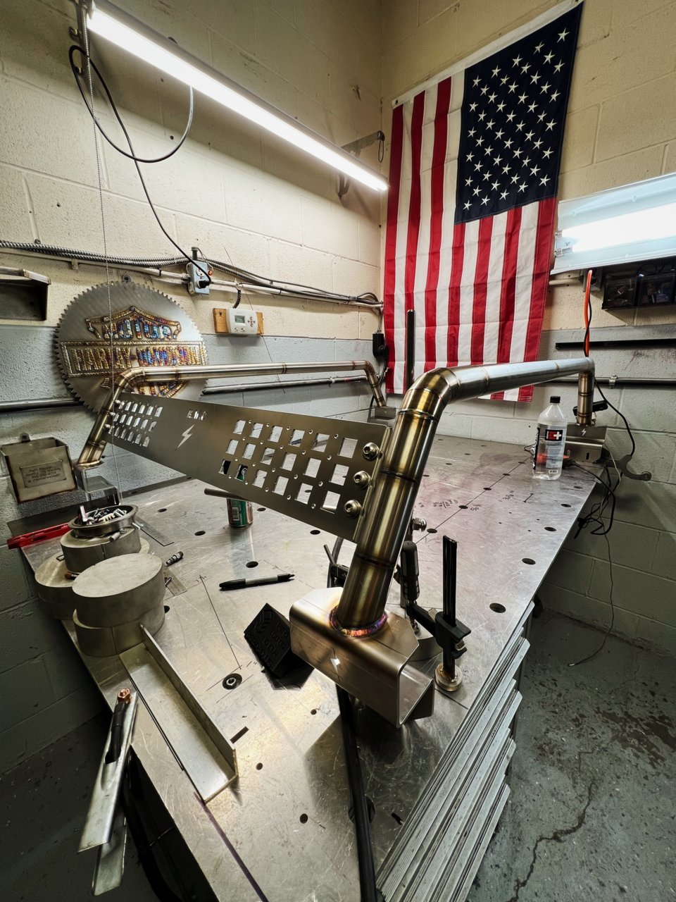

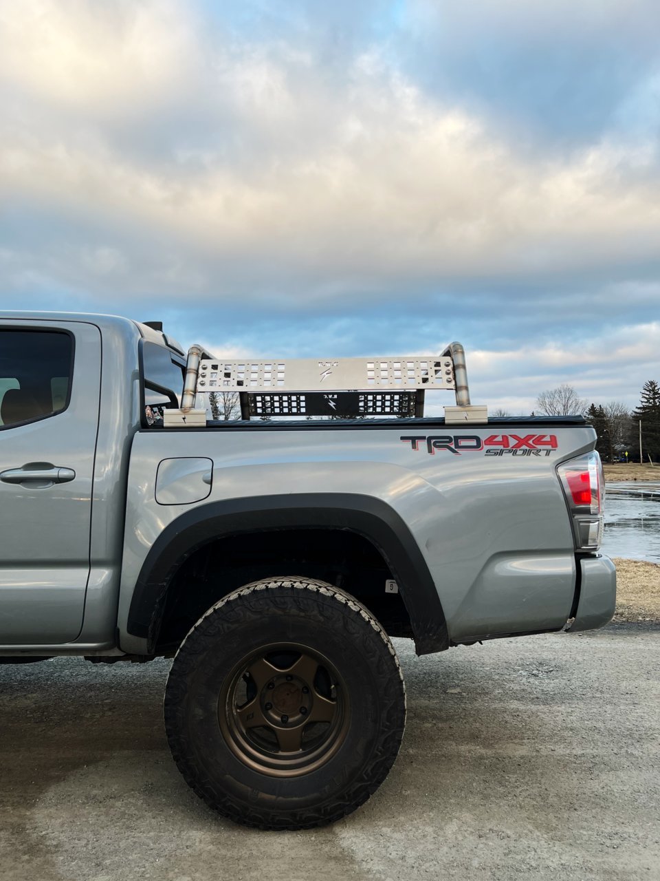

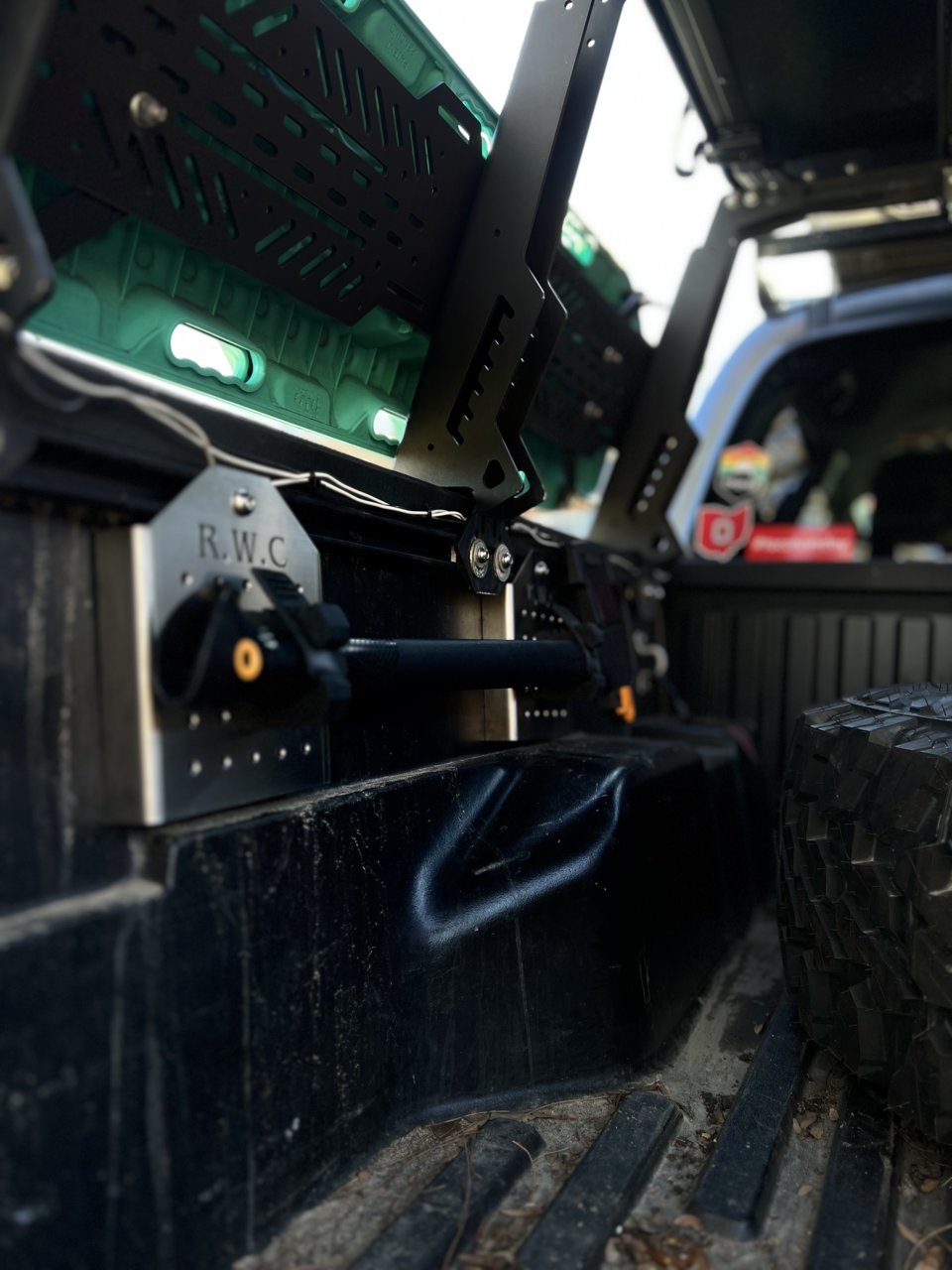

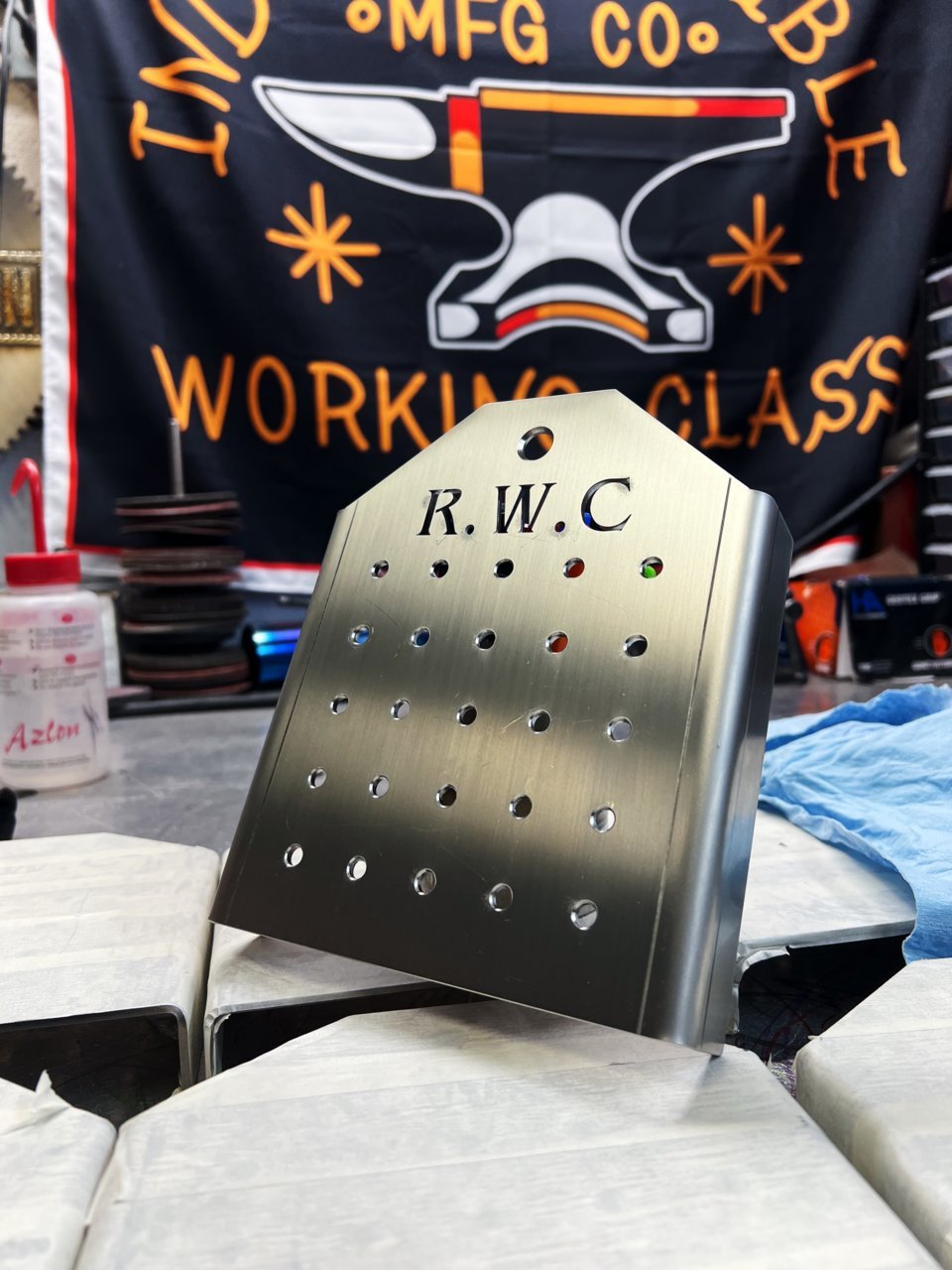

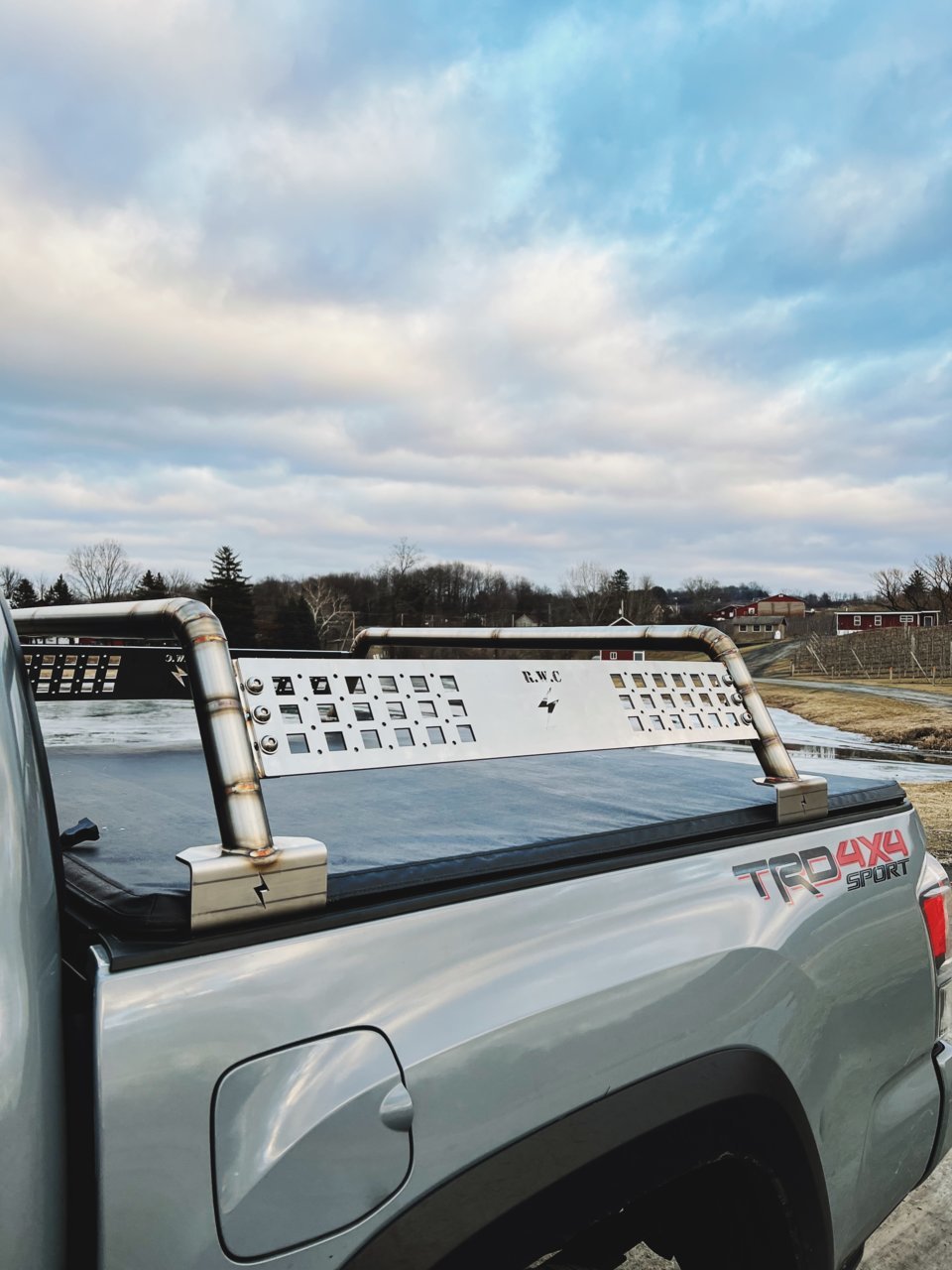

    been slowly chipping away at this bed rack project utilizing some scrap 2” tubing i had from some car projects. i had the tonneau compatible brackets made from 7 gauge and the side panels and mounting brackets made from 1/4”. all designed by me on a couple pieces of cardboard and converted to a dxf. pie cut bends serve no purpose other than to look cool and get some practice! everything is 304 stainless steel. also made some stainless modular bed rail mounting plates! bed stiffeners up next. what do you guys think of the raw look? going to make a second version in mild steel or aluminum so I can powder coat it, it’d be a sin to powder over the raw stainless.

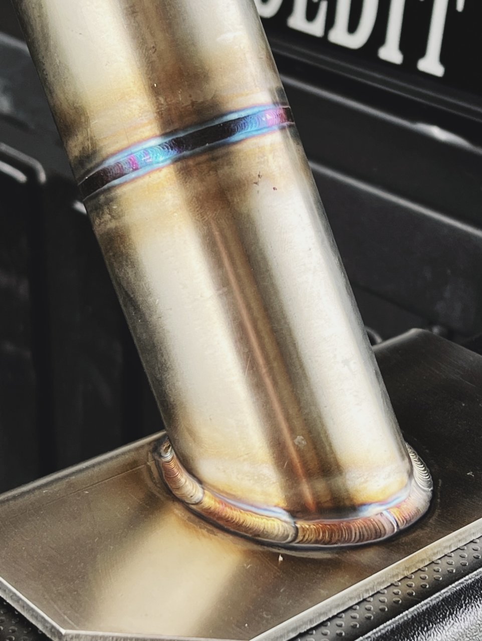

    Those welds dude !! That’s awesome! I’d leave it raw for sure

    Wow! Incredible welds! Yeahhhh I wouldn’t powder coat that either haha

    Why so many joints?

    Buttery welds

    In OP’s post he said this
    “pie cut bends serve no purpose other than to look cool and get some practice”
    I wondered the same thing at first and then read the whole post. I think it looks pretty dope.
