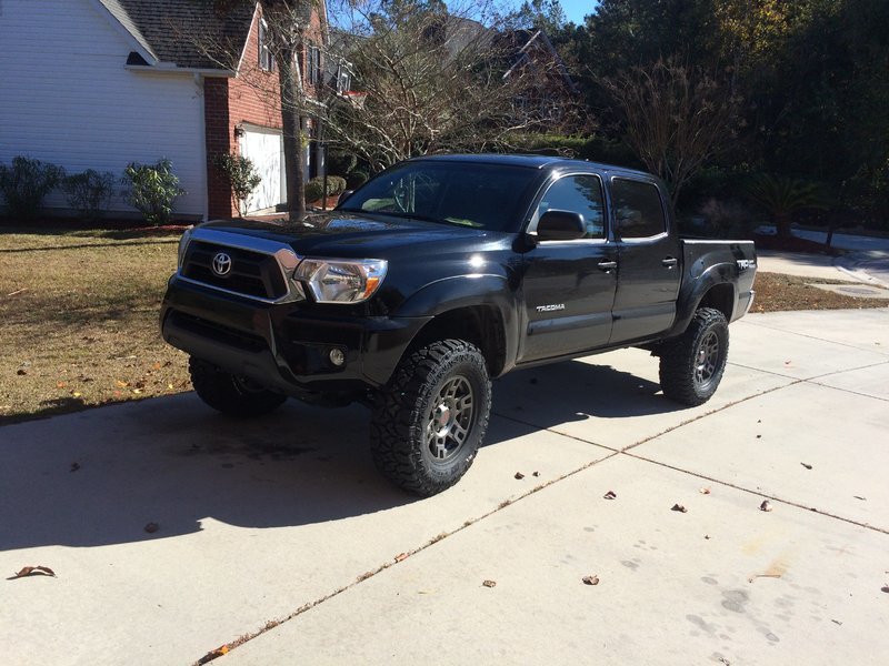

    I bought the truck used in November 2014 with 13k miles from Harmony motors in Raleigh NC. The PO already put a 3" ToyTec spacer lift kit with 1.5" blocks and Deaver AAL's in the rear.
    Right away I was tired of the small tires. So a week later I installed some 285/75/17 Fierce Attitude M/T's.
    My wife (then fiance) bought me an early christmas present, some N-fab step bars (she even installed them)
    I drove the truck like this for about a year and was just loving life. That's when I started digging around TW and found my first easy mod. The fog lights anytime mod. That was pretty straight forward and I like how it made the truck look.

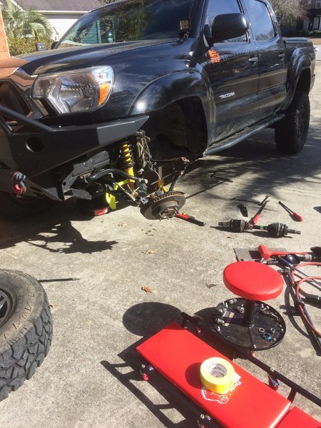

    Pulled my driver side CV out today to replace the inner boot. Took about an hour and a half and a lot of :censored: to get it done in the driveway without a lift or shop press. Get it all buttoned back up and notice that the boot is twisted :frusty:. I need to cut the outer clamp off and twist it back into place. I didn't take any pictures because my hands were covered in grease and gear oil. I then started to get the dreaded oscillating hum from a failing diff needle bearing. Brought it to the dealer and they "couldn't hear the noise" so I said that i'll bring it back when it destroys itself and they can replace more parts... Or I'll just do the ECGS bushing and never worry about it for as long as I own the truck.
