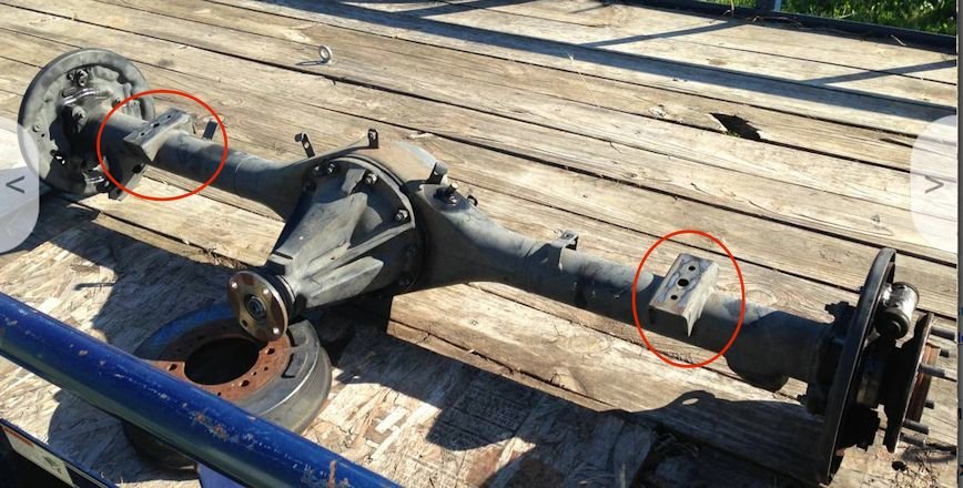

    connected to just the springs, axle wrap bends the springs while the axle is wrapping up
    in your pic the axle can twist as much as torque and physical stretch of the springs
    allow.
    to stop wrap on a leaf spring system, you need a single or double bar setup
    on the axle tube or pumpkin itself

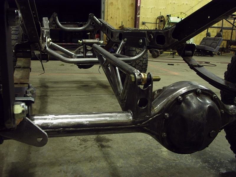

    it can reduce it by squeezing the springs harder. if the ubolts are loose you'll
    get a ton of wrap. in fact, 100% limit wrap if they are really loose. but only tighten to spec do not overtighten
    anyhow, all leaf spring system have some wrap, unless you do stuff like this

    As others said, tightening U-bolts isn't going to do anything for axle wrap (unless the U-bolts are already loose!)
    As a cheap/easy band-aid fix, you can take a couple square U-bolts/steel plate and install them on the springs in front of where the axle mounts.
    Look at post #10 of this thread:
    https://www.tacomaworld.com/threads/goodbye-axle-wrap-mod.108316/
    I did this many years ago on my 2004 Taco. It works moderately well and I don't notice nearly as much axle wrap as I used to. It does limit the flex of the springs a bit and makes for a harsher ride farther forward you place them.
    To completely eliminate axle wrap you need a 3 or 4 bar or similar linkage setup as illustrated above. But IMO if you go that route, you might as well just go full on 4 bar with coilovers... :)
