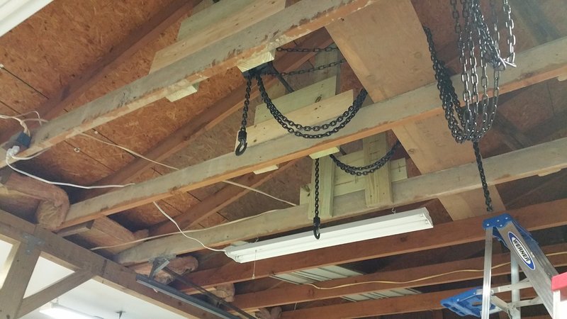

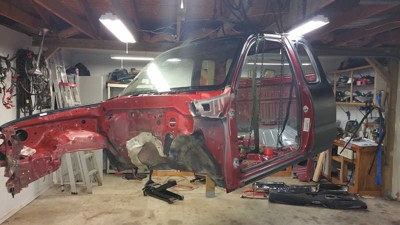

    If you have a garage with an attic space, throw some 2x6 across joist and drop 4 eyelets thru the ceiling. Sling the cab from it. :cool:
    GQ7227 and Wyoming09 like this.

    Really? I've seen it done a few times with a full size Chevy pickup cab stripped. They laid 2x6's across about 8 joist/truss's so the weight was spread out. You figure a 200 lb man can stand on one joist/truss with no problem.

    That's kind of what I did out in my shop with block and tackles. Beefed up the joist and rafters first though. Lifts bed and body off pretty easy.
