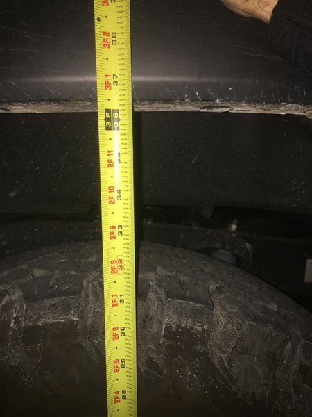

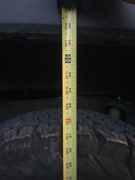

  17. Dec 21, 2016 at 8:03 AM
    #17
    baileybrandon
    baileybrandon 2016 DCSB OR - MGM -
    Apr 26, 2016
    #185345
    725
    Bailey
    Tennessee
    2016 Tacoma TRD Off Road Double Cab
    i am having the same issue. never notice it and this is with an 1/8th of a tank.

    "taco lean" my friend. everyone has it.
  19. Dec 21, 2016 at 8:12 AM
    #19
    Hail
    Hail Middle Age Crazy Member
    Oct 17, 2016
    #199959
    110
    Tomball, TX
    2016 Inferno TRD Sport 4X4
    My new 2016 is exactly the same measurements as yours. My F150 never did this full or empty.
    baileybrandon[QUOTED] likes this.
  20. Dec 21, 2016 at 8:14 AM
    #20
    baileybrandon
    Apr 26, 2016
    #185345
    725
    Bailey
    Tennessee
    everyone says its normal, but for a 6 month old truck? seems like some BS to me. my GMC never did this either
