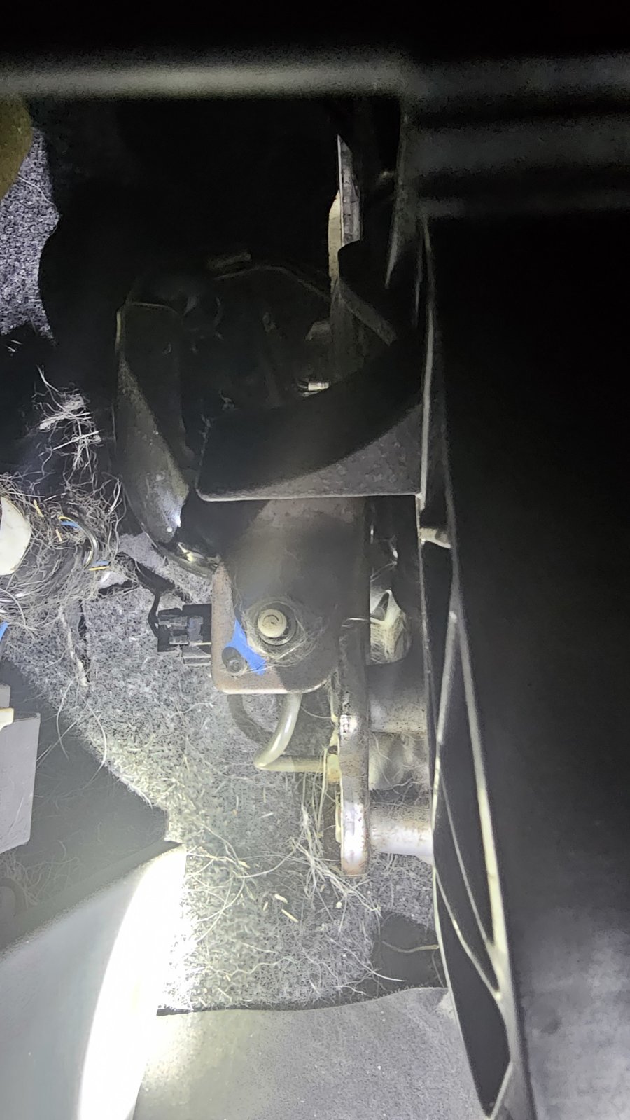

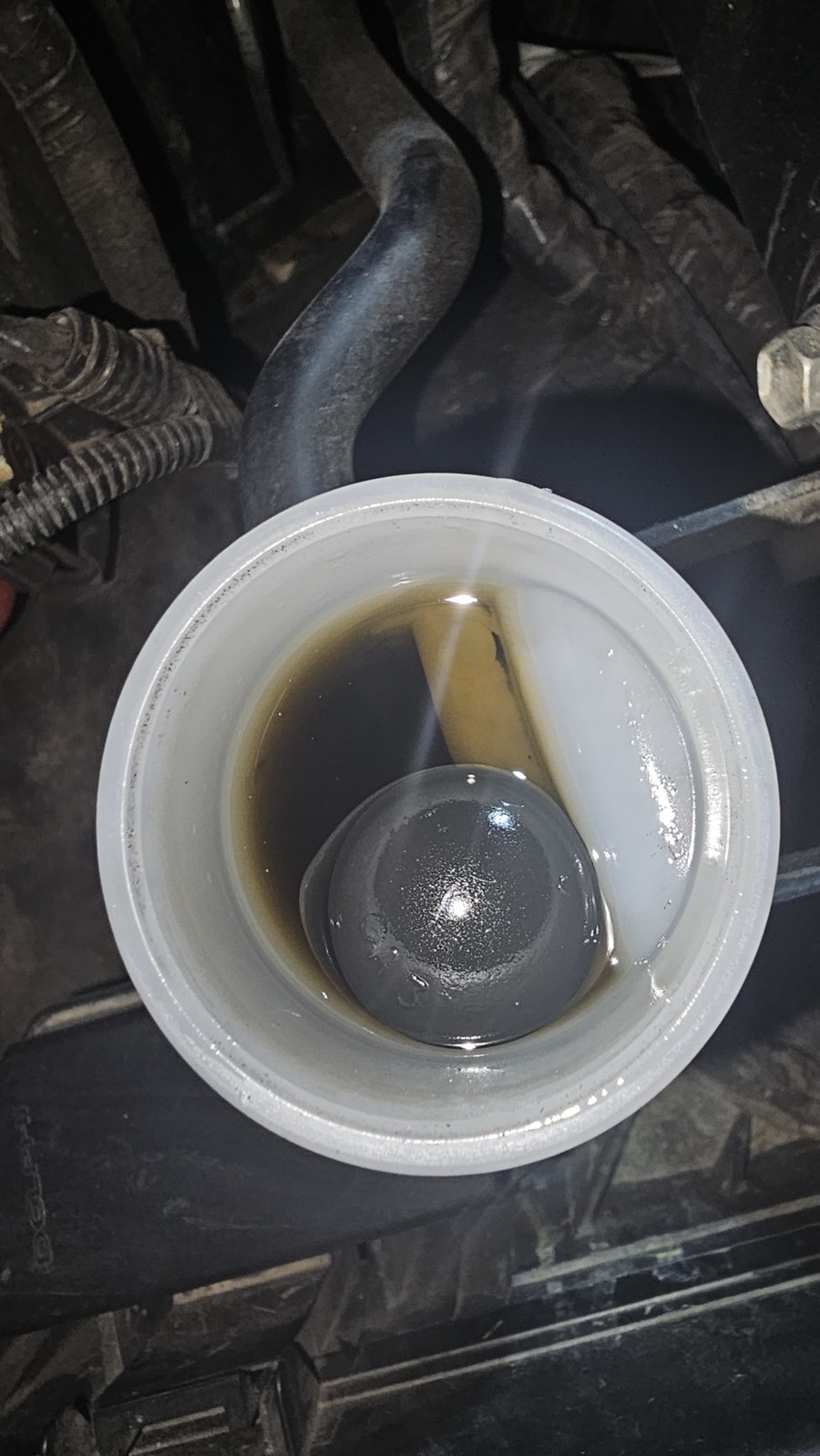

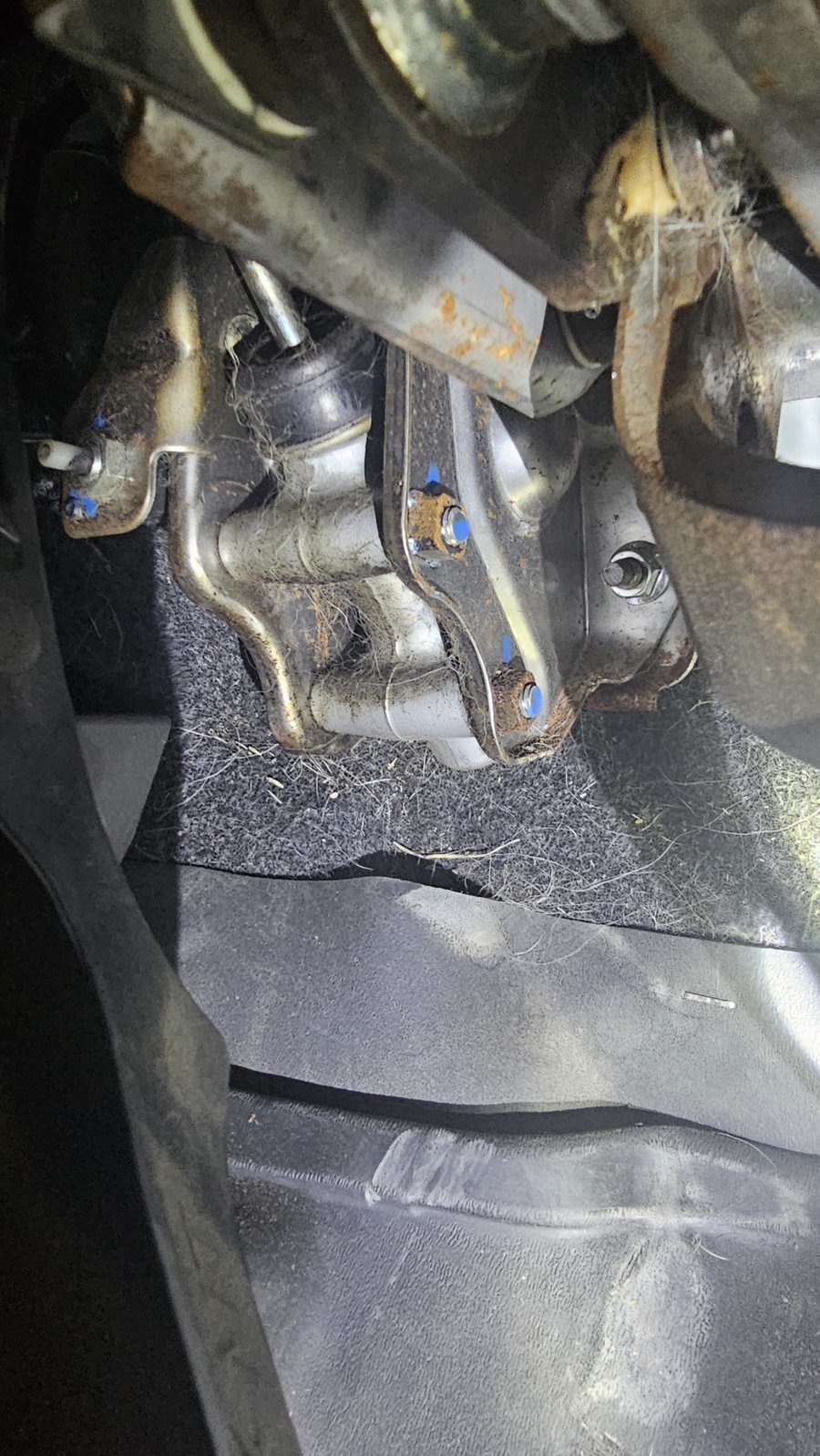

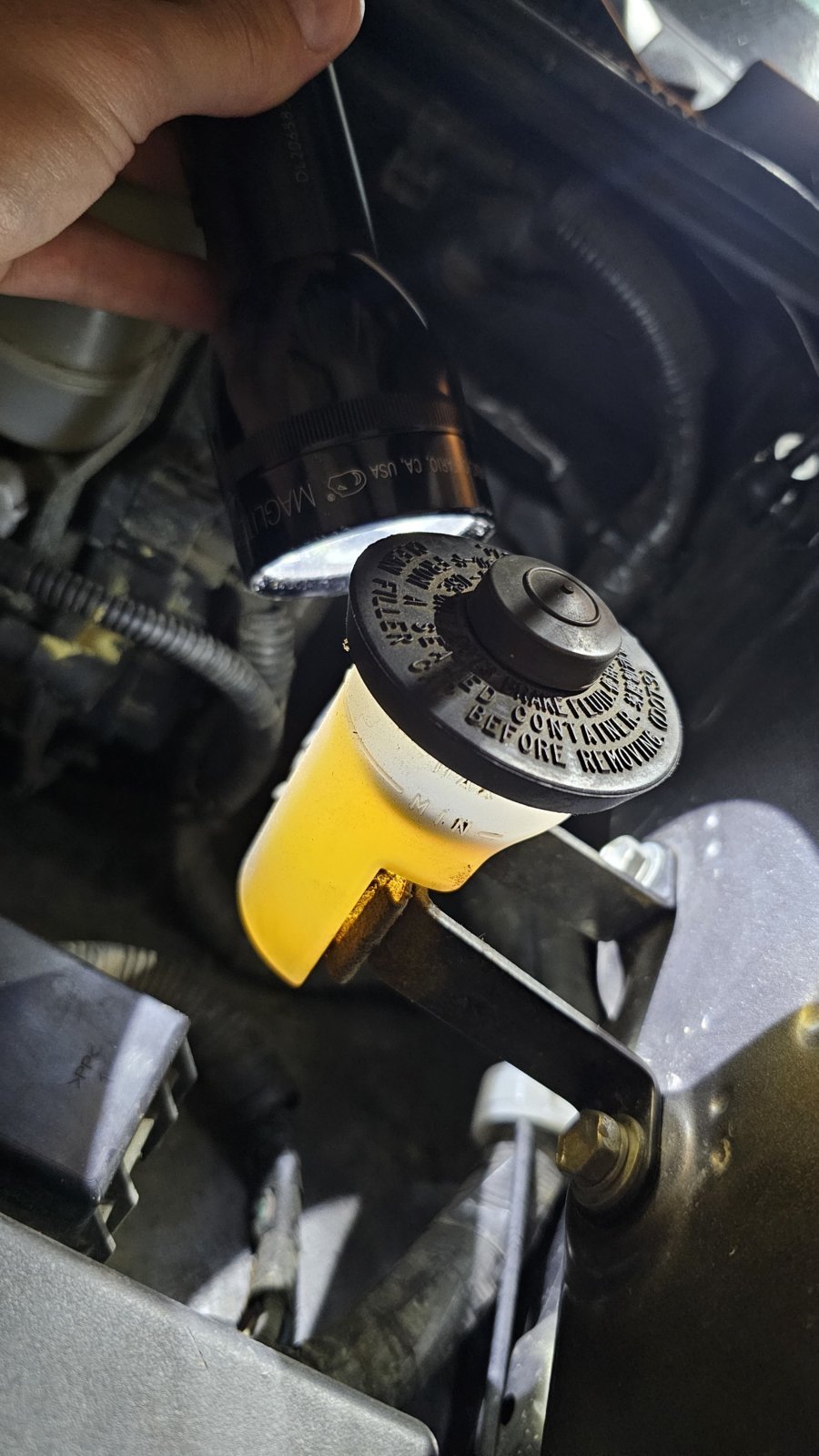

    So I have the metal master. I now recall taking it in to have Toyota do the TSB on it about a year into owning it. Yes I have dogs.
    I'm adding images here of it along with the reservoir

    aFe CAI Momentum GT Power Package, aFe POWER 76mm Throttle Body, aFe headers, aFe Y-Pipe, TRD Exhaust, VFTune, LCEngineering Dual Comp Clutch - Kevlar, Tilton 6000 Series HRB, URD quickshift, Icon Stage II, Icon Delta Joint UCAs, ECGS bushing, Cooper Discoverer at3 255/75/r17 115T, FN f(x) Pro 17" Matte Black, Ice Gray Katzkin, RCI front skid, Optima Yellow Battery, StopTech Sport Slotted Cryo rotors w/ TRD Brake Pads, Morimoto XB HYBRID LED HEADLIGHTS AMBER DRL, Anzo L Bar Taillights, BAKFlip MX4, 3rd Gen Side Decals, Plasti Dip badges, Cab LEDs, redline hood struts
    I still think it's something to do with the CM throwout bearing and possibly even my URD clutch and resurfaced flywheel.. combo = dog shit pile

    Hey Brandon. Yes I am. RC62F kits are in stock and new material for RA60F kits is on the way.
    Your fluid is quite dirty looking. Does the level go down? If there aren't any leaks around the truck for contamination to work it's way back up I'd guess that something is degrading on the inside.

    @Kasbien, I don't really ever see the level drop. Right now I think it's the lowest I have seen it though. I'll be taking it to my brother in law in the next few days or so so he can do exactly what @TacoTuesday1 calls out. Pressure bleed and adjust the pedal first before cracking anything open. I've debated going back to oem with fork again and maybe URD bearing. I wish I could see more feedback on the Tilton before jumping that route, but I might. Just depends on what he finds I guess.

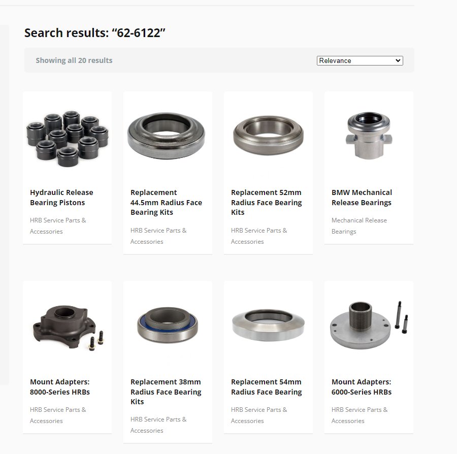

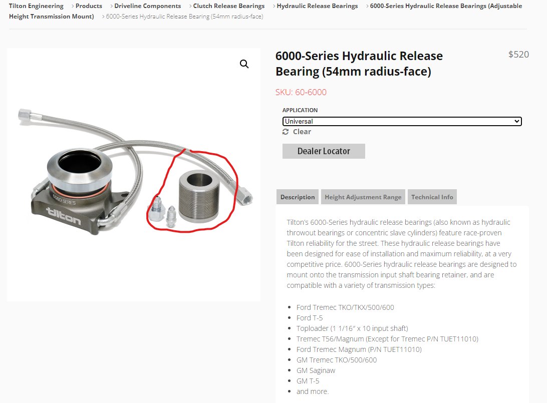

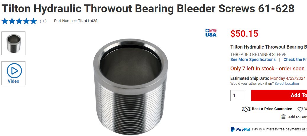

    hey @Kasbien @BillDaCat8 - When I search for either 60-612 or 62-6122 it provides multiple results (seen below)
    am I supposed to be looking at this HRB 6000 series below?
    with that said ive also highlighted parts above that look to be called out separately on the pdf.

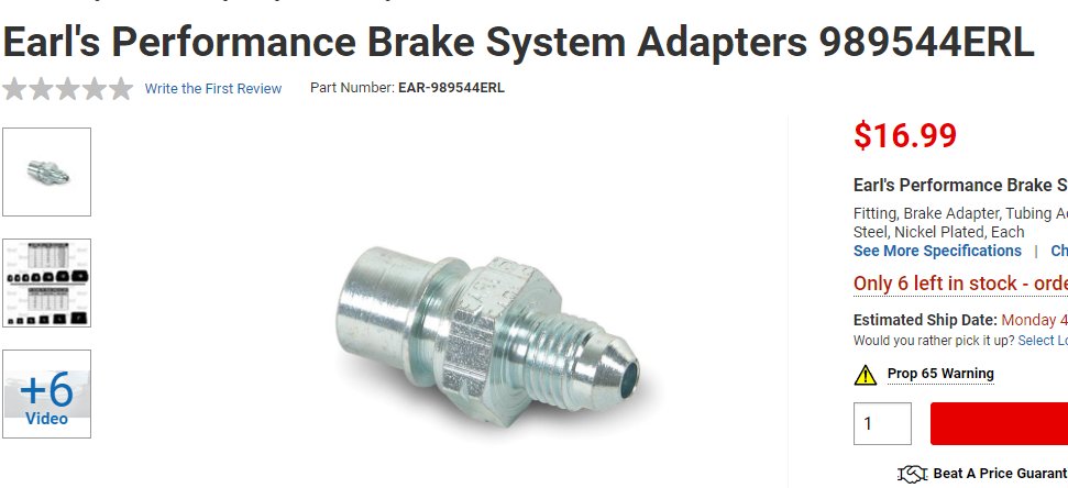

    is this the same hrb bleeder screw?
    and is this earl adapter 989544ERL similar?
    thanks guys, I just want to make sure im buying the right parts before stuff arrives and its all wrong
