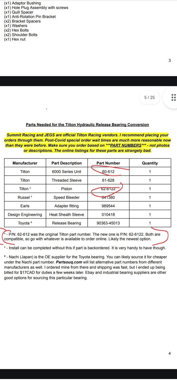

    Screenshot_20240420_171821_Drive.jpg Hey @BillDaCat8 , I really appreciate you guys following up on this. I see there are links for both 60-612 and 62-6122 and @Kasbien calls out to buy just one or the other. I'm looking to verify if both are needed or if they are both the same piston and only one needs to be purchased. 62-6122 is MUCH cheaper so that is what has me thrown off. I'll obviously go with that one instead of 60-612 $246.50 if only one or the other is needed. Thanks again

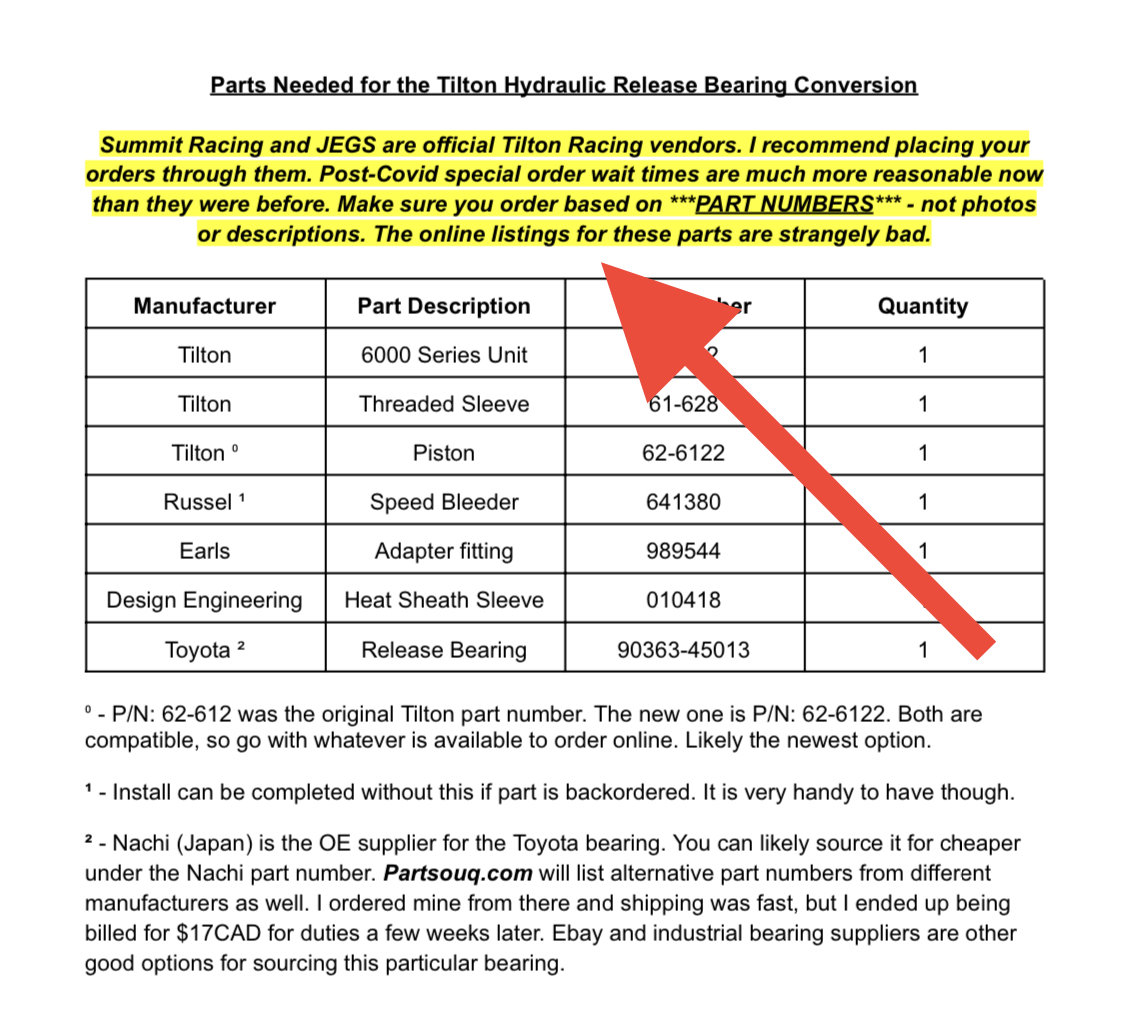

    Pop rivets and JB Weld.
    60-612 is for the whole Tilton unit.
    62-6122 is for the Tilton piston.
    You require one of each. Part numbers are similar but the parts are very different.
