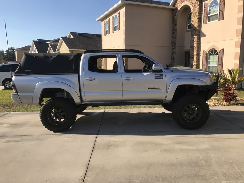

    1997 t4r has super duty axles, 5.13s locked front and rear. 3 link front with 14" kings. Rear 63s.
    63s with out the overload give 3" I'm running the overload which is about 7/8" and I have a 2inch longer shackle in order to try and get the ass end up

    Oh ok. So you're roughly 6"?
    Looks pretty level.

    It squats haha. Have a 2" longer shackle on the way which should give me 1" of lift hope that helps out the bro lean

    Side profile pic bro lean?

    Yes. This one. Driveway makes it look worse. About 1.5" in the back

    That doesnt look bad at all!!
    I know you tow your boat and stuff tho.
