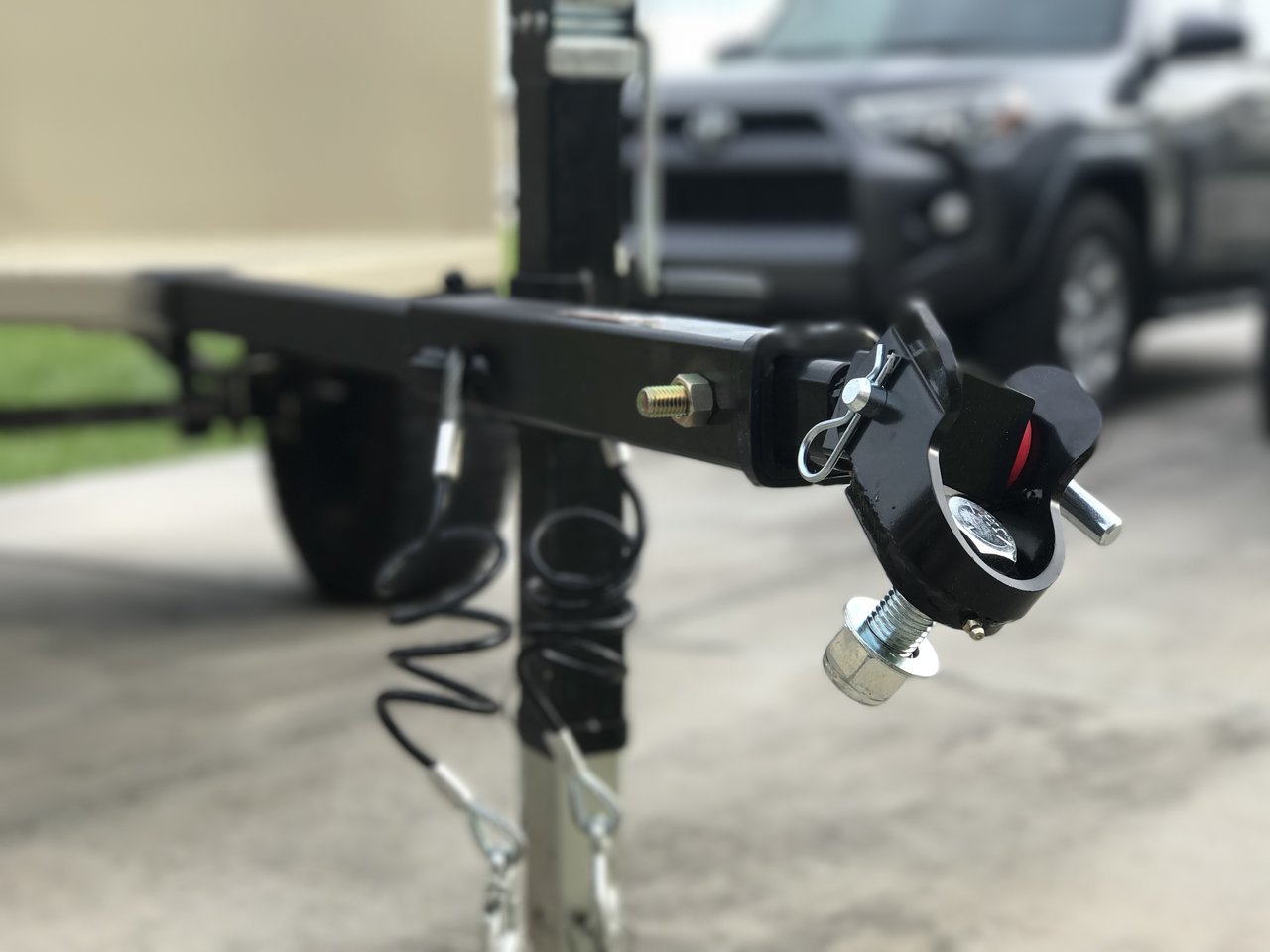

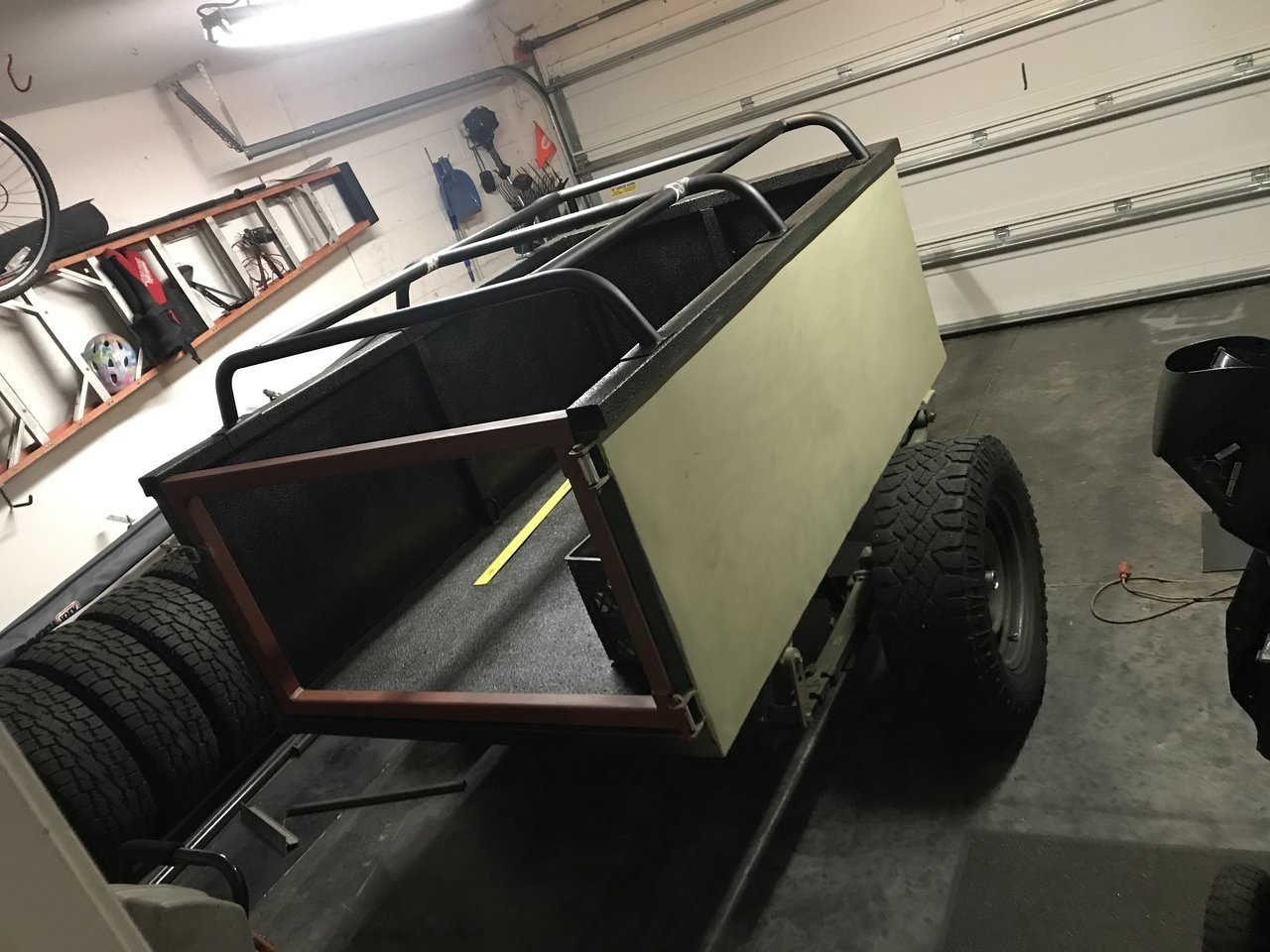

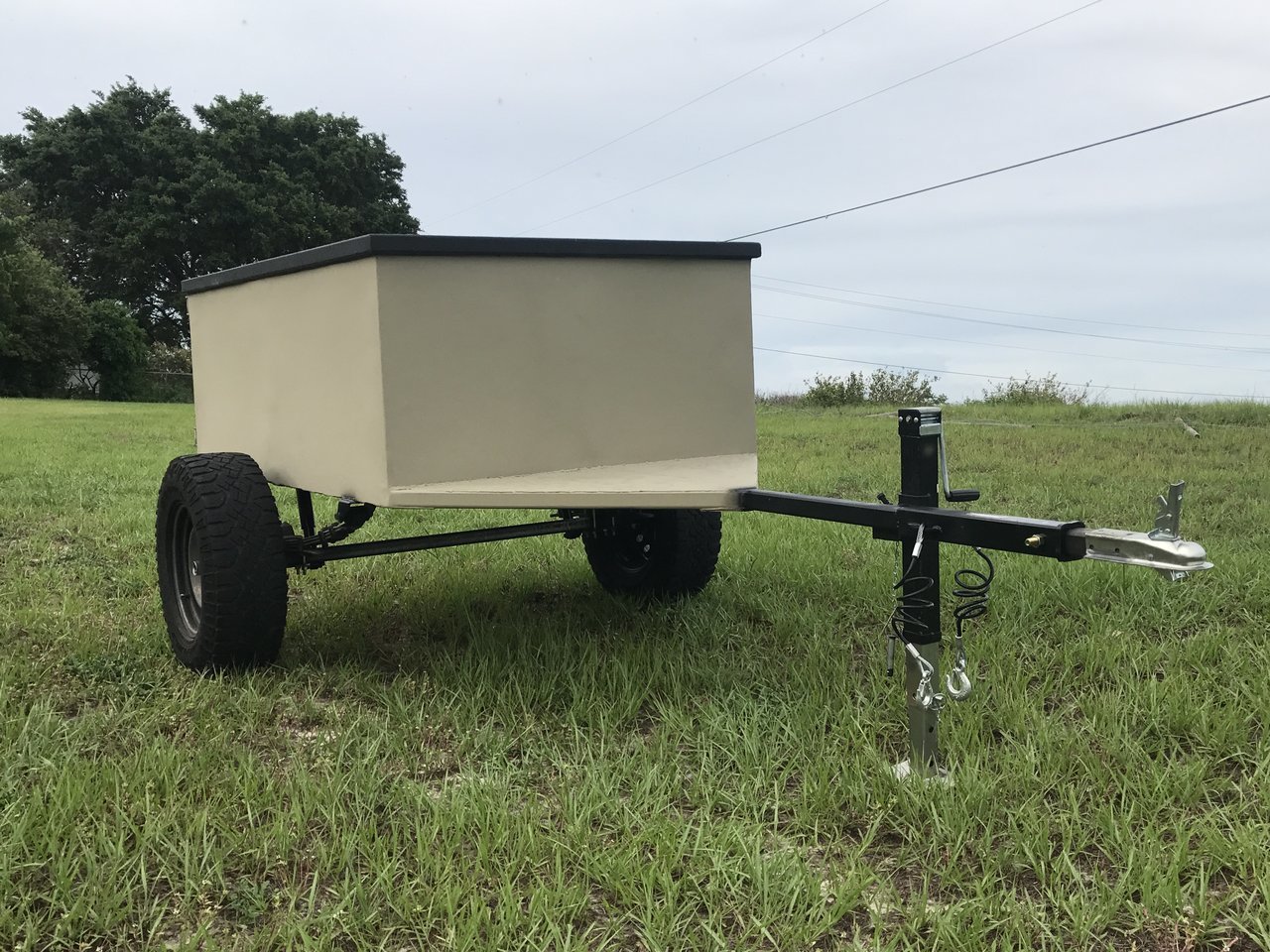

    Little eye candy for now
    Got the maxcoupler in, did a rough coat on the sides. Still have to paint the underside and tape the lines for a clean look. Finish the rear gate and paint the rack.

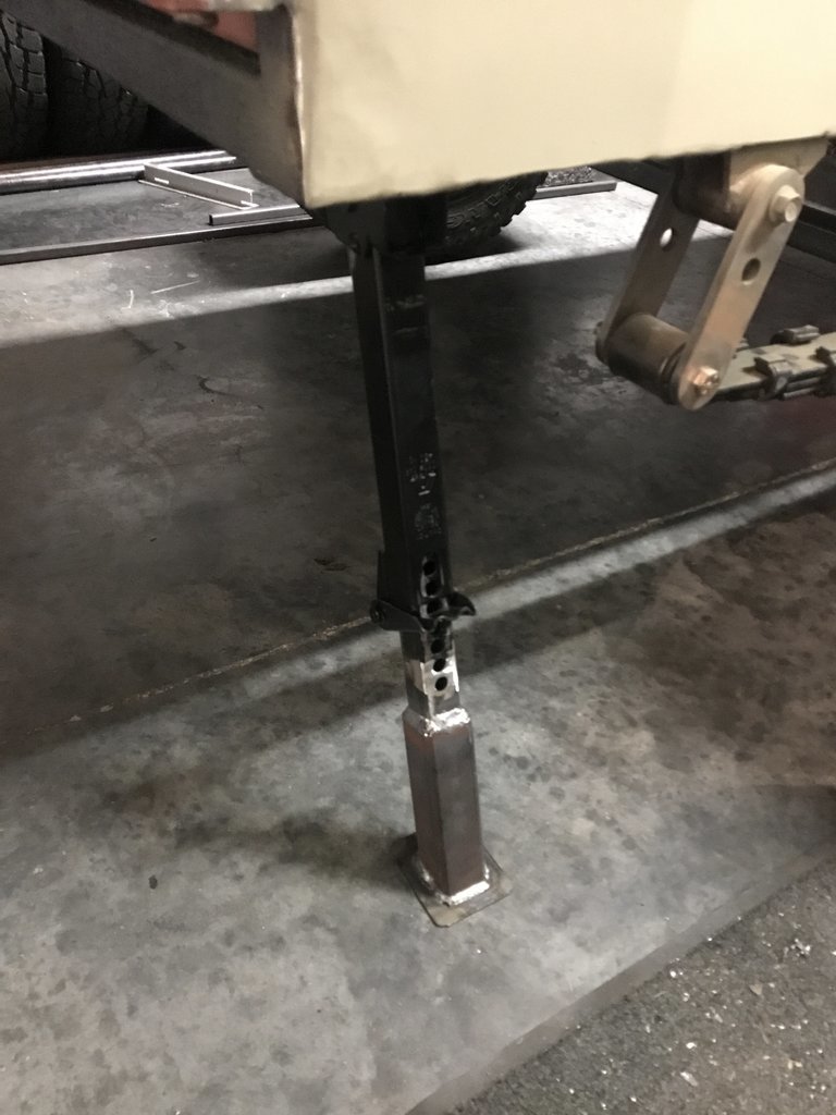

    Local place. Have to buy it by the stick or sheet
    Side note one of the stabilizers was modded for the extra height.

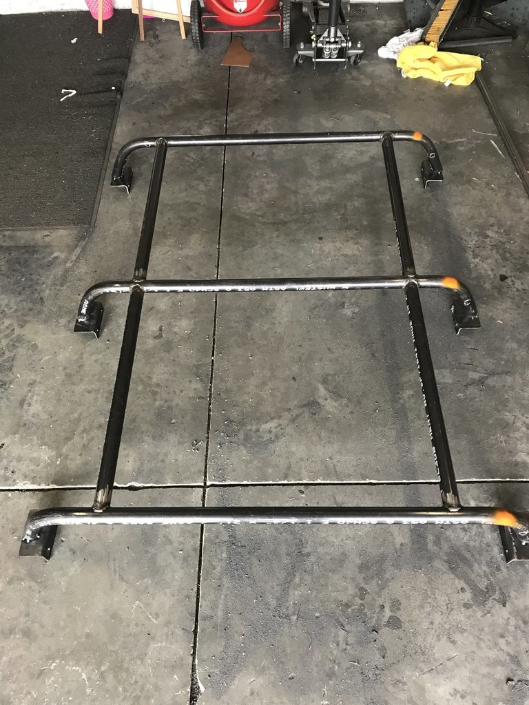

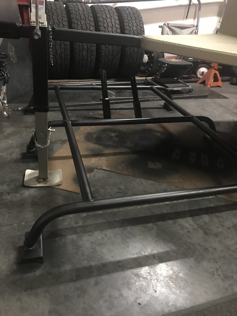

    Both legs are complete and have the rack fully welded up. And coated with flat black.

    Went back a step. Had to bust out the torch and bend the center down. Guess it pulled quite a bit when welding it up. But it's flat and ready to have the legs for the awning welded up.

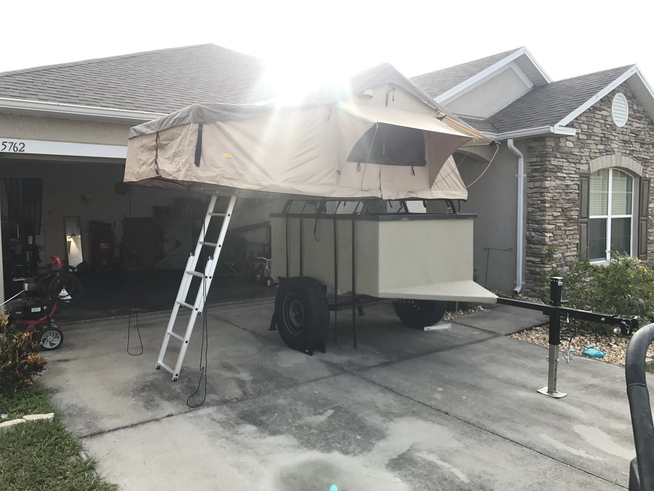

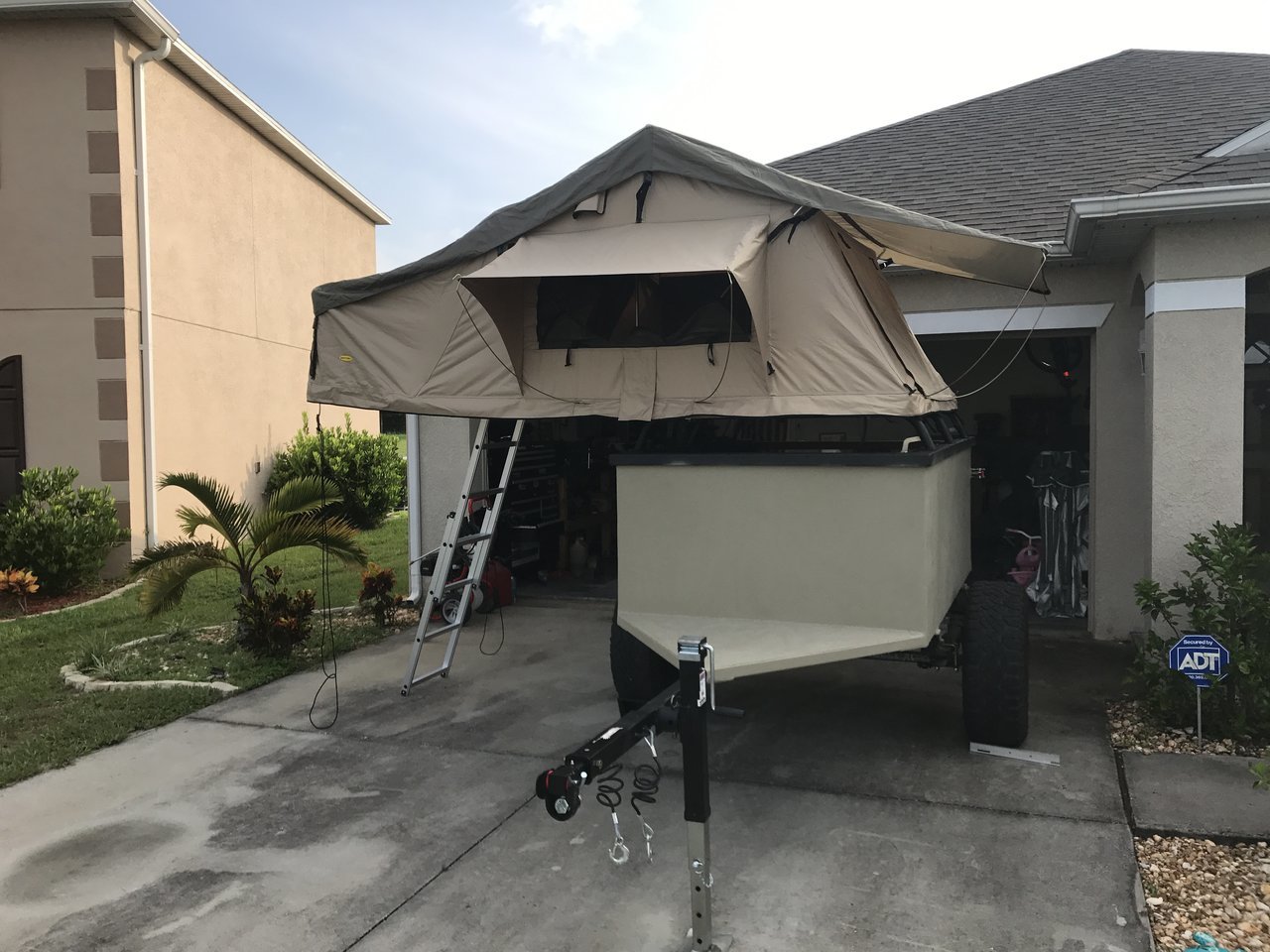

    I'm too impatient. Put the tent on and had to open it up. Stoked on how it's turning out.
