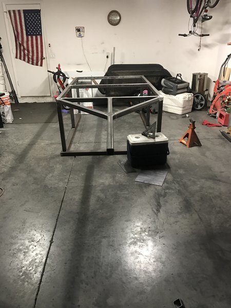

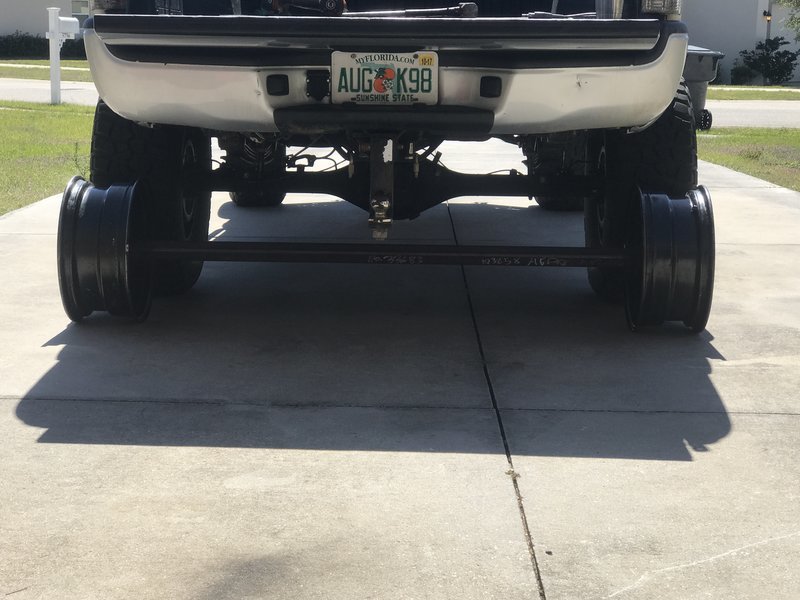

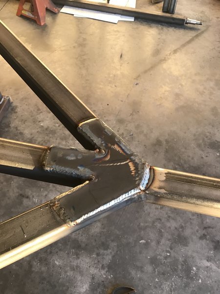

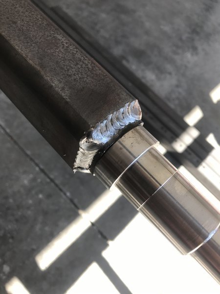

    Few pictures of progress. Axle is 90% done. Need to box in the ends and fish plate the bottom joints, outer frame to tongue braces. Also going to plate where the braces and main tube meet
    Main frame is 1/8. Tongue is 3/16 axle is 1/4 Fish plates will be 3/16.

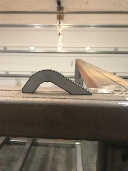

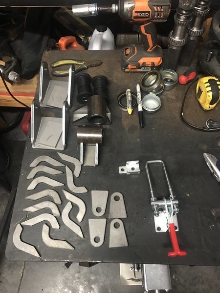

    Some braces for the corners and other parts. Waiting on my guy to be available to meet and get the springs and I can get the axle under it.

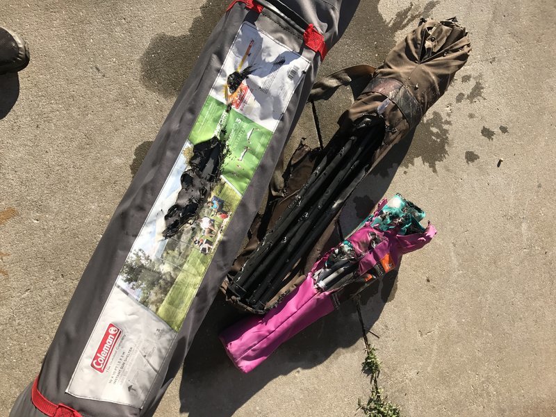

    Make sure you are aware of the surroundings. Sparks can start fires glad I smelled the fire or it could have went a lot worse then this.
