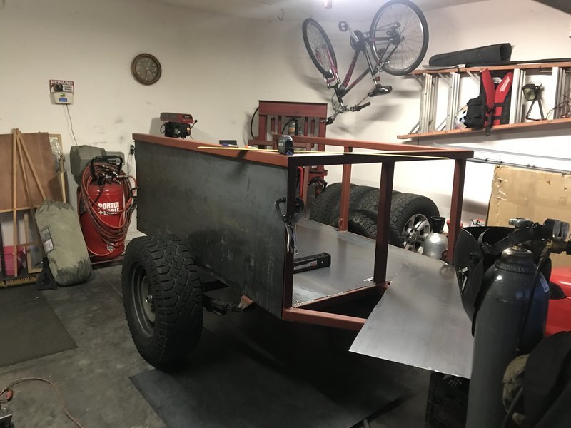

    Little something tonight. Got the other cut now have to figure out how it to make the sheet not do the wave on the top

    I'm thinking some angle. What ya say todd @allenfab

    Not sure I'm following what you're saying. The sheet itself is wavy near the top? The top of the sides?

    Along the bottom it's flat due to the frame. The top is wanting to have a curve. I'm not sure if the 1x1 between the 2x2 will keep it straight.

    Is it starting to wave when your're welding it?

    Is it starting to present a ripple when you weld it? If so that is probably caused by the heat distribution in the metal and the cool down process.

    Try small tacks every 4 inches all the way around, then go back and weld.

    I'm not wanting it to haven't started to weld it up yet

    I would say lots of clamps, and spread your welding out, another thing you could if you have a air compressor is do a 1" stitch weld and immediately cool if with air, I've had good luck doing that when I worked on a chop top of a 50' Ford.

    I'll post a picture later lol
