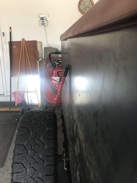

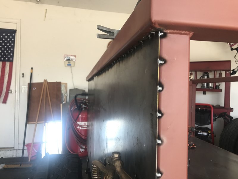

    What I'm talking about.

    Is there tube behind the area that is starting to wave?

    No. I did how ever take some 1x1 and clamp it to the top rail so I can get the wave out a little

    :notsure:It looks like heat from the welds is causing it to warp. I would recommend a small diameter wire so it uses less heat to melt in return reduce the temp. in the sheet metal to cause warping. I think that might aid in process.

    It looked like that before I tacked anything in. Only on the top everything else is good it don't have anything to rest on up top.
    It's 16ga

    16ga what size wire .030"? The sheet metal had a wave in it before you tacked it at all?

    I use only .035 and yes it was like this just clamped in place

    It's need laying flat in the garage since I got it. I'll try and lignite up the beat I can and give that a go
