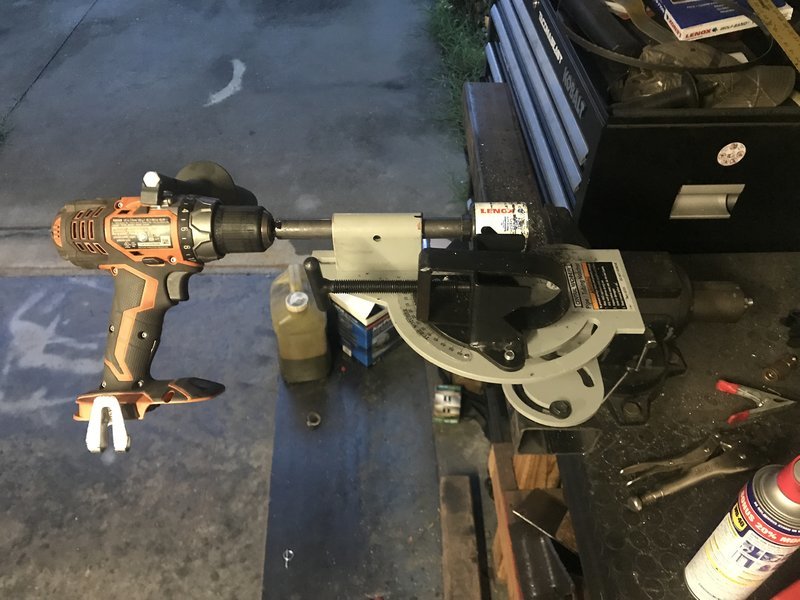

    Not bad for a $42 notcher it needs shimmed but this will do.

    Info in notcher? Harbor Freight?

    Yes harbor freight. Pipe is sch40 1.25. Hole saw blade is 1.75
