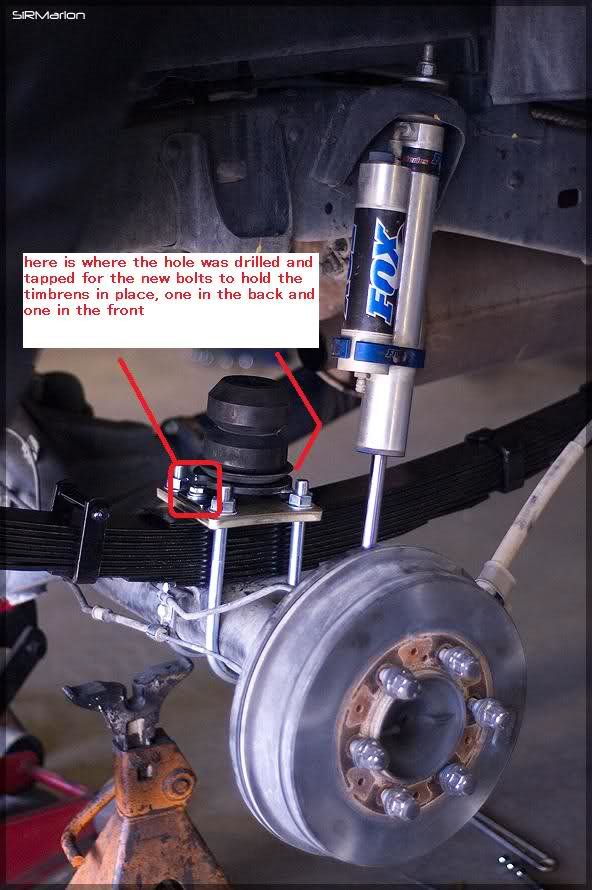

    haven't read all the replies, but I had to weld my bumpstops on the top of my allpro plates.
    allpro was supposed to offer a flip kit that incorporated the timbrens.. they might have decided to continue their LT/desert route and dropped the project?

    yea not sure if you've got it figured out. i did the flip kit but retained the factory bumpstops.. i just tack welded the bumpstocks to the top of the ubolt plate.. works like a charm and was super simple.
    as far as installing them. you can do it without jacking the truck up but MAKE SURE YOUR ON LEVEL GROUND AND BLOCK THE FRONT TIRES SO IT CANT MOVE!!!!! then you should be able to just pull the stock hardware off and bolt on the new stuff since your not doing leafs right now.

    nah, I just got the new kit from AP. Ubolt flip with tapped and threaded plates for the Timbrens..they bolt up like a charm!

    Wow those Timbren's look extreme small... I thought they would be bigger then that.... I thought they would be some what the same size as an air bag setup.

    how can a rubber stumper baby bumper bump stop be compared to an air bag!? :p

    Other pic's I've seen make them look bigger then that...

    they are taller then the stock bump stops with a softer compound to help reduce the effects of a harsh bottom out

    Well that sucks, I was kinda hoping that they would be a little bigger then that.. Everything else I have seem they are bigger, but your pic tells the truth. I would have got them instead of gettin rear ride rite bags since the timbrens have lifetime warranty and need no maintaince. As well the timbrens are cheaper..

    you can contact customer support at Timbren, tell em what you need/expect from a bump stop and they can set you up with something taller/beefier and with different compounds. their customer service is great i hear..
    what All Pro offers suits it's purpose just fine for the average Joe, but if you are looking for something for more of a load carrying bump stop then defiantly contact Timbren
