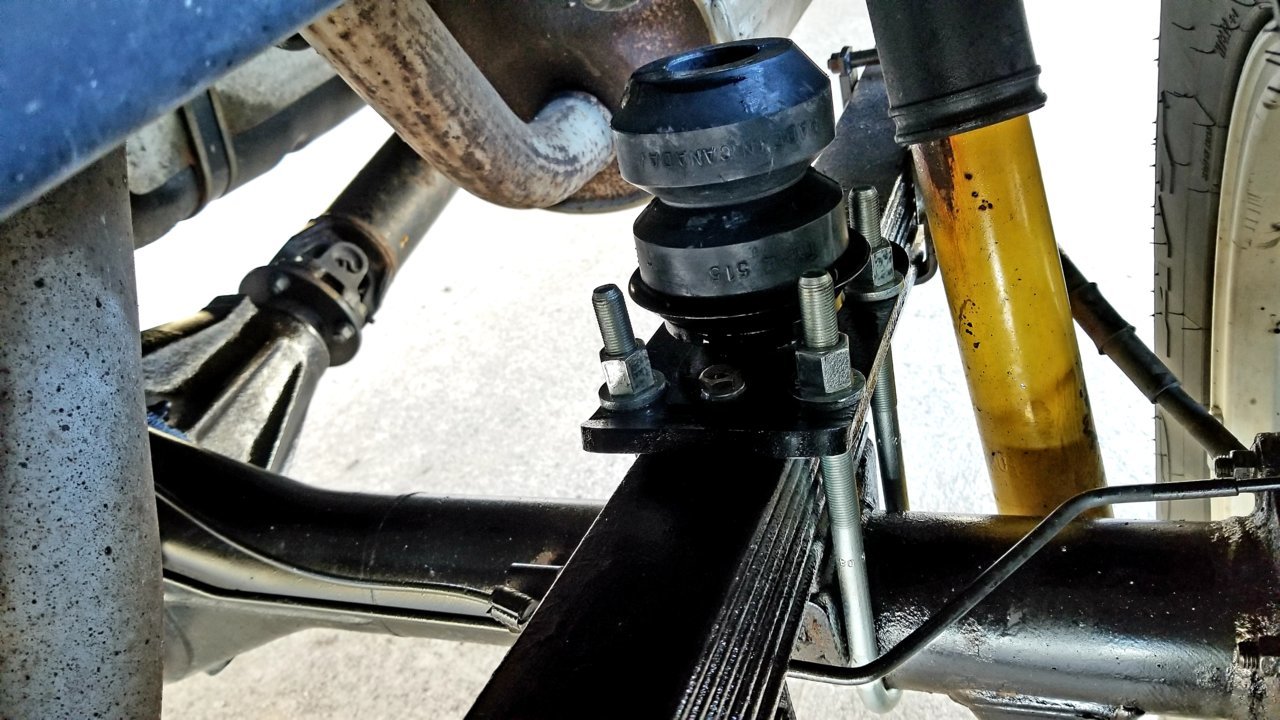

    20190121_172602.jpg I have them, they work well. Only problem I have is they fill with water and mud... not really a problem, more of a gripe. But otherwise a solid investment.

    I've heard that when they fill with water or mud they make a farting sound when hit. I've got superbumps so I don't have first hand knowledge of timbrens

    Superbumps, Durobumps and Timbrens all have a void in the middle of them so they will fill up with dirt and water, just the nature of the design.
    My truck makes a lot of noises but I can't say farting is one of them haha

    Durobump rears don't have holes and the fronts will face downward so that should help with getting filled up with gunk.

    Ah I was thinking of my 1st gen fronts, mine are on the bottom of the LCA so they face upward

    Great shot! Thanks for sharing

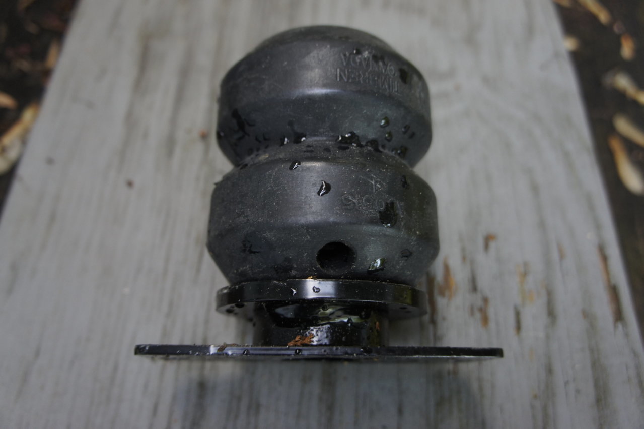

    My guess the Timbrens were originally designed to hang top down from the frame. Then were repurposed for other trucks. I cut a 1/4 hole in the base to let water drain.
