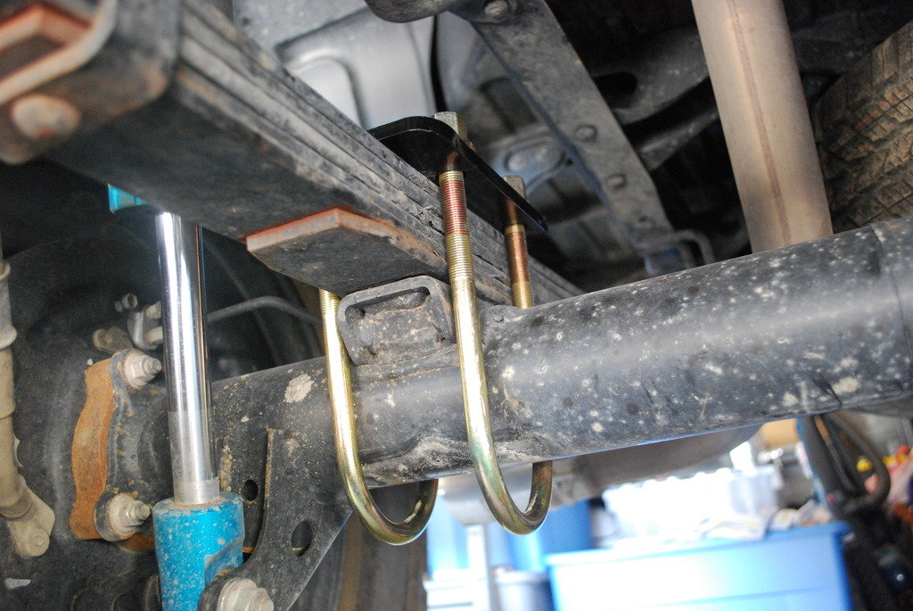

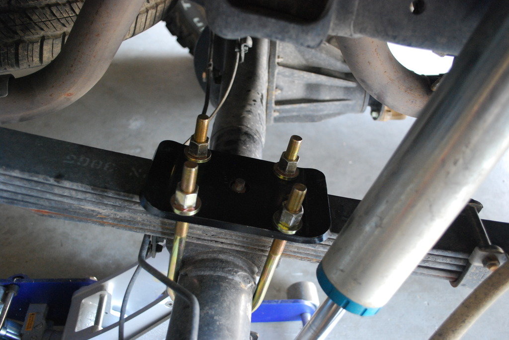

    Just to add some intel; on a 2017 the factory nuts on the U-bolts are also 19mm so you really only need the one deep socket if that is your vehicle. Also, the rear Timbrens procedure can be done with the wheels still on, it just means working in a tighter swing space with ratchet and torque wrench. I just jacked up my frame enough to unload the spring for vertical working space and left the tire in contact with the ground so my axle would not move during the process. Just a slightly different way of doing it. Took roughly one hour total time.

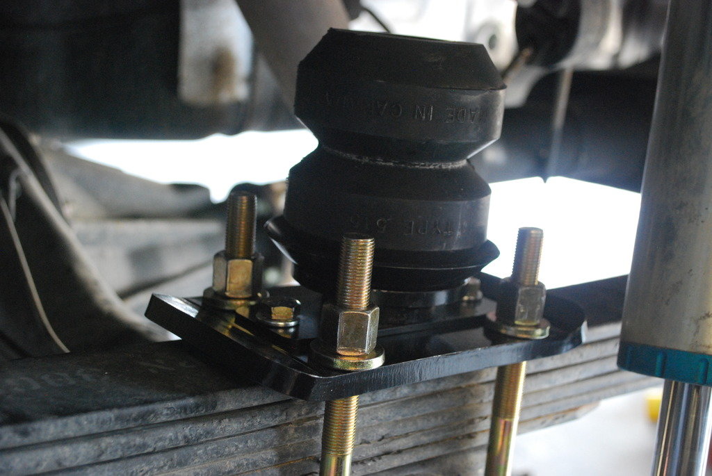

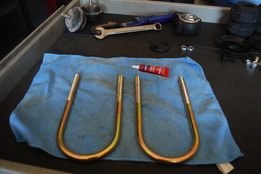

    Thanks for the step by step install. I'm a huge Timbren fan, got them (rear only) on our Honda Pilot and our e350 based RV. Our Tacoma will get them too. I did notice that the rear U bolts are a bit long...i think I would trim the extra...once again nice writeup!

    thanks for the kind words, as far as the u bolt length I was getting an expedition leaf pack which now o have zero threads showing so if I were keeping those pictured I would have definitely trimmed them down.
