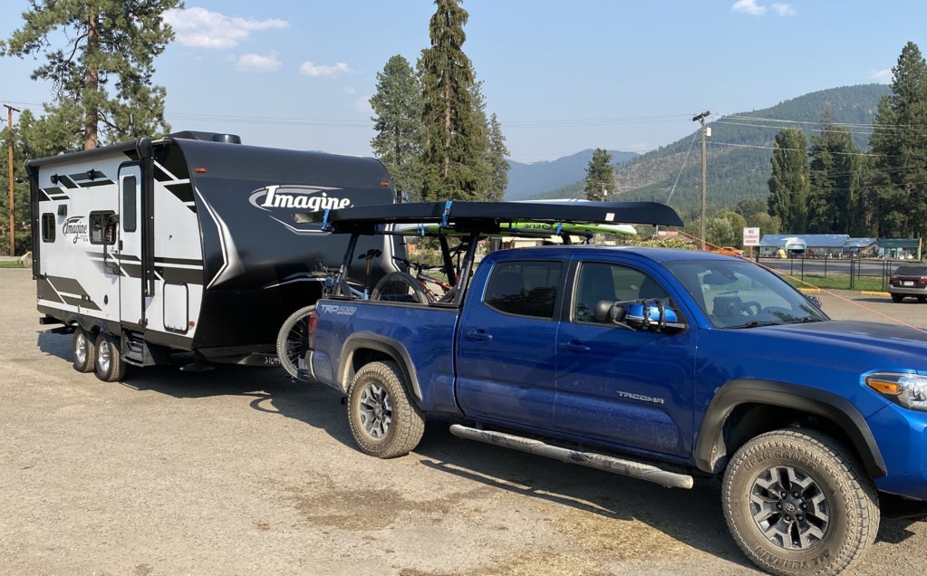

    IMG_4638.jpg My trailer is about 5100 loaded for camping. I use Roadmaster active suspension. Works great no temperature issues and no real maintenance other than a car wash. Have DCLB.
    49ersPaul likes this.
