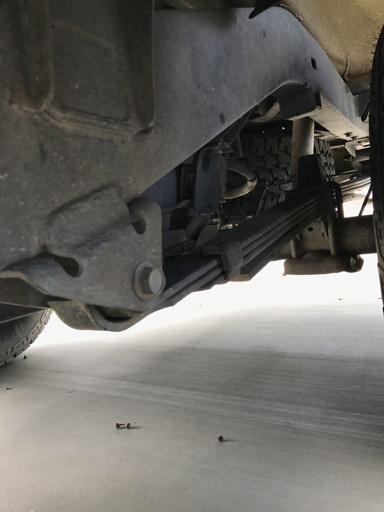

    Hey guys, just got a camper shell for my truck.. was wondering if it's time for new leaf springs...IMG_0289.jpg

    yes, and if you carry the shell more often than not, get some HD springs. the extra weight will flatten out the new ones easier/sooner

    I think 5 years ago was time for new springs :)
    What kind are you looking to buy - any ideas?

    I actually just bought the wheeler's four pack, got new u bolts and shackles. I was thinking of going ome, but i'm not looking for any lift!

    You have a first gen with original springs? Then the answer is yes.
    But yeah, especially when you add more weight to high mileage springs, you gots ta get new springs. There are lots of options for aftermarket sorings, but old man emu are probably the best that won't break the bank. Iirc about $350 afor a set. Not sure if they have them in a stock height, tho...
    You *could* get an add-a-leaf, but putting those on worn out springs is not the best.
    Ready_already[OP] likes this.

    my leaf springs look very close to these as well but a tad more straight. its an 02 , so these springs should be replaced?? I dont haul anything by the way. Nothing big so far.

    no, i still get full flex (whatever that means with stock suspension lol) I do have a cap, drawers, prinsu rack and CVT awning weighing about 300lbs total at all times

    For the parts it was 750 with shipping.. new leaf springs, new u bolts, new shackles, new springs
