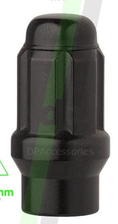

    So while rotating my tires to my 2013 Tacoma my lug nuts are getting pretty rounded so it is probably time to change them out. I am a huge believer in getting something that is nicer that will last longer so I am shopping around. As of right now I have stock wheels but I am eyeballing SCS Ray10s and want to make sure they work with my current set up and future set up. What is everyone running and are splined lug nuts worth it?

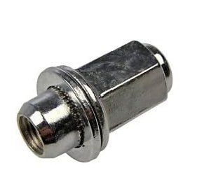

    Your not going to be able to use them with your new aftermarket wheels, IE & aftermarket use two different styles of lug nuts :
    OE flat flange ET ( extended thread ) style lug nut
    Aftermarket wheels use conical ET lug nuts

    +1 for what Evenflow said above. If you are going to buy the SCS wheels you should also buy the conical extended lugs from them too and make it easy on yourself (source: I have SCS wheels). Stock lugs wont work with the SCS wheels, aftermarket conical lugs won't work with stock wheels.
