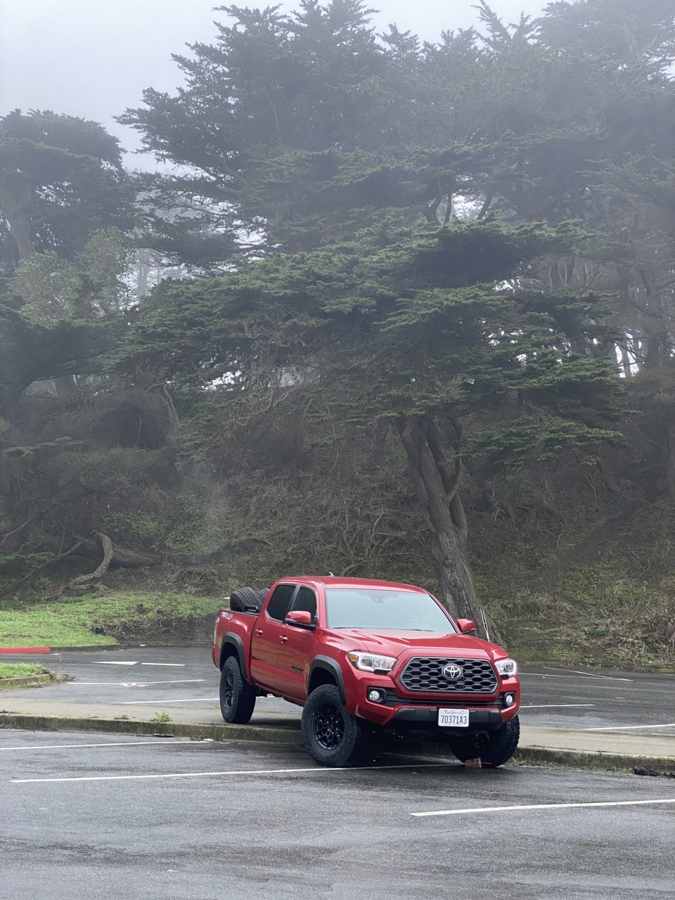

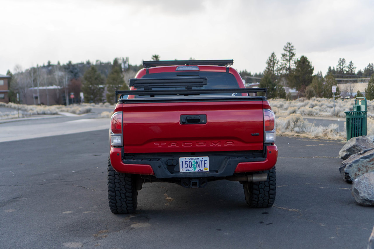

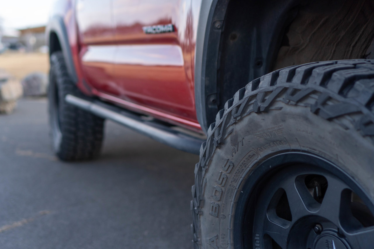

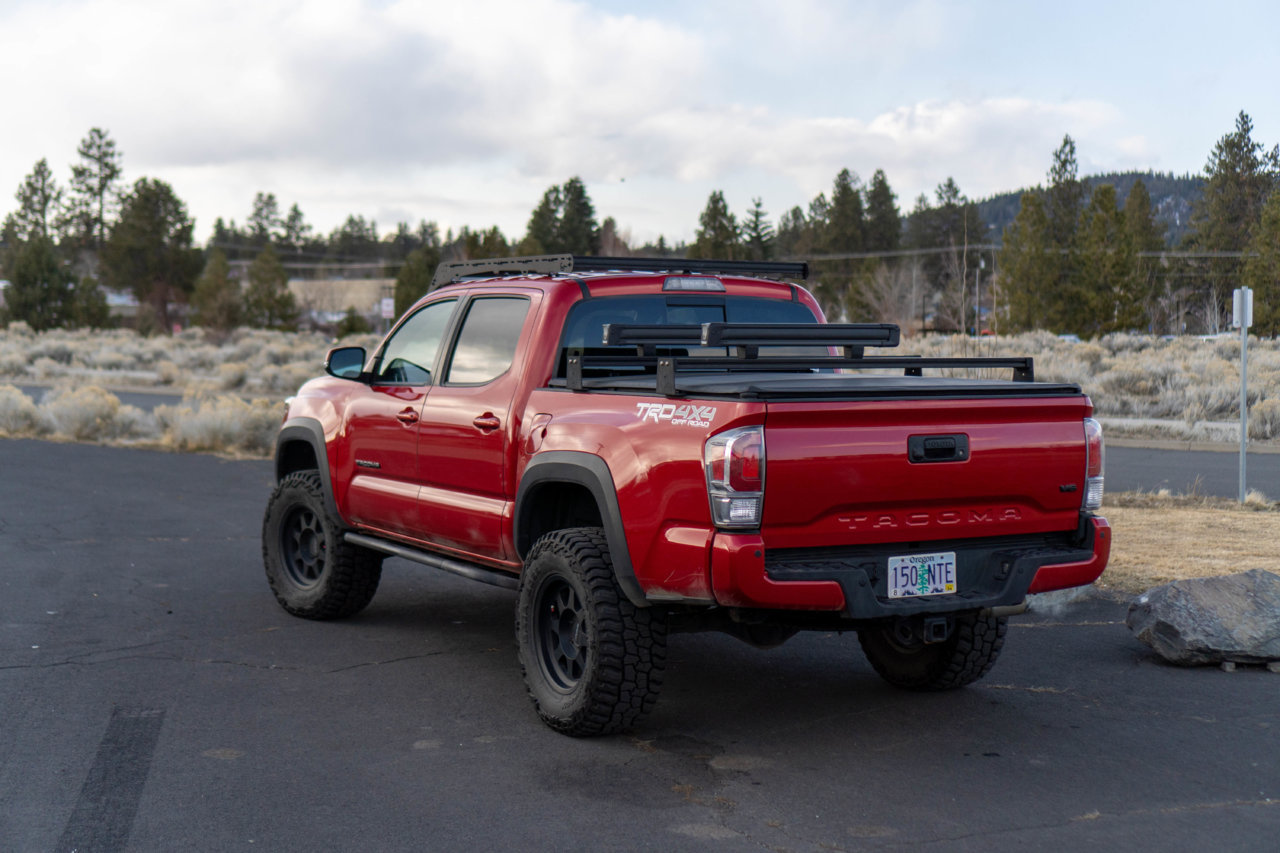

    I've initially upgraded to the OEM trd pro 16" wheels on Falcon Wildpeaks - that was a great setup - I'd do it again. As I added weight the wildpeaks proved too soft on the sidewall (they have a heavier weight rating, which should help). I also wanted a light offset (to have the stance widen a bit. The factory wheels have a +11mm offset which means they bring the tires IN about a half inch. I went with a wider rim 8" vs (the stock 7") and a 0mm offset which in total moved my outer side walls out by almost 2". Here's what it looks like (hope it helps):
    and with the wildpeaks on stock trd pro wheels:

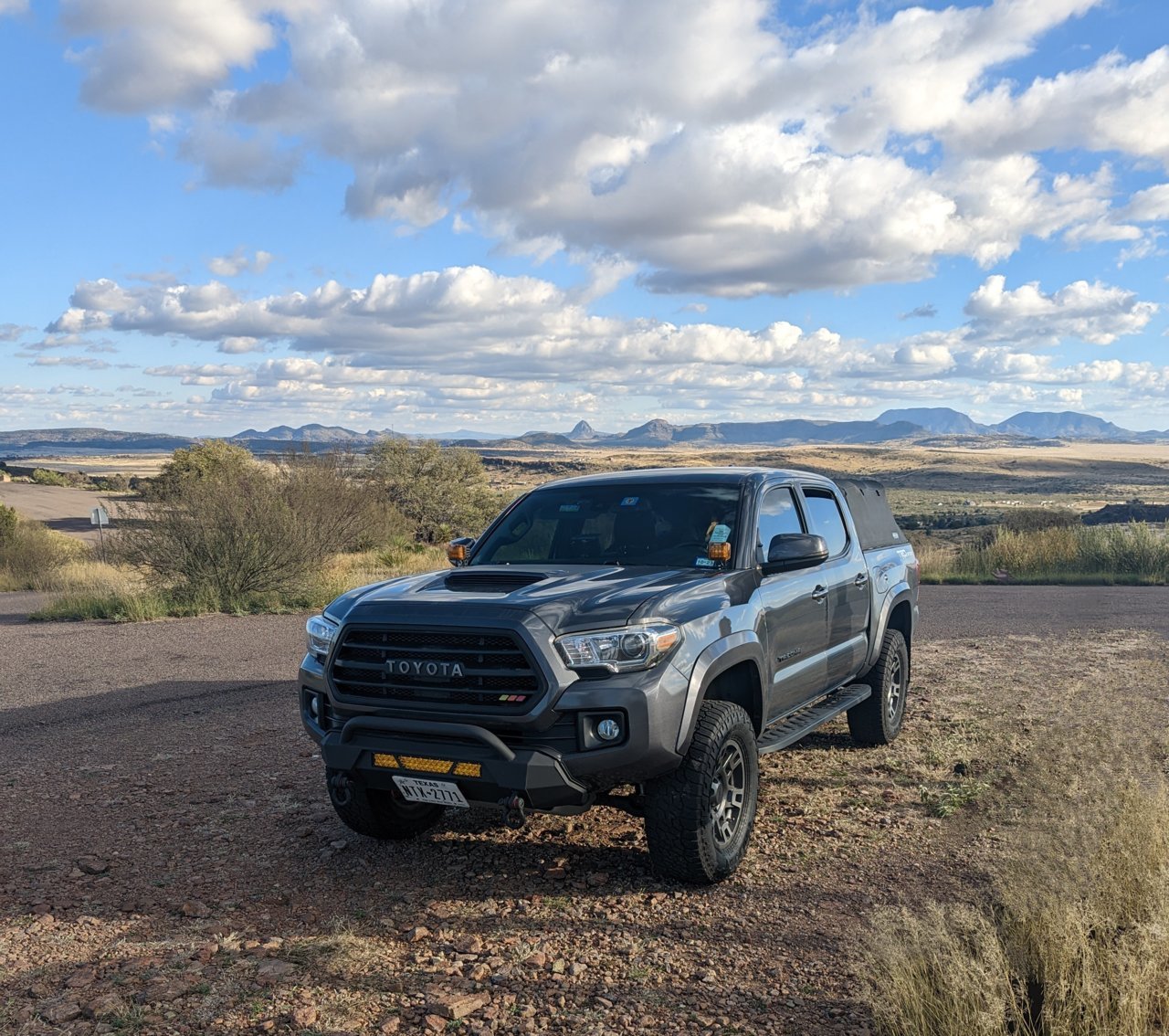

    I went 1 size taller on my truck when the OEM Goodyear's gave up. I currently run these Cooper ST Maxx on my OEM rims. I got them at tirerack.com and had them installed by a local tire shop.
