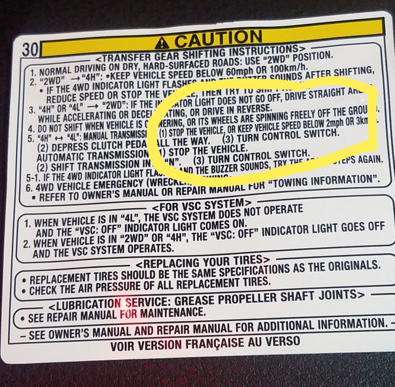

    Yikes..... I didn't wanna give bad info. Went and checked. You were right, it is on the visor card. Didn't realize there would be a difference between the AT/MT for this function.
    Thanks for pointing it out
